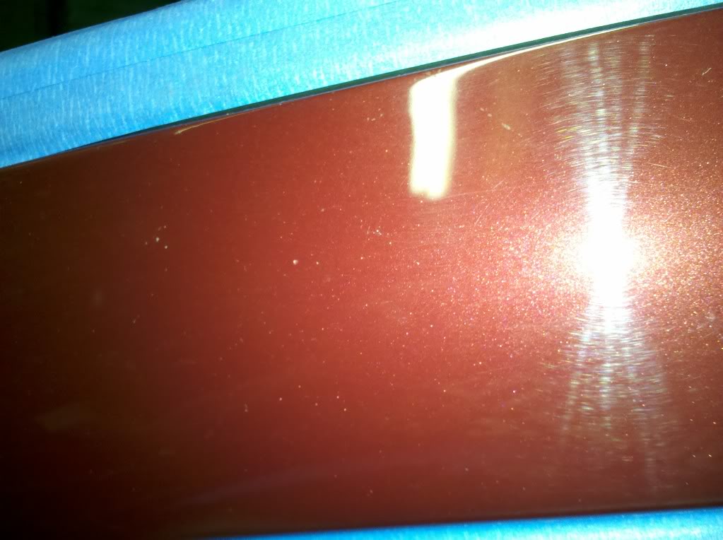

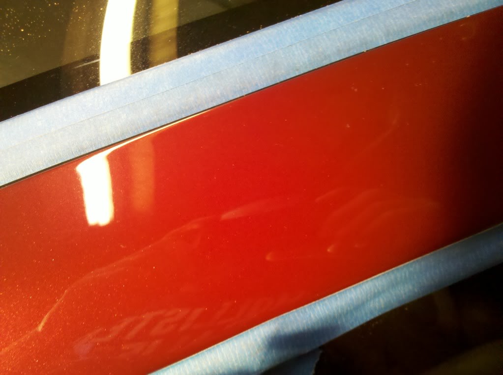

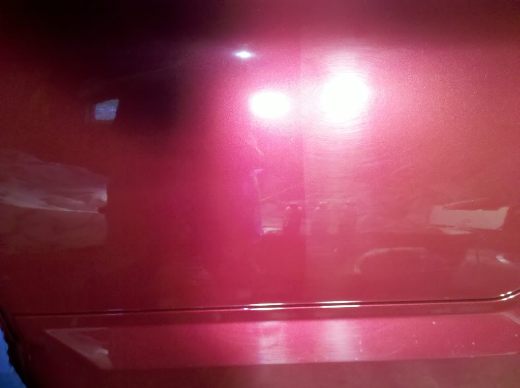

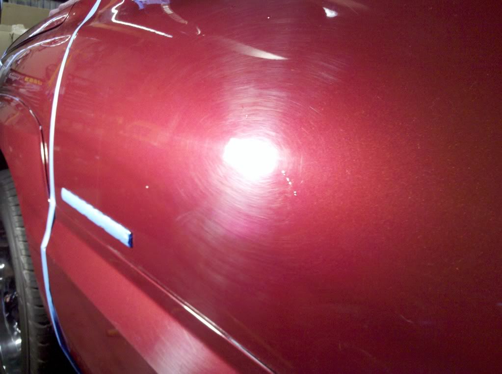

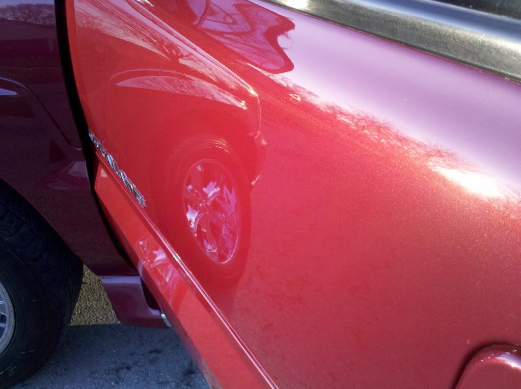

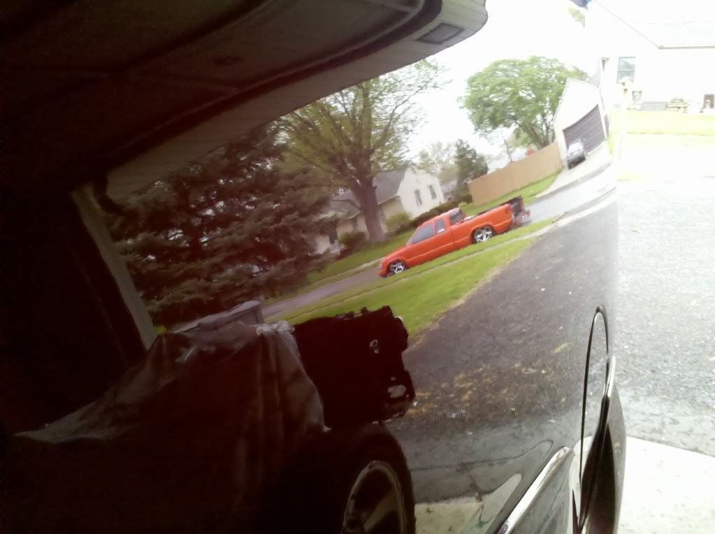

Well started buffing the truck so far got the hood, lf fender and driver side door done. No pics of the hood or fender as i did those a couple weeks ago, but heres some befores/afters of the door. I use all Adams products. First started off washing the truck, then clayed using Adams clay bar and Adams detail spray. Then using a porter cable 7424xp with Adams Orange pad and Adams swirl and haze remover, then to Adams white pad with Adams fine machine polish, finished off by Adams black pad and Adams super machine wax the trucks finish is scary but after is pretty damn clear ill let the pics talk lol
Before:
After:

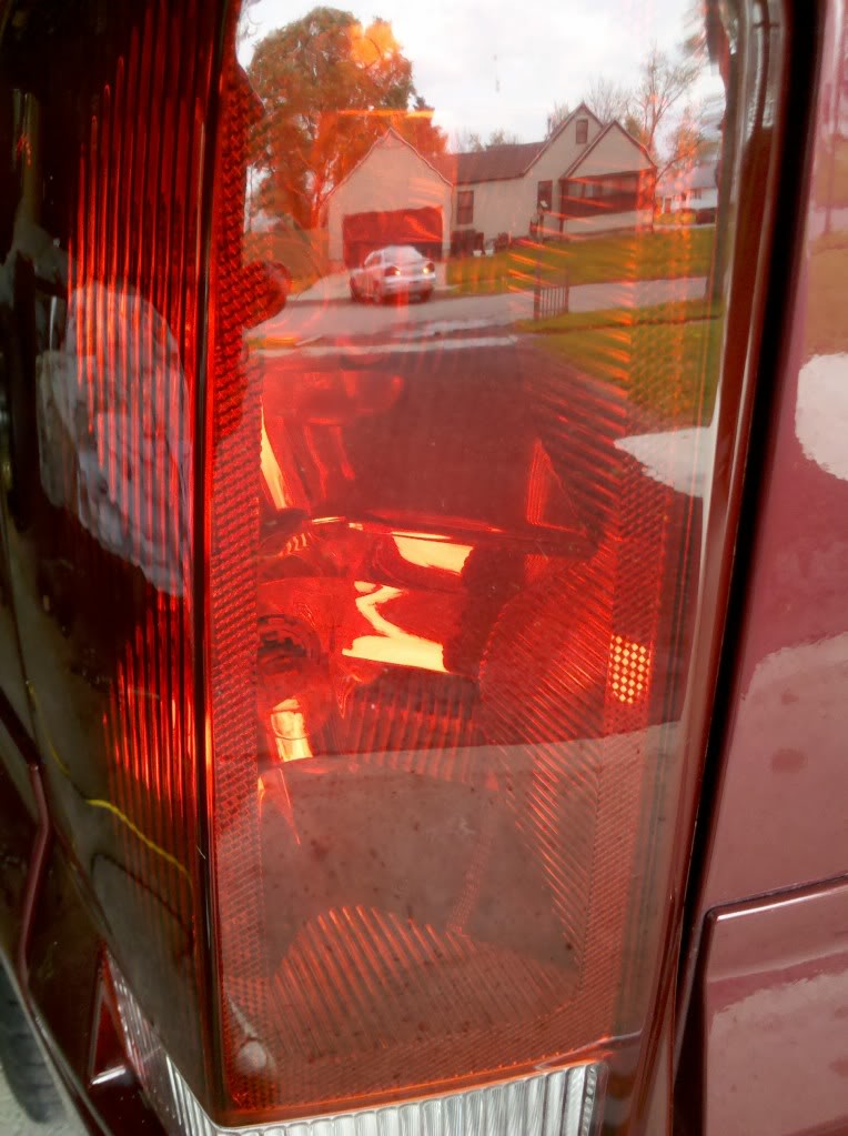

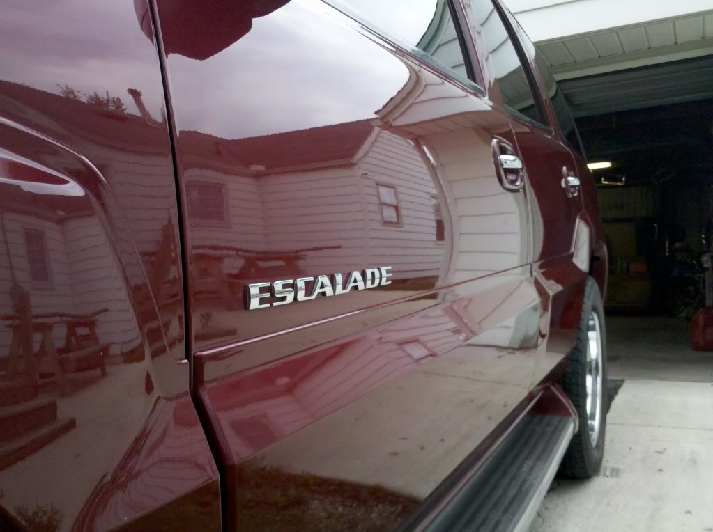

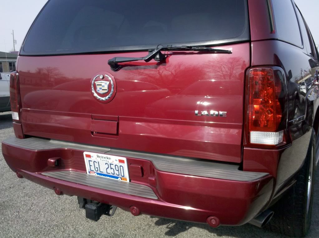

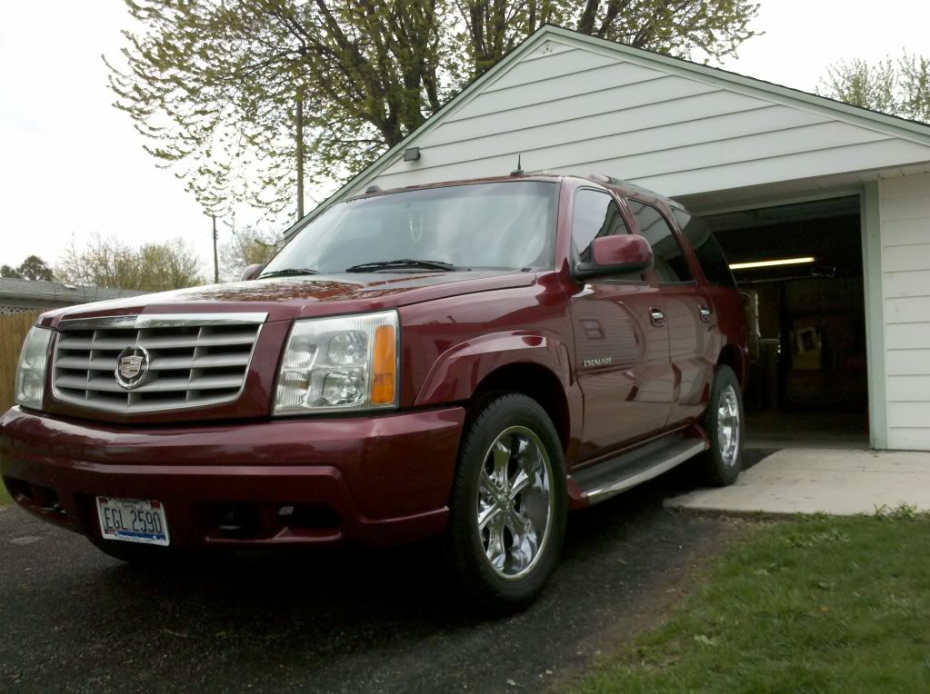

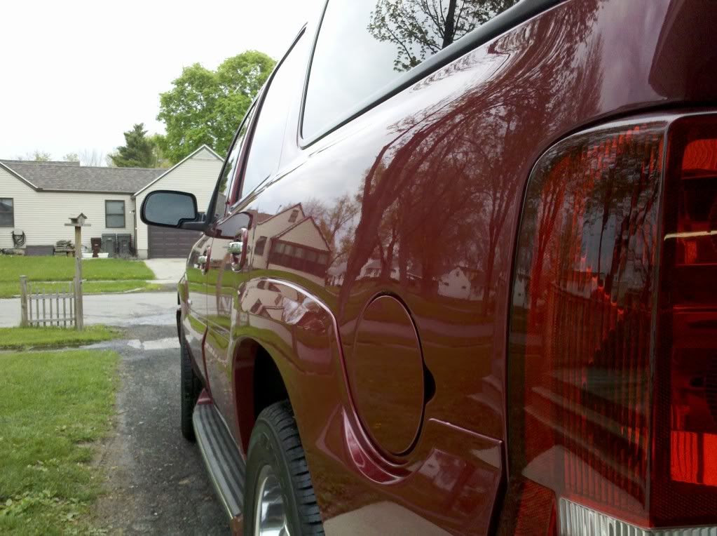

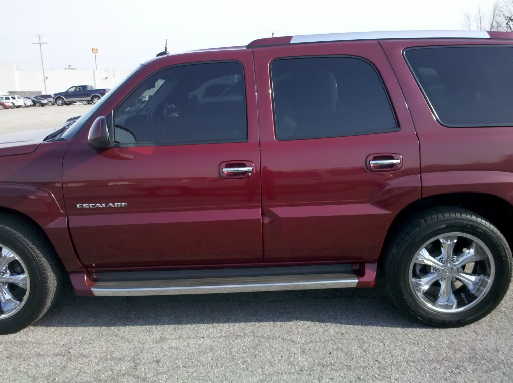

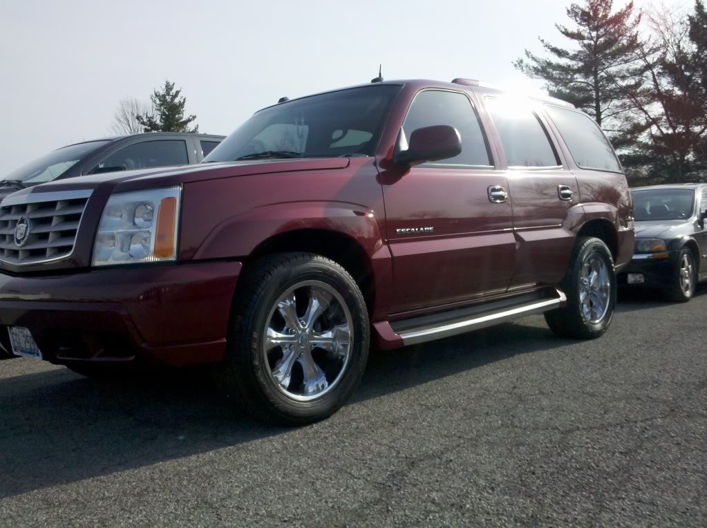

Its coming along only have time to do a panel at a time pretty busy lol. But here are some full views havent had a chance to do anymore since the drivers door but from standing back she looks pretty good lol
old pic before any buffing

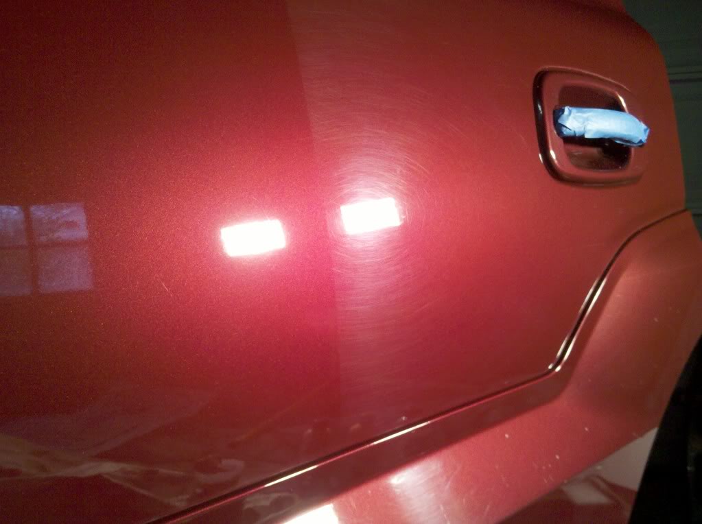

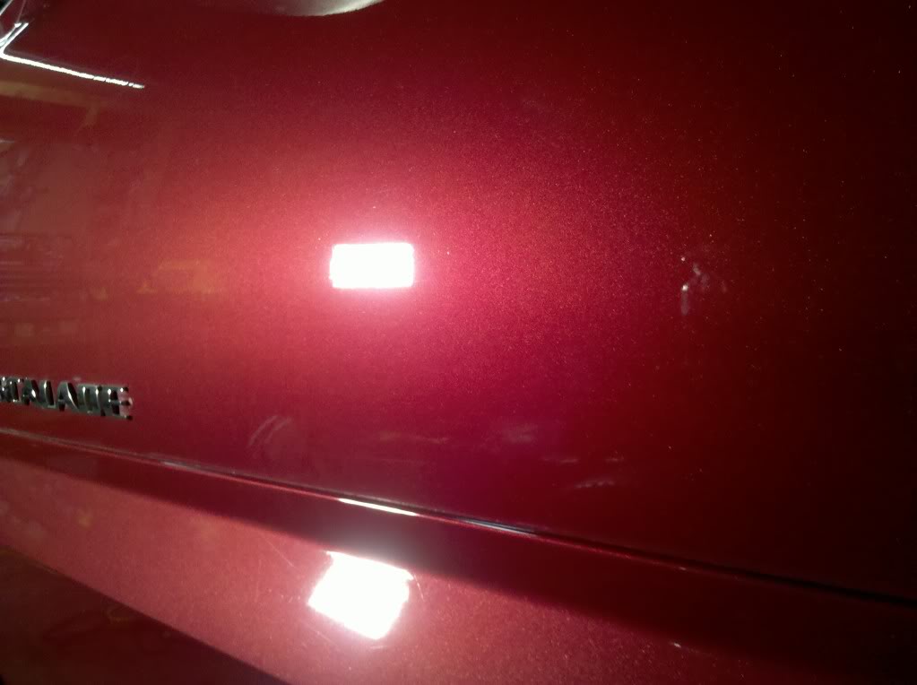

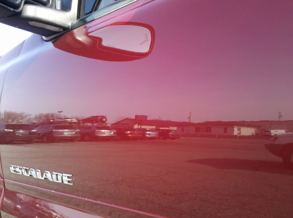

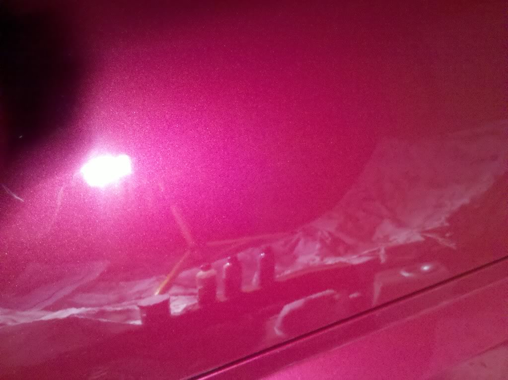

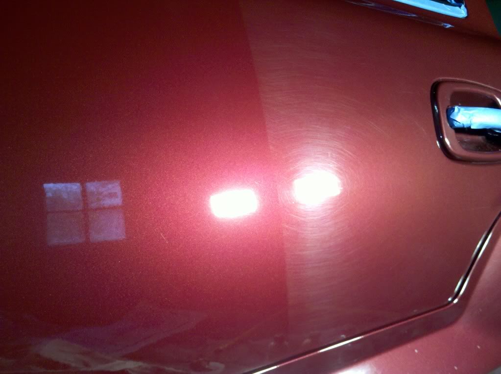

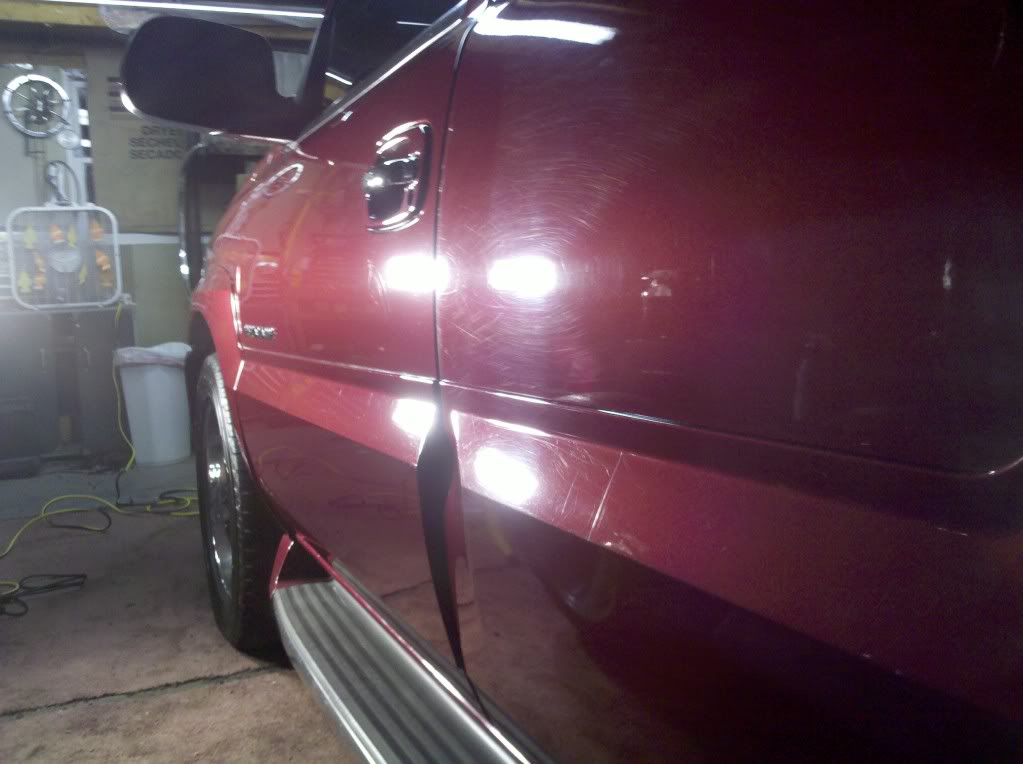

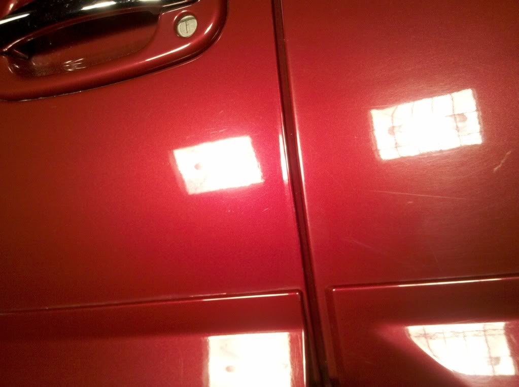

worked on the inside all week now that its done (havent taken pics yet) i can resume work on the outside. got the driver back door done so the left side of the truck is 3/4 the way done lmao heres some pics id say its about 90-95% corrected on the panels ive done so far not tryin for super perfect but close. I really need to get my hands on Adams Green pad and severe swirl n haze remover so i could get it a lil more perfect in less time since the finish is so horrible.
50/50 dosnt have wax on it yet either in these shots
and done with wax

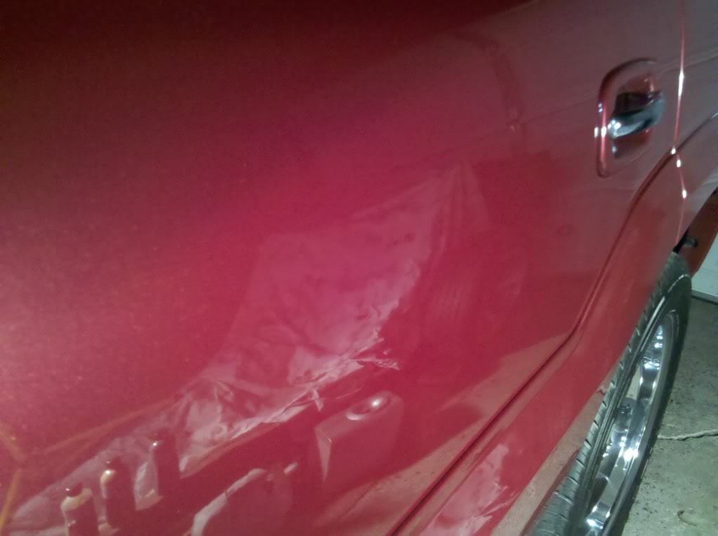

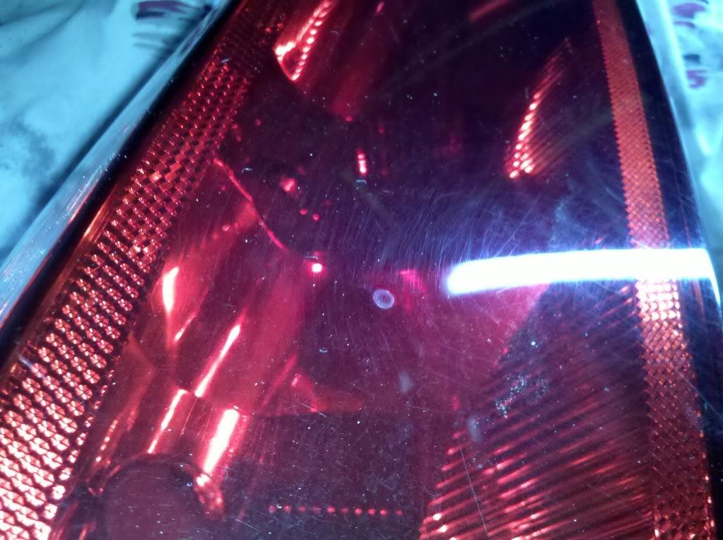

ok Left side is finally done. Didn't touch the bumpers or roof yet and still have to do the whole other side. It came out way better than i thought it would. All the little spiderweb brush marks are gone, theres still some deeper scratches but id say its about 85-90% corrected. heres some pics
