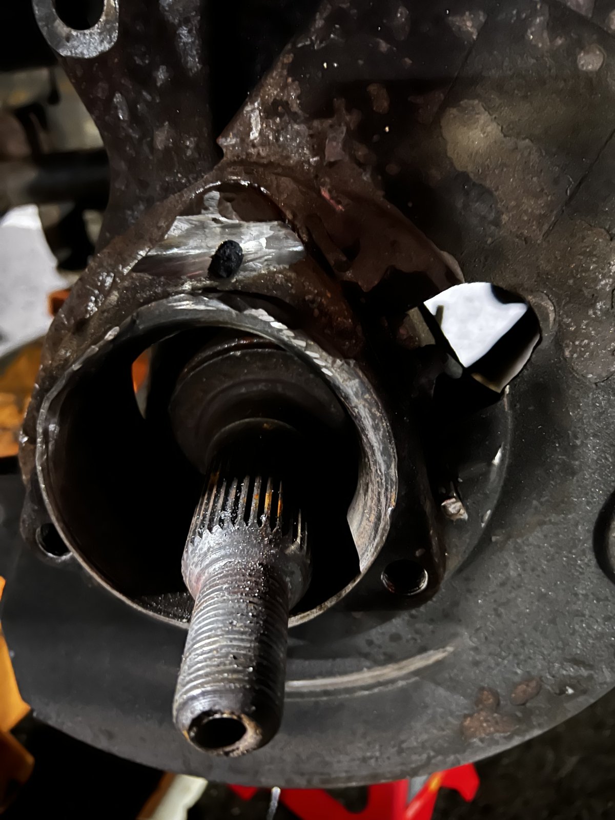

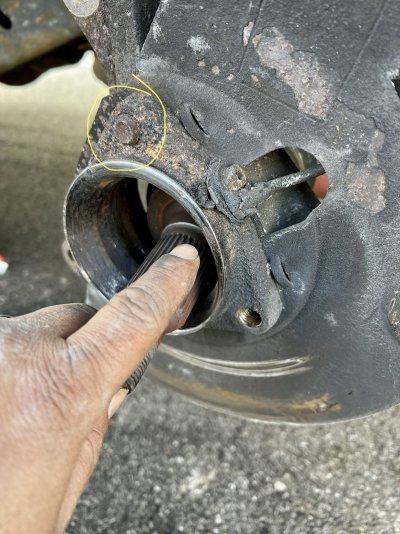

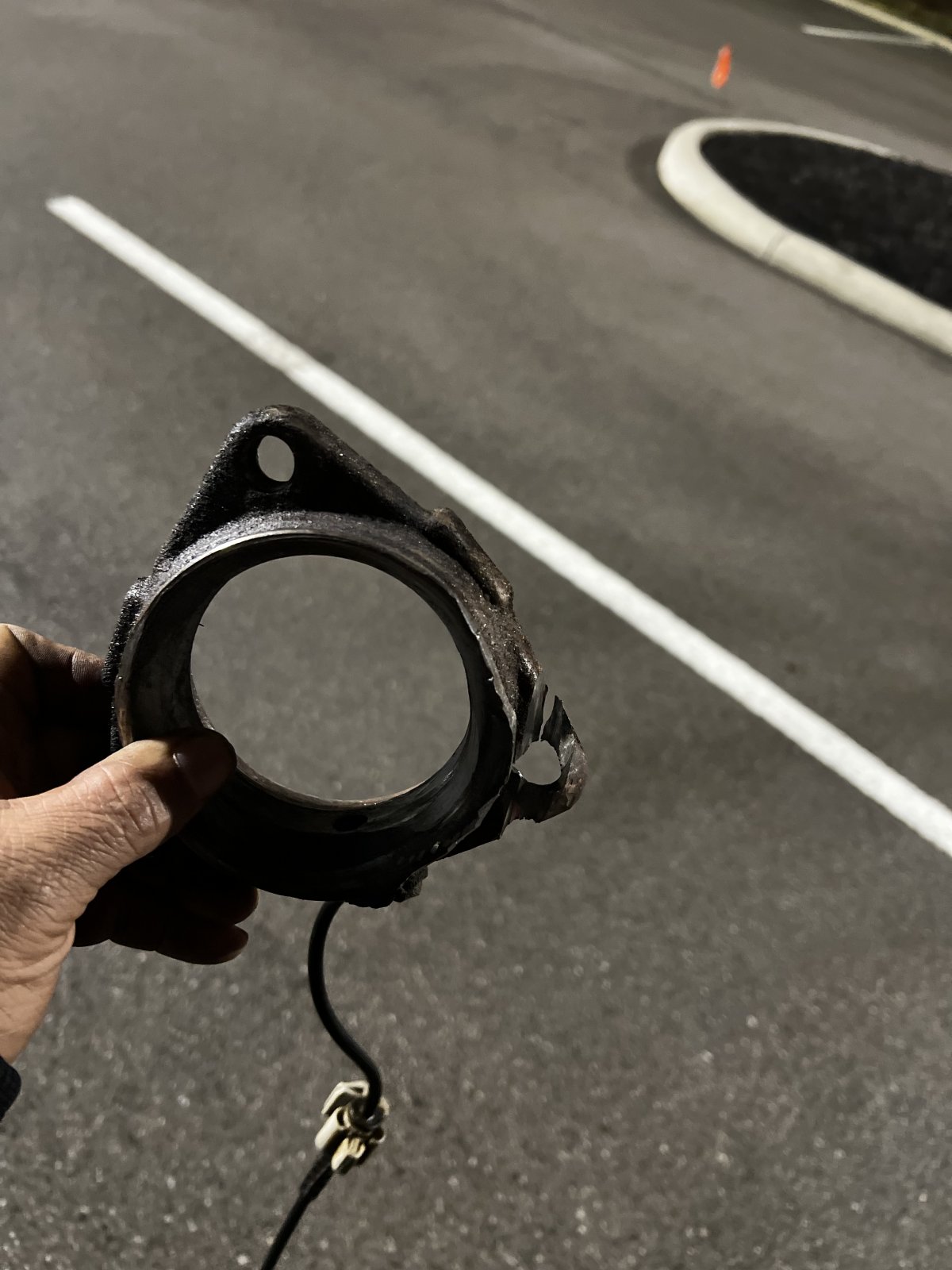

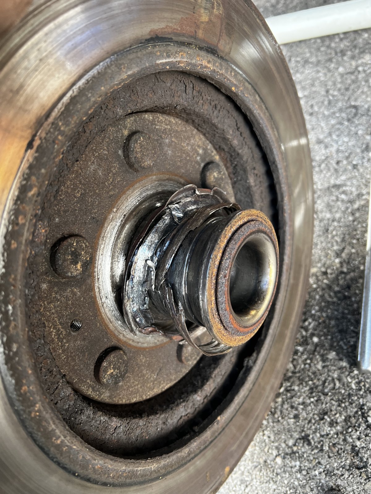

Sorry for the extreme delay. Was the right front wheel bearing. On my way to work on Xmas eve night it finally gave out I live about 60mi north of my work. And it blew out about 15mi from my job. I was able to limp it to work, and ended up repairing it in the parking lot. Had to cut the old bearing off the knuckle. The caliper was also destroyed. But the axle shaft survived somehow. Both shafts will get replaced this spring when I replace the upper and lower a arms, and shocks.

I can't believe that wasn't making a ton of noise before it got that bad. Wow! Makes me want to go out and check for bearing wobble.
10,322
14,951
Thank you for posting the resolution to your issue. Our collective knowledge base has been increased.
