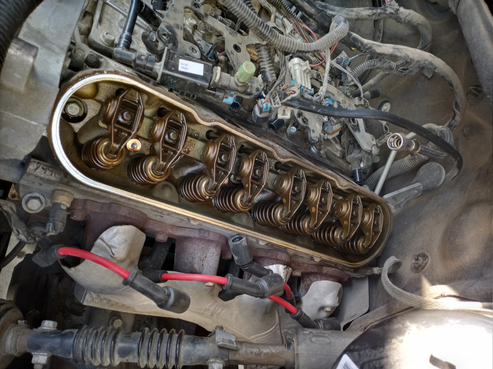

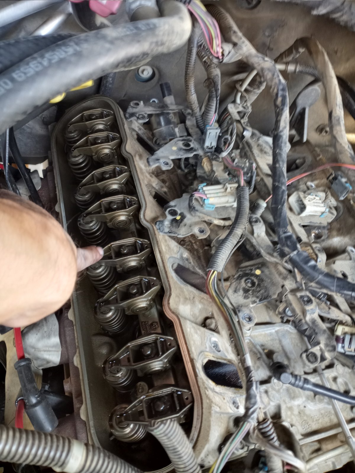

Quick update guys and thanks for the replies.
I pulled intake manifold, and valve covers. Driver side rocker arms and rods look good all intact.
Passenger side I have one loose rocker arm above cylinder 4 where I was getting a misfire.
First pic is drive side and second is passenger. My finger is where the loose rocker arm is at.
Being as far in the tear down should I opt for the AFM DOD delete? Or replace rockers and rods?
Side note: I was having oil pressure issues before this happened. What replacement route to fix that issue? New pump or just the oil sending sensor deal in the back of the manifold?

Since the intake manifold is off, check the VLOM bolts to make sure they're tight. It's also a good time to replace that oil pressure sensor and clean or replace the screen under it. The sensor may not be bad, but it's really hard to access with the manifold in place. A loose VLOM can cause low oil pressure and a failed AFM lifter. A leaky O-ring is another common cause for low oil pressure, but you can't check that unless the engine is running.
As far as the rocker, you gotta determine why it's loose. Is the pivot bolt loose? Is it slack between it and the push rod (collapsed lifter)? If a collapsed lifter, and since the the VLOM is accessible/removable, you can try this trick:
Try to see if that lifter isn't turned and if the cam lobe is ok. If so proceed with trying to unstick the lifter. If that fixes that, disable AFM ASAP! You can get it disabled in a tune for $50 plus the shipping of your PCM.
You're really not that far into an AFM delete. If I had to put a number on it, I'd say you're around 15% "there".
