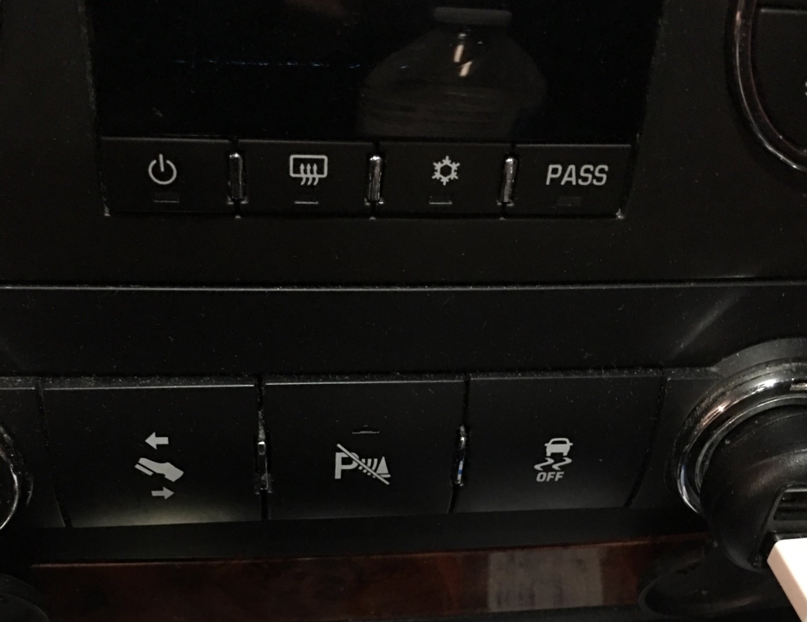

Do you have buttons under radio, towards bottom of dash? Should be truck icon with tire marks below it it, press it and hold it for 5-10 seconds. Once you push it keep holding it down for at least 10 sec ( prob less) and stabilitrac will turn off.

Do you have buttons under radio, towards bottom of dash? Should be truck icon with tire marks below it it, press it and hold it for 5-10 seconds. Once you push it keep holding it down for at least 10 sec ( prob less) and stabilitrac will turn off.View attachment 209123View attachment 209124View attachment 209125
I have the Car with the squiggly lines. Press it once, traction control off. Press and hold..............nothing changes.

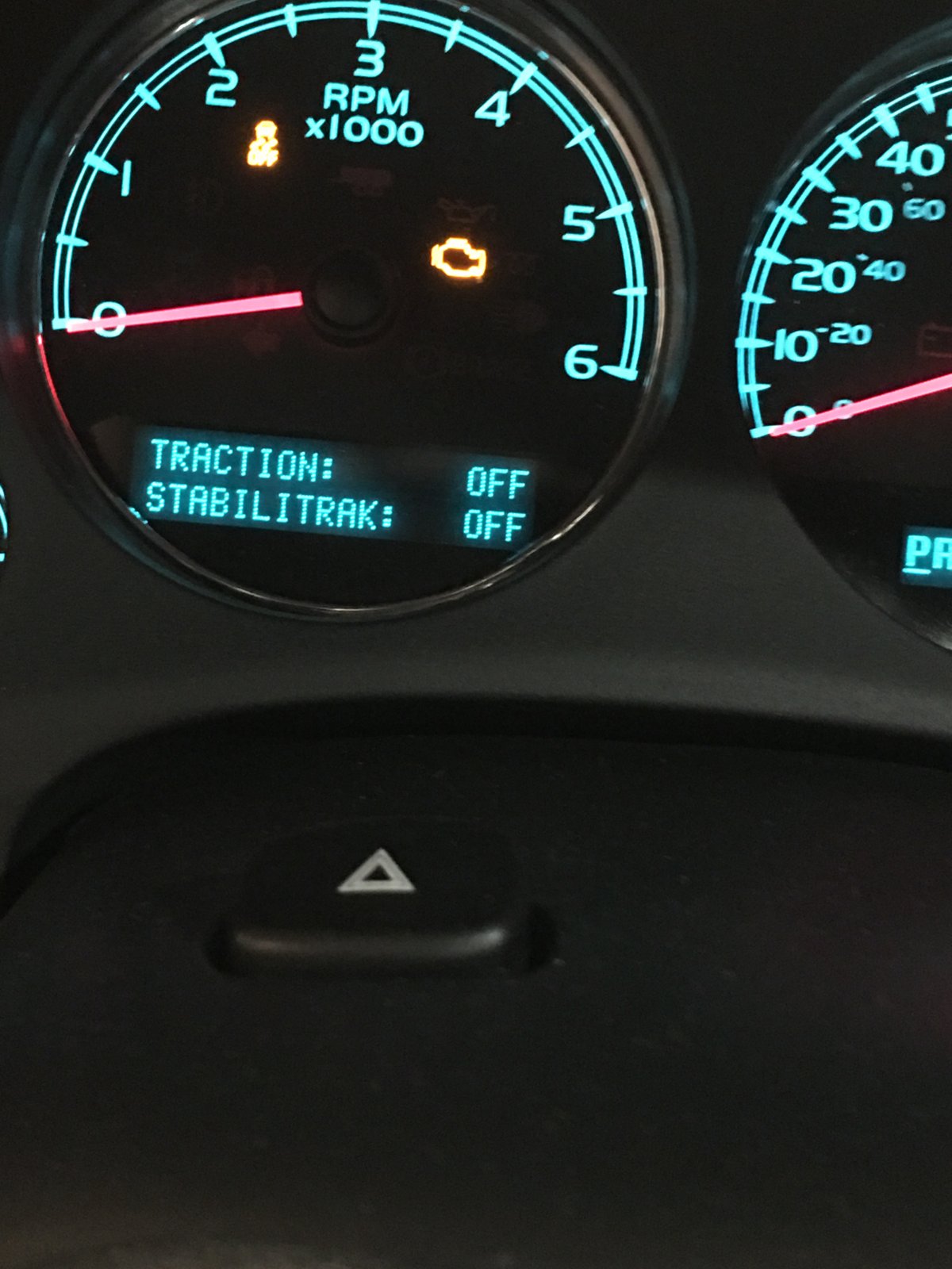

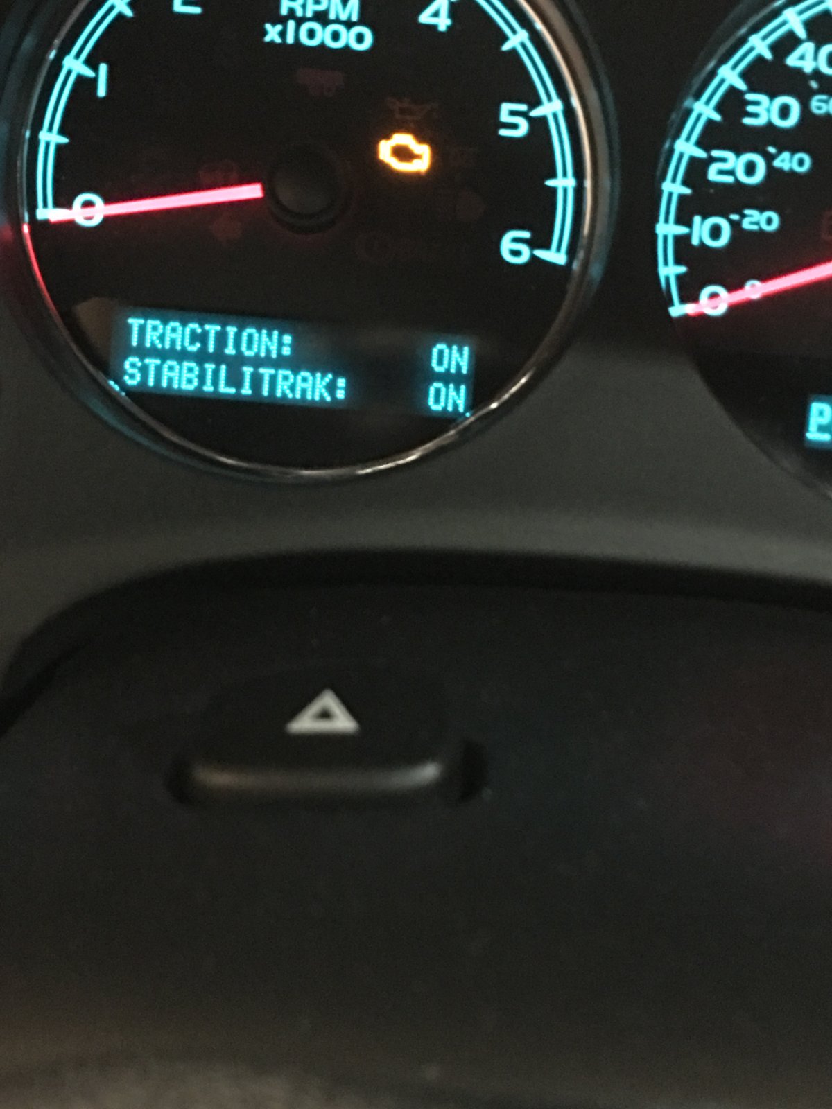

Maybe not programmed in on ppv, idk...I do it constantly on my lt. Try this.....press once then release and that shuts off traction then, within a sec of releasing button push a second time and hold it and stabil should go off. If you can see it in dic display the minute you push button both will be displayed the traction will say off then stabil will go off as well. If you have the button and display in dic you should be able too turn both off
