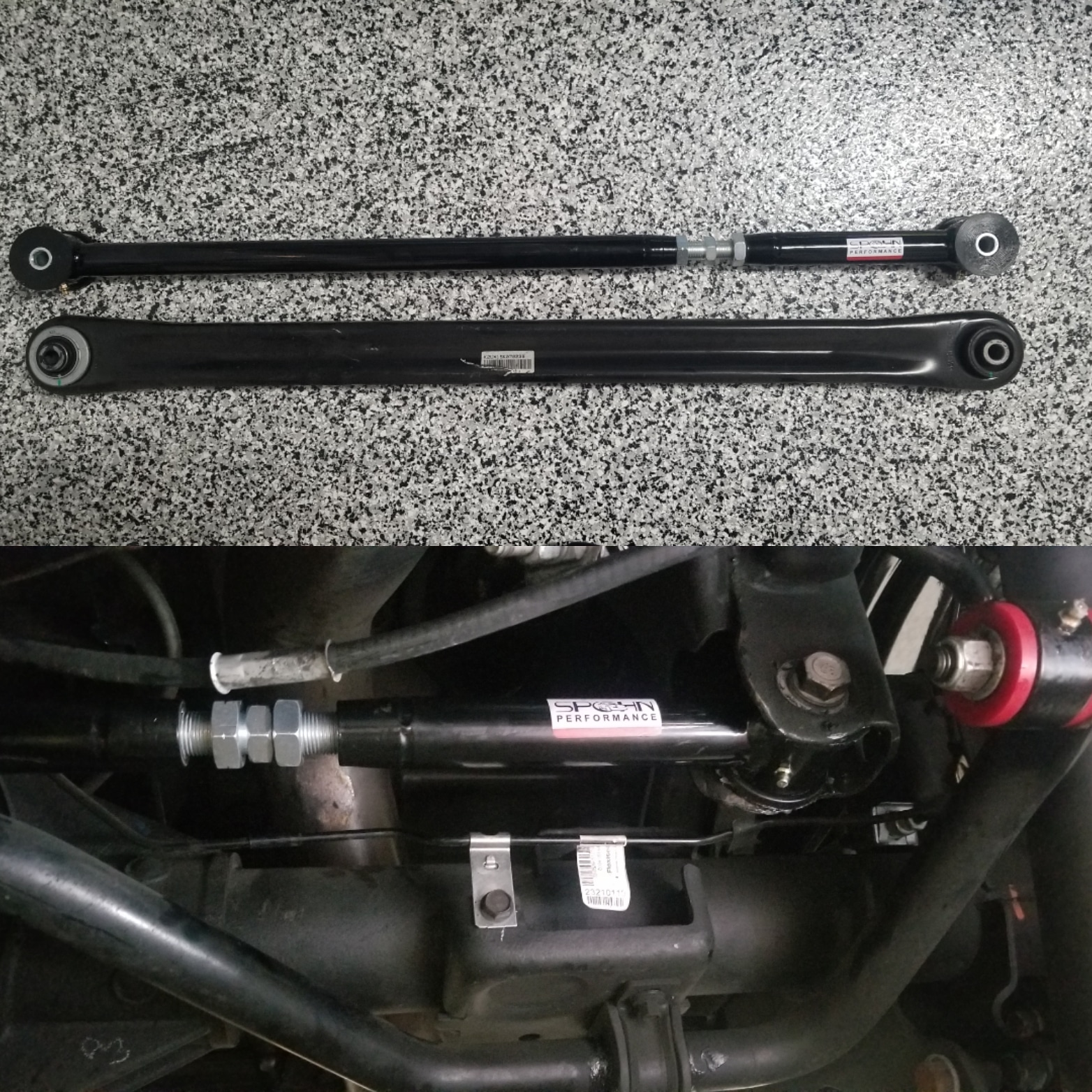

Time to start hitting the rear suspension on the Escalade. Took the flimsy oem panhard bar off and replaced with the adjustable @spohnperformance adjustable pangard bar. I am a distributor for all Spohn items so if you want to save some $$$ on anything they make just give me a yell.
Also this will fix the offset rear end when you lower the gm suvs. On any 00 to 19 gm suv the lower you go the more the rear end gets pushed to passengers side. This fixes that plus a much stronger replacement.

i to all... i have a 04 gmd yukon denali xl wit a 2/3 drop djm & belltec shocks....... i notice a 1/2 inch height difference on the passenger side will this help or make it a even .... all suggestions welcomed
