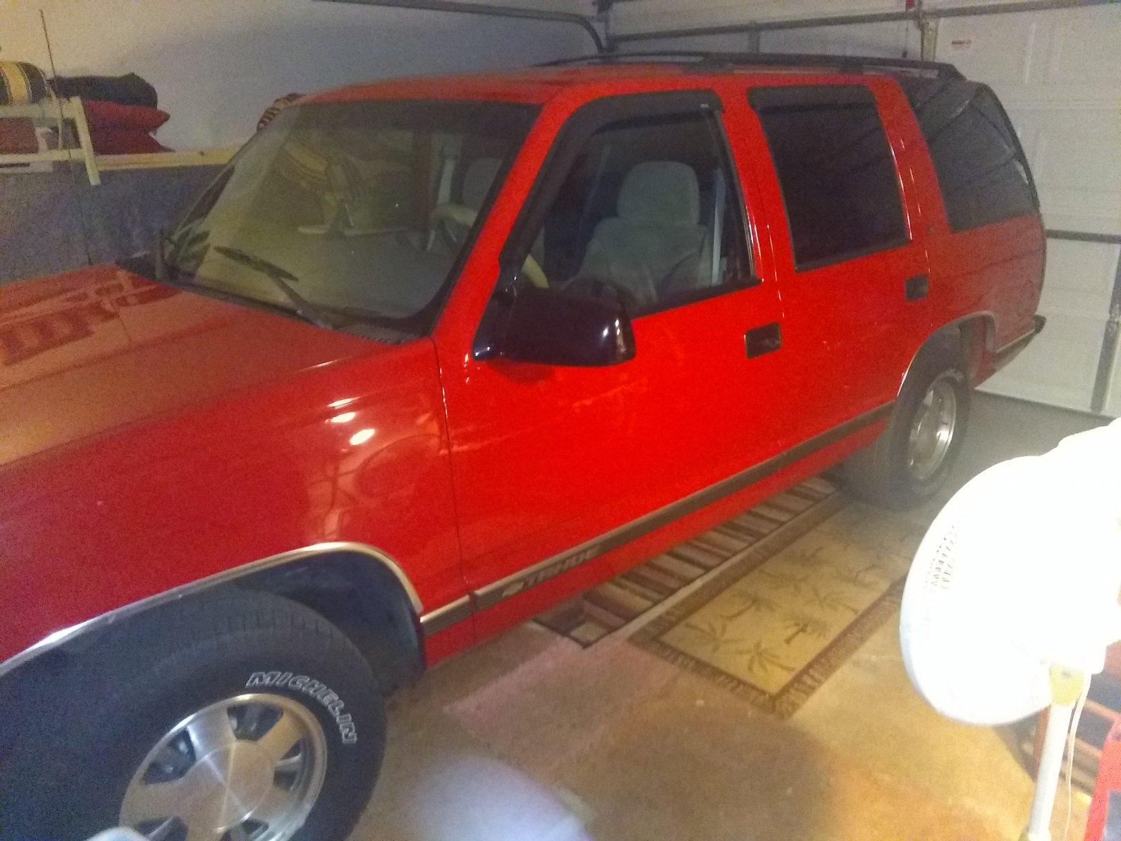

Thanks for the memories, @ 226k, i've had no need to pull my dash apart because it's never given any problems. I am aware the control panel is solenoid operational by means of assistance to vacuum modules, jmho..........good luck.
