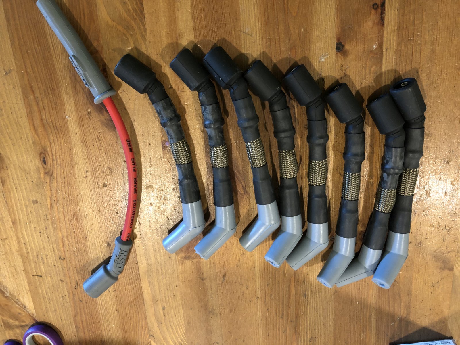

Just thought I'd up date this for anyone else that maybe looking for a set of plug wires I used the msd 8.5 #33823 set. These fit perfect with the American racing headers not to long or not to short just right.
View media item 28125
