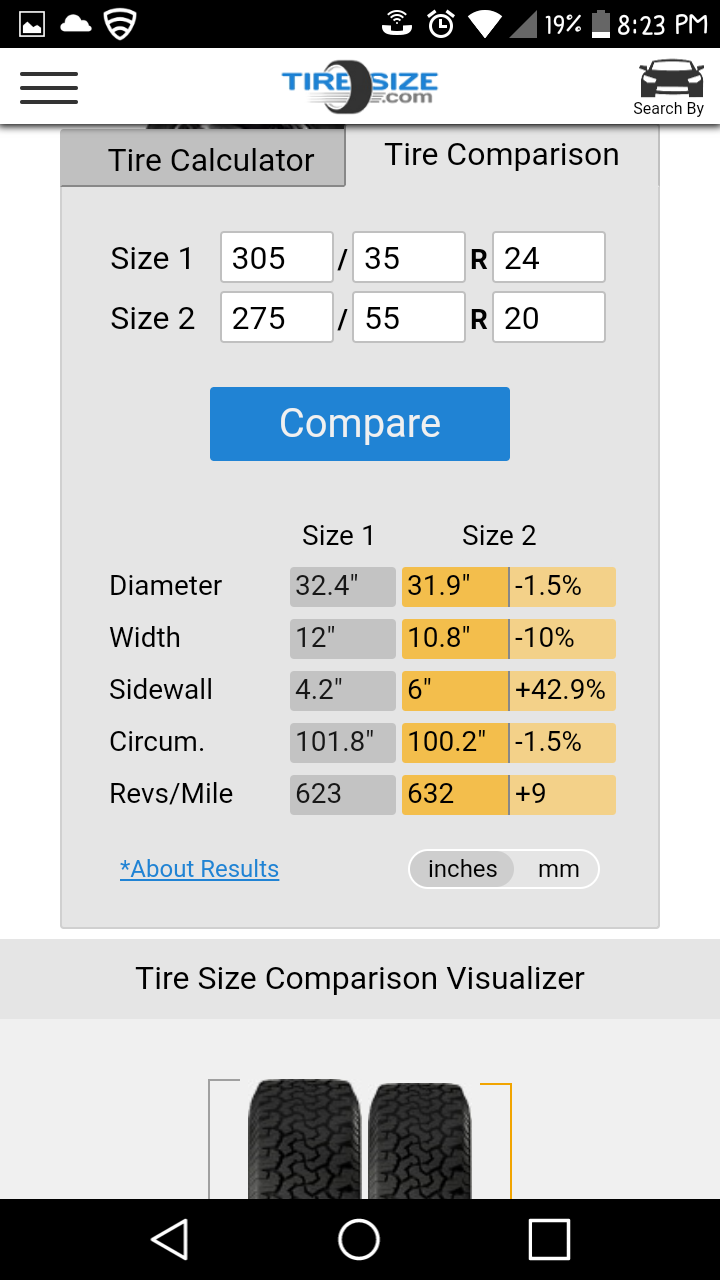

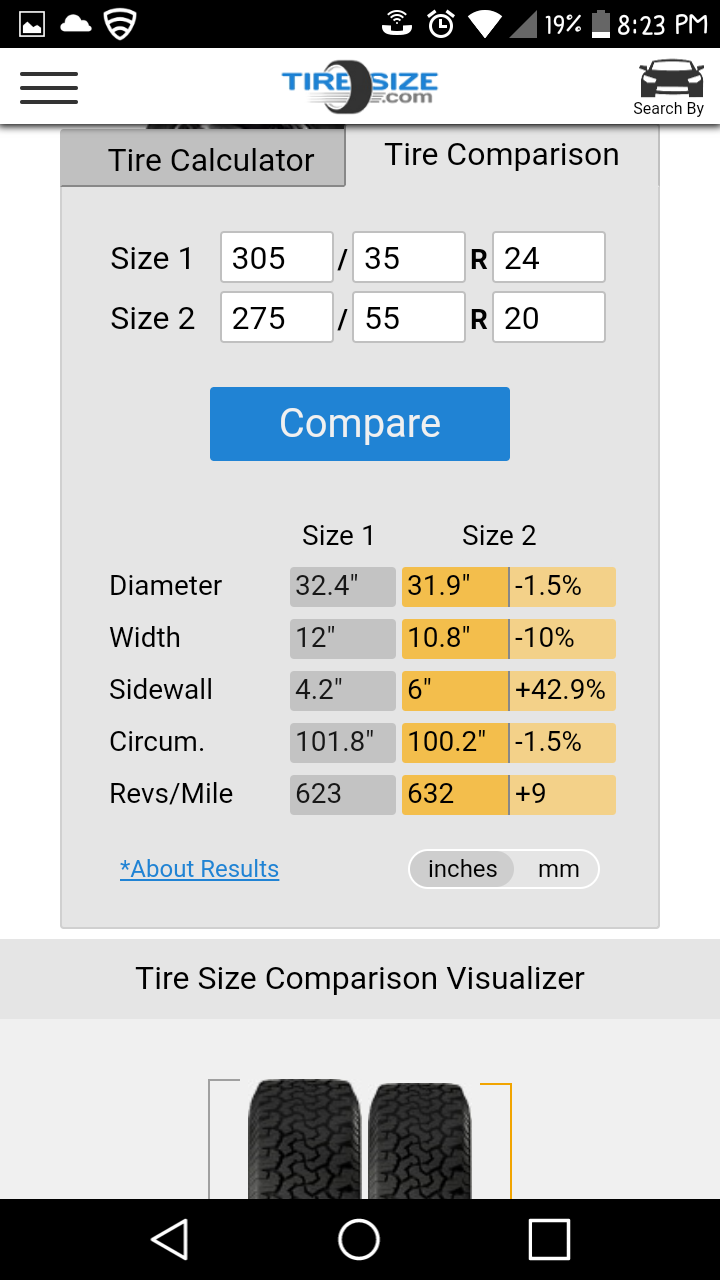

Ok! Try and get as close to the tire size on the truck now but you guys know off hand the minimum size of any size tire before you start to damage gears, axles? I mean like if it measures 31.2 don't go below 26.8 or things will be damaged? Thats an example. These are the numbers for the 20" the 17"were way off.

Ok! Try and get as close to the tire size on the truck now but you guys know off hand the minimum size of any size tire before you start to damage gears, axles? I mean like if it measures 31.2 don't go below 26.8 or things will be damaged? Thats an example. These are the numbers for the 20" the 17"were way off.View attachment 202304

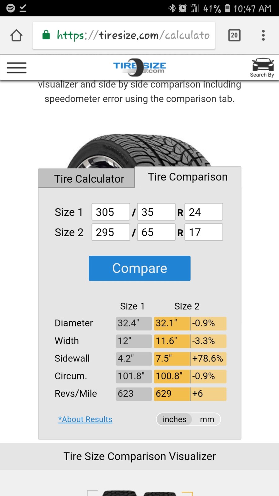

Just out of curiosity... what size is the 17" tire???

The AWD system doesn't like even one tire not being like the others, if memory serves it is not good to even replace them in pairs but rather all four. Get something as close as possible so you can get out of harm's way and get a plug kit and a compressor with fix a flat goo too.
