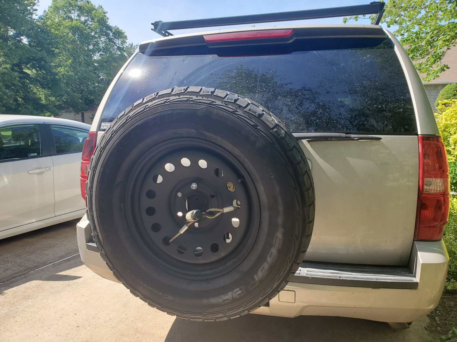

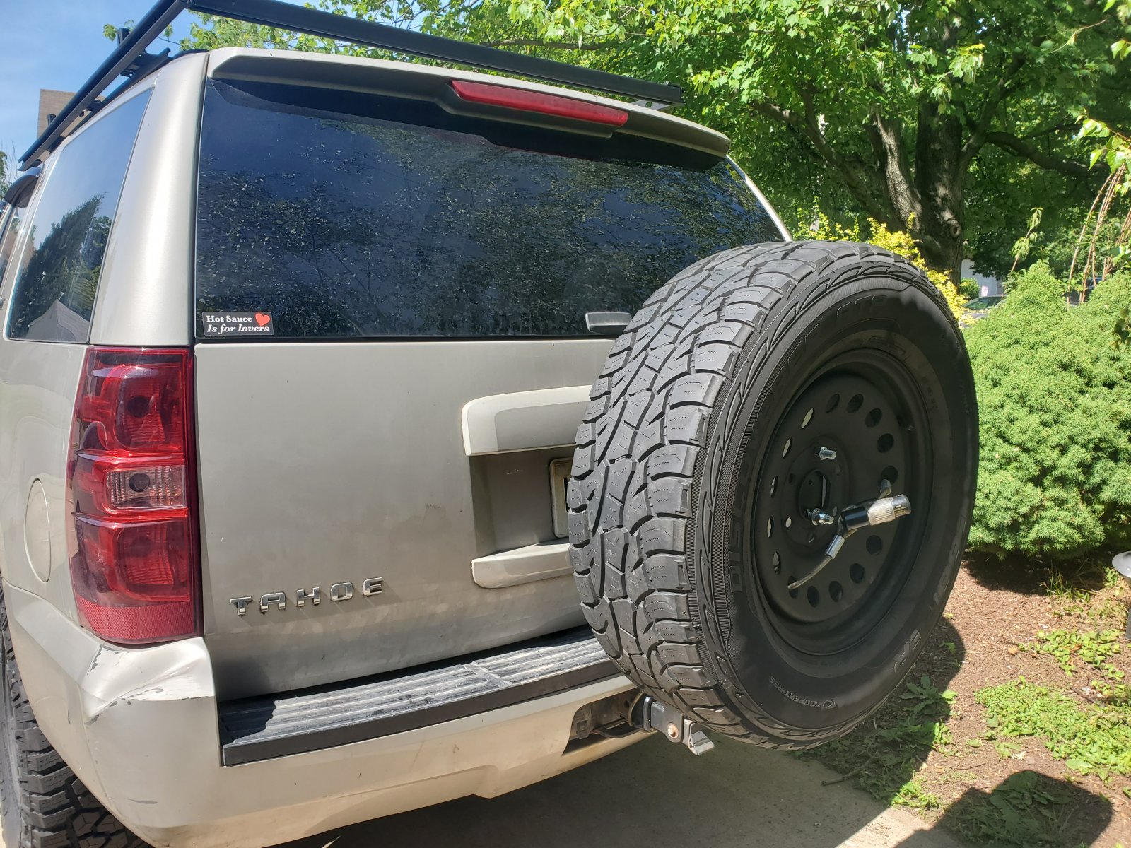

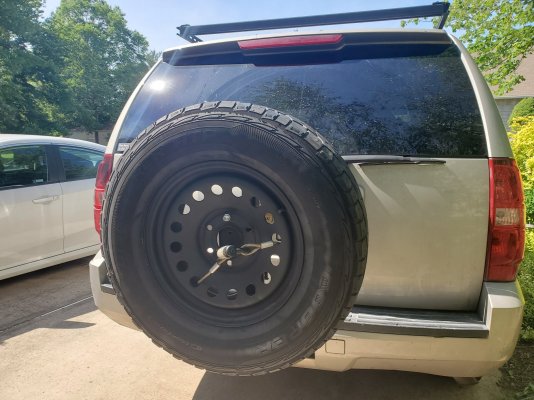

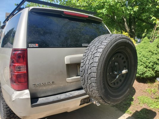

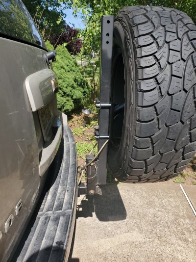

Here is the new spare location. DIY with a tilting bike rack and a trailer spare attachment. Took off the part that holds the bikes, attached the trailer rack then drilled a hole through the center and added an extra bolt. 20210625_155049.jpg20210625_155041.jpg20210625_155108.jpg
