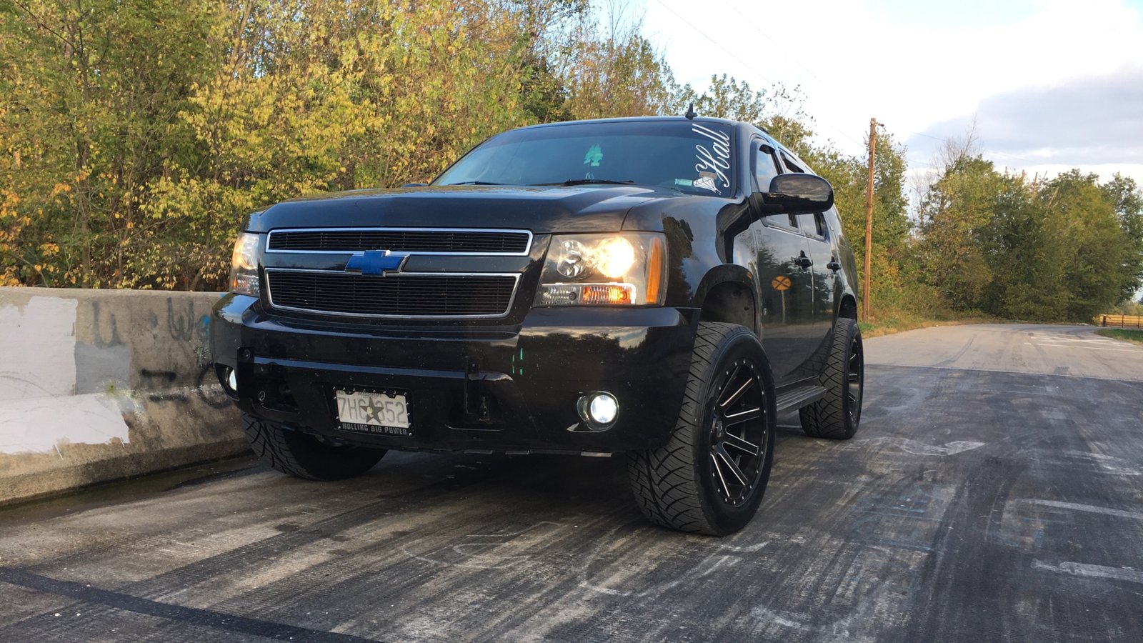

I just got the KMCs installed and they're a 20x10 -24 offset and they're on Nitto 420S 305/50R20 (post pics when i get home) on a 2.25 RBP Level, And the tire installer said spacers will make it look better and ride better and to get hubcentric ones. I know a basic amount about spacers, can someone recommend size, how many, brands and pics.

I wouldn't put spacers on with a 20x10 -24. They sit out 2" further than stock as is. Probably will need to do some cutting and that's a lot of offset. 31/32" tire 4" out when it's only 10" wide street tire will look funny I think.

Get bora spacers. Need 1.75” to not cut studs. Not sure about ride better but looks yes if you want that wide look.
Thanks. I’m probably not gonna put anything I think it looks perfect.

I think it looks good as is and wouldn’t add spacers. Just looks more wide with no lift. Also more potential to rub with wider setup.

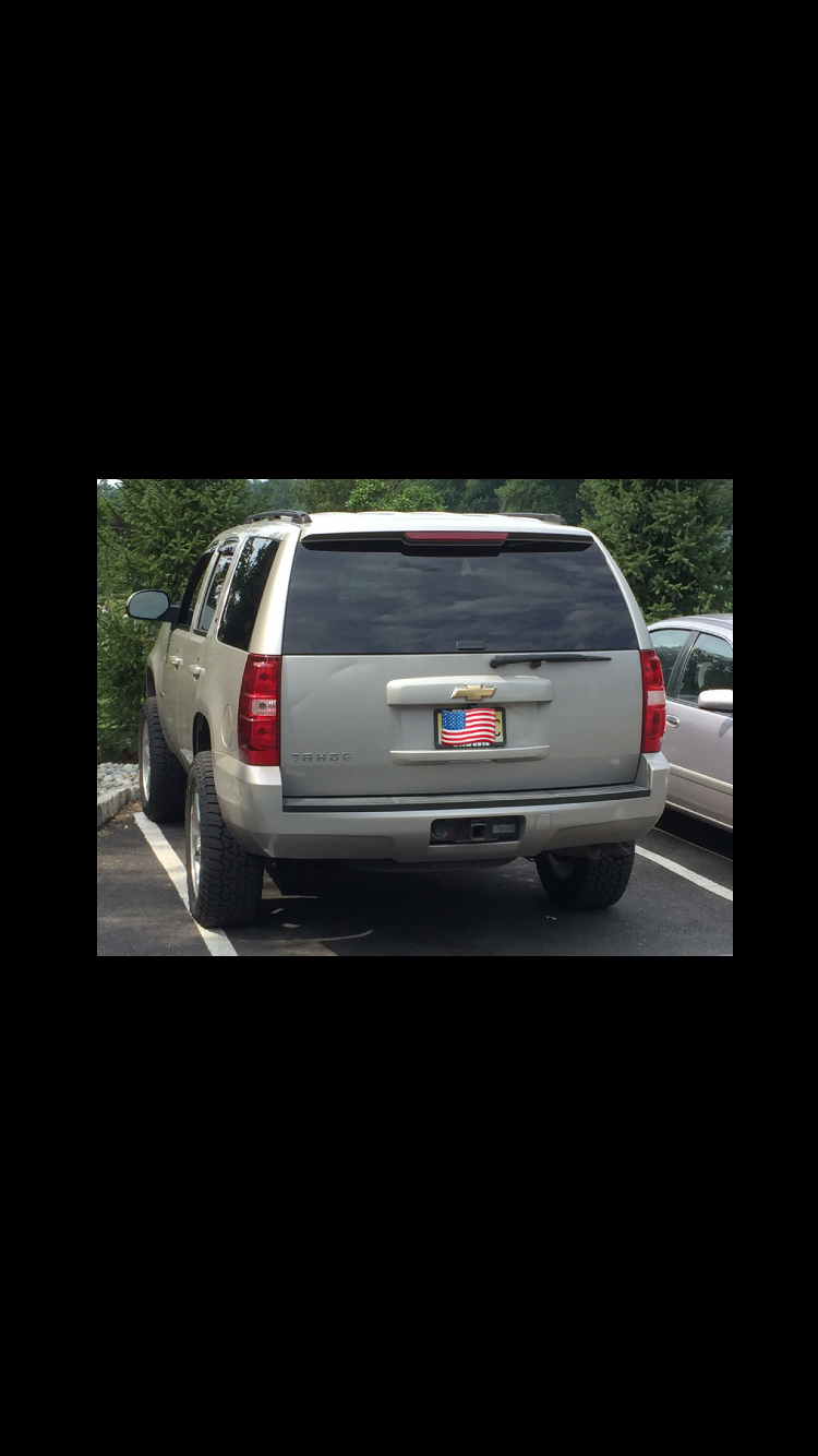

2" spacers from rough countries scratched and dented section. I couldn't decide between 20x10 and 20x12 so I figured I'd run these with my stock wheels since it gives the same offset( sticks out) as a 20x10 -19 would. Good thing I did this since 20x12 would have been a bad idea and I'm already getting stone chips on my mirrors and doors, and I'm getting annoyed at the road grime that ends up on the door handles, the ladies complain about it lol
