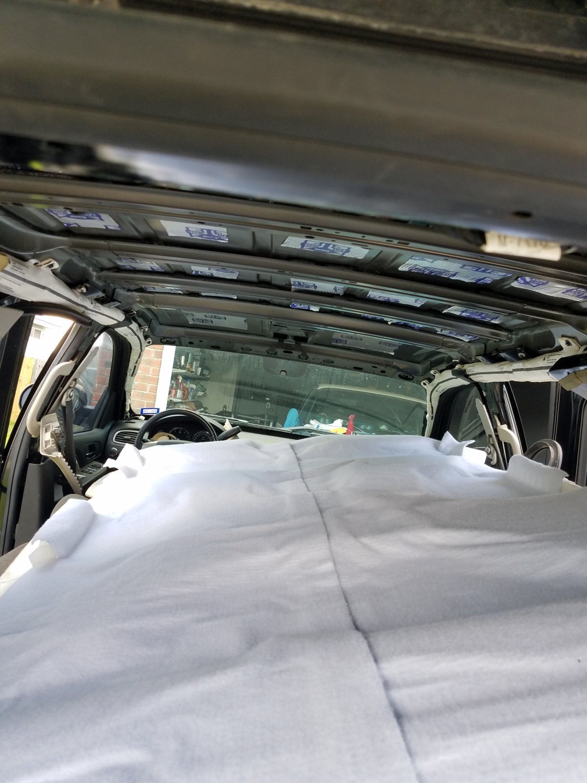

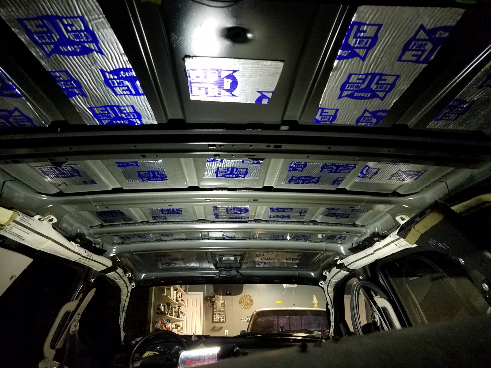

As of today, I have installed sound deadener in my entire PPV. I did the floor when I replaced the vinyl with carpet a few months back. It helped alot with drone. This weekend I did the roof because I had to repair the rear ac vents. Should be alot better. I also put in some thinsulate on the headliner. Hopefully it'll help with this Texas heat .
View attachment 200392 View attachment 200393
