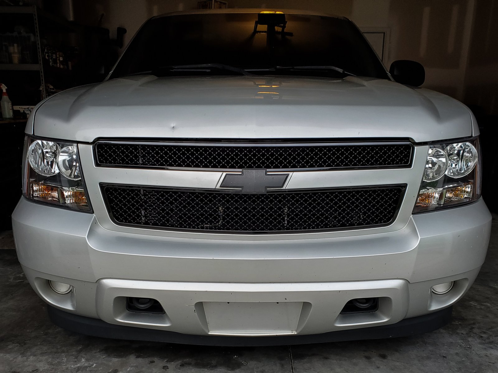

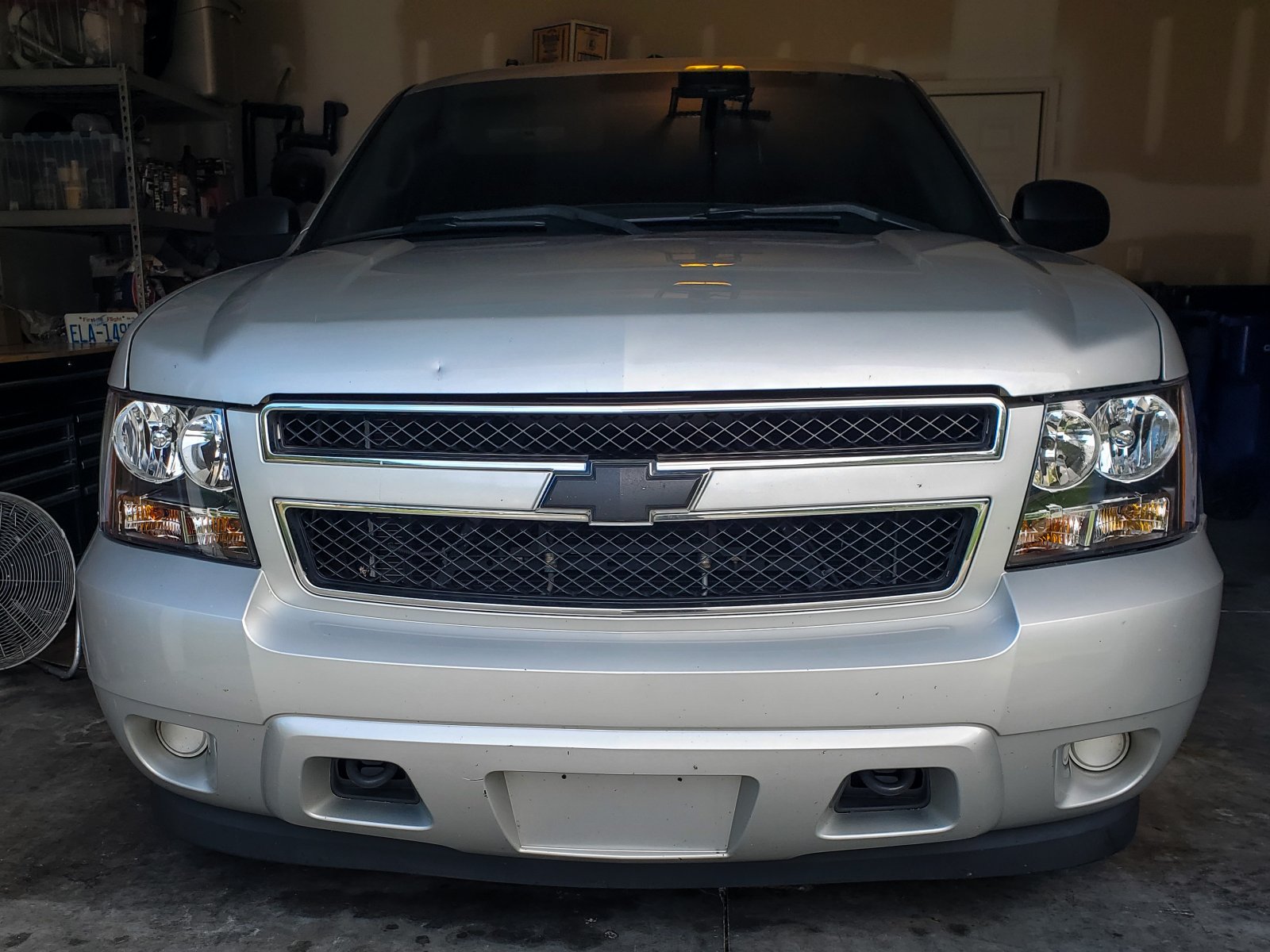

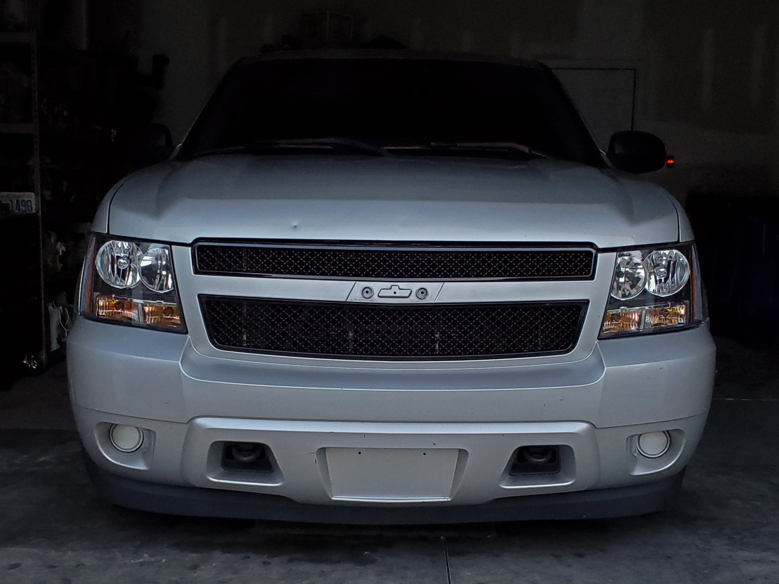

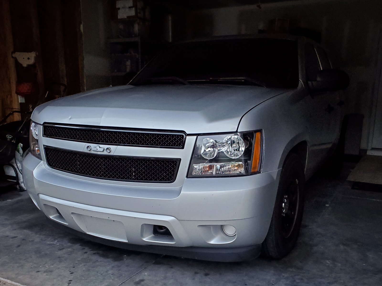

Got the grill in. Watched a couple of videos and learned from other people's mistakes on how to get it out the easiest. In about 10 minutes I had the top and bottom grill out.
I read some mixed feedback on this grill set. One thing I saw in one of the videos where a kid installed this same grill, he had to trim some tabs that comes on the new upper grill. I had to do the same, but fitment was great. The bottom snaps right in, the top fits right in the slot and bolts right up.
My only complaint, the bowtie mount the grill comes with is chrome??? I didn't read that in the description, worst case I'll just sand/prime/paint. I'll post up more pics when the bowtie is up and the truck is clean.

I wouldn’t sand/prime/paint (lots of work), either use vinyl overlay or plastidip, same thing can be done with the original chrome grill.
There are some cool overlays for the bowtie, such as usa or states flags!

I could have PlastiDip'd the grill too, but wanted something that would last and be worry-free with cleaning bugs and road debris. Plus this grill said it was matte black, but its gloss. No biggie, and sanding/priming/painting the small bowtie mount wouldn't take that long either. Take my word, I've been a PlastiDip user for about 9 years now.......before the craze. :)

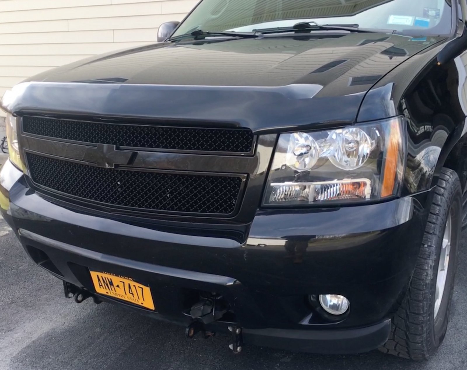

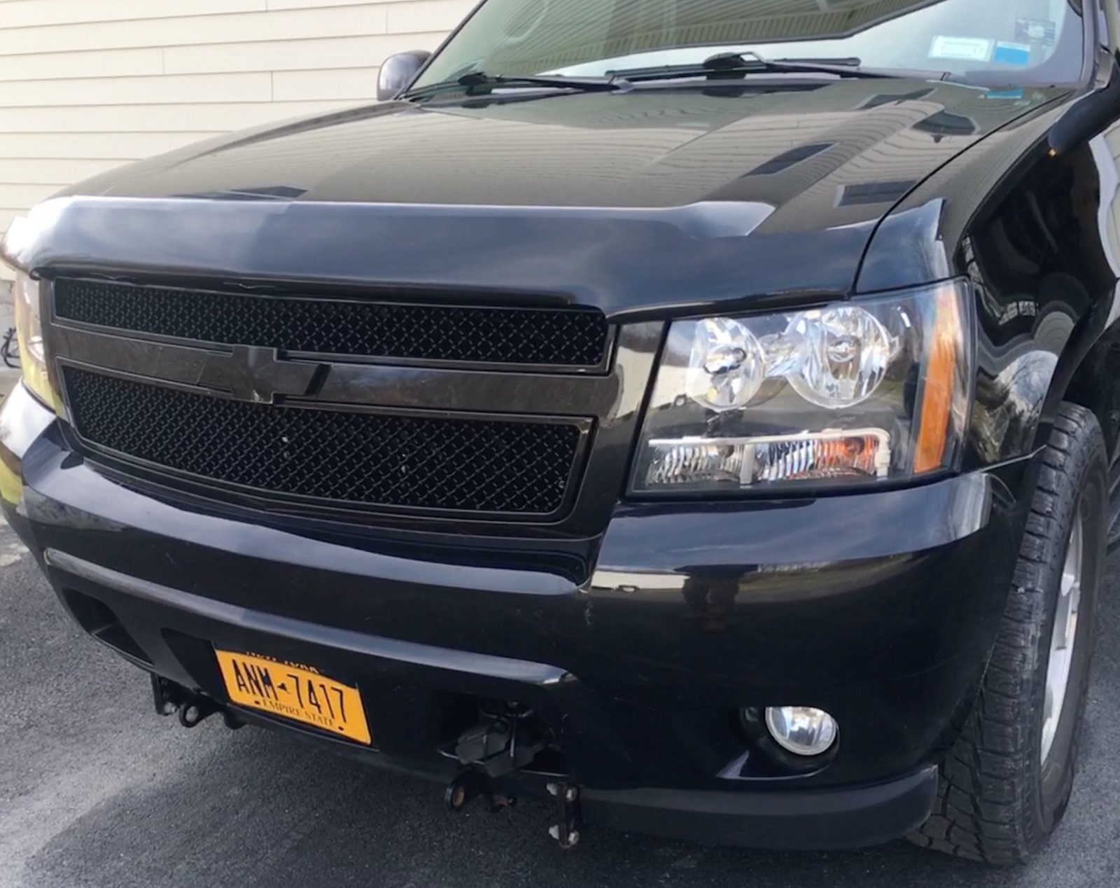

I left the chrome part off an bolted bowtie right to bumper... 2 years going strongView attachment 224714
That looks good! I think I'll toss mine on in the morning and see how I like it.

Thanks @Galante , I never even considered putting the bowtie on without the trim underneath. Tossed it on this morning and think I'll be happy with it, unless I grab a black billet one like it appears you have.
No problem, i like how it sits proud of the grill/bumper... only thing is drying it after washing, towels tend to get caught but other than that i like.
Looks good on silver, mine blends too much i feel but meh whatever....
Yes billet front rear off of ebay.

Your headlights new? Probably next for me.. but considering the updated look ones also...
eBay has OEM types for $100.
RichardCranium
RichardCranium
Dec 13, 2016
936
1,848
Mebane, North Carolina
Yup, best investment for the outside look of my Tahoe that I've made. My factory lenses were badly yellowed. I can't recall the vendor I went with, but it is surely documented in my headlight link below in my sig.

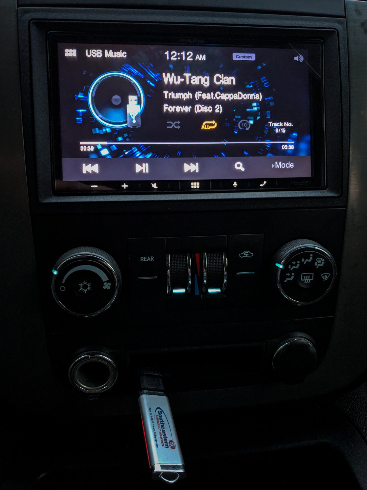

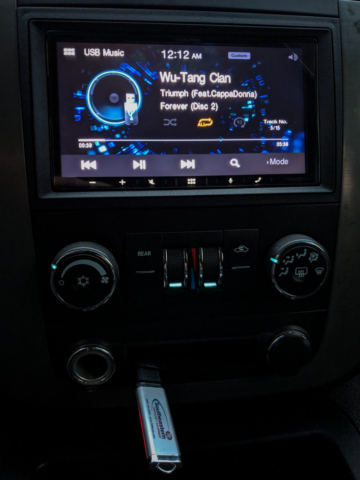

Finally decided on a head unit, of course the purchase got escalated when the auxillary and radio kept toggling back and forth.
Picked up an Alpine head unit with a 7" touchscreen, and installed with with steering wheel controls with a complete installation kit from Amazon. I'll post up part numbers in the morning.

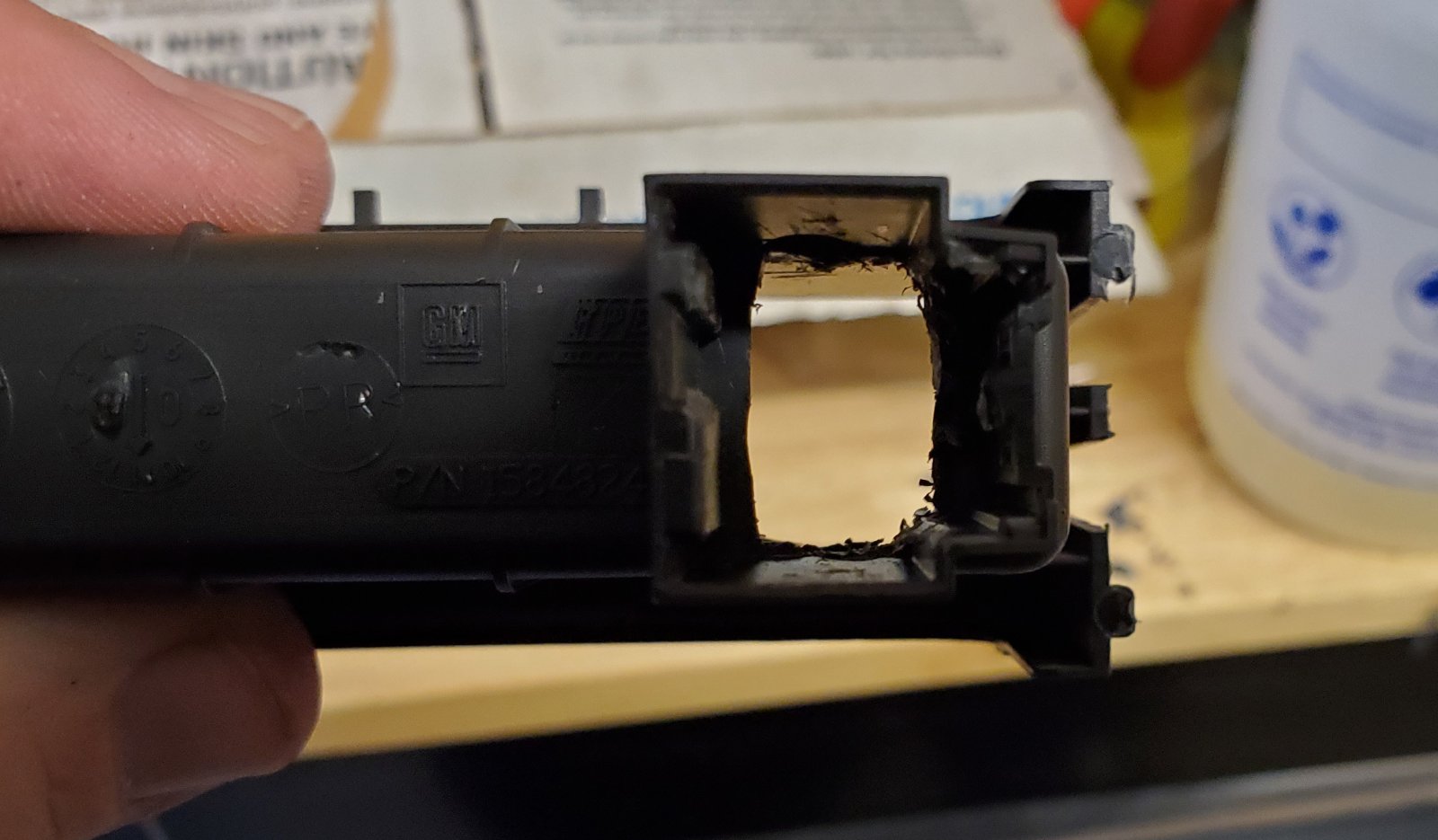

In the bottom 12v outlet tray, there is a factory harness plug for the adjustable pedals, park distance, and traction control. I'd guess no PPV has this option, mine didn't. I pulled out that hardess plug and hollowed out where it was locked in, so I could feed the USB through it. I doubt the USB would fall through, but threw a ziptie on just in case.
Everything works great, and this install kit came with a chime box.....which is actually a more pleasant tone than factory. And you can adjust the volume, which is pretty cool.

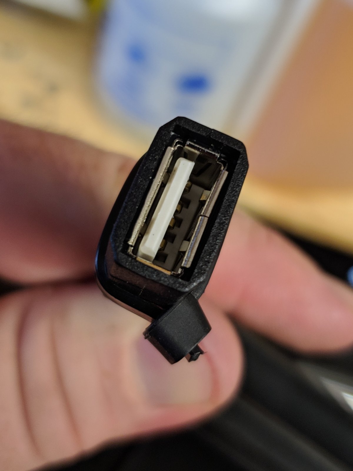

GM has a factory USB port that replaces one of the two 12V power ("cigarette lighter") ports. I don't see why I'd ever need two power ports so I changed my passenger side power port to the USB when I installed the Pioneer.
Everything works great, and this install kit came with a chime box.....which is actually a more pleasant tone than factory. And you can adjust the volume, which is pretty cool. View attachment 231968 View attachment 231969 View attachment 231971 View attachment 231972 View attachment 231968
It looks like the usb he installed goes into the radio...

Head unit is an Alpine iLX-W650, its a 7" screen. All I really cared about was Bluetooth and AndroidAuto. Alpine also has a small amp that easily interfaces with this head unit to get a little more power to the factory speakers, which I might end up doing when/if I upgrade those stock speakers.
Here is the installation kit I ordered. It is a nice kit, included everything I needed to do my install. Also retained steering wheel controls as well, and can easily add a backup camera. Also includes a phone mic with along cord, and comes with a customizeable chime box as well. Would definitely recommend this kit.

I did not know that, have a part number by chance? I'll try to look it up later if not, no worries.

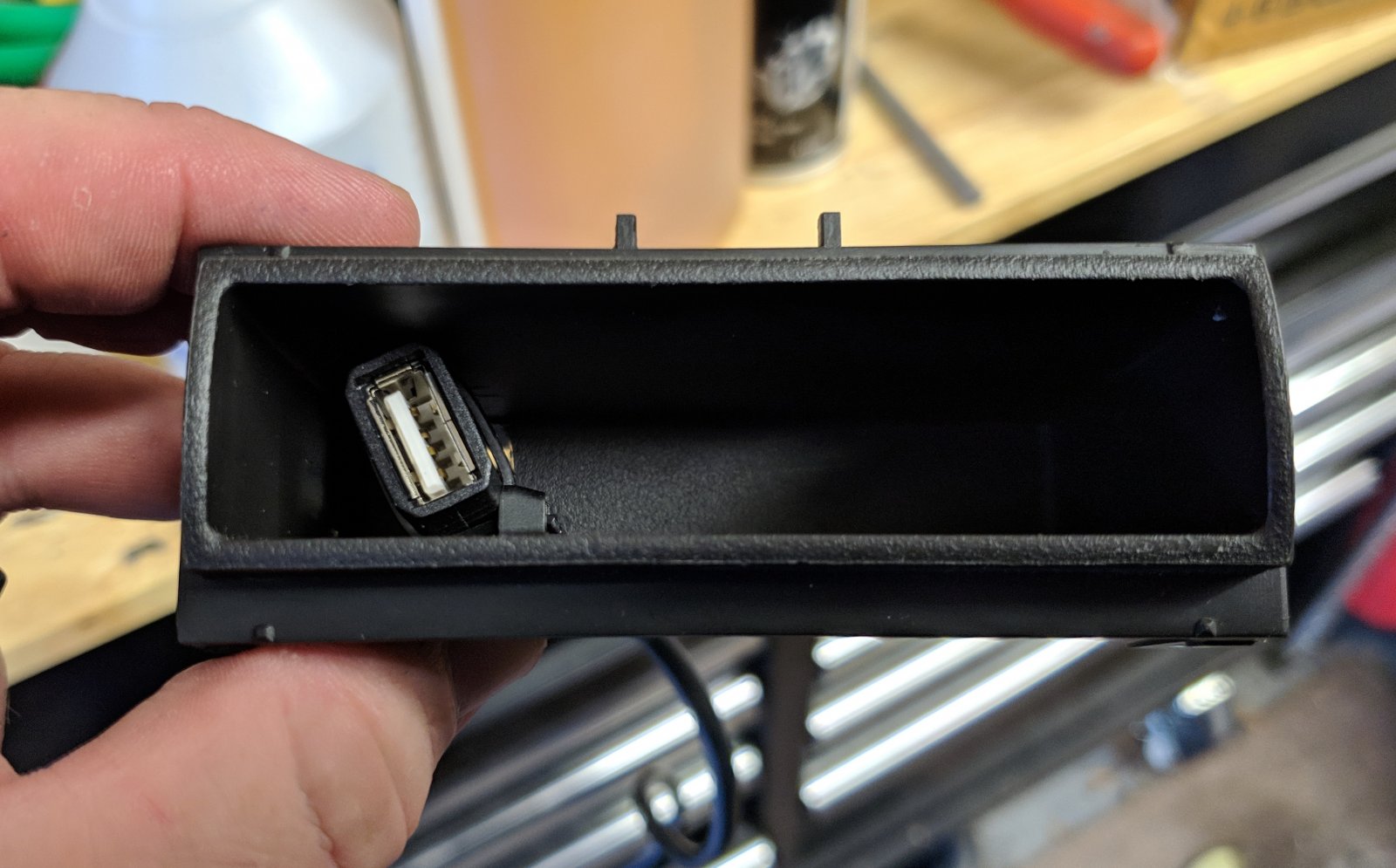

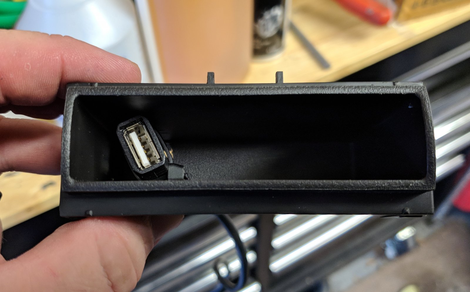

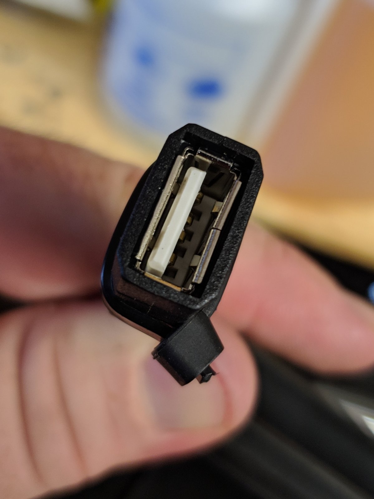

USB jack: 20944422
Cover: 20983937
You don't have to use the cover if you wanna save the ~$25. The only difference between it and the original one is it has the USB symbol on it. These covers are usually broken, so if you're missing one, this would be a way to fix that at the same time.
There's also a factory USB cable (22829189) that has the mini USB ends that lock into the back of the jack and back of the factory HU. I got this cable so it'd lock into the jack and I think I used an adapter to convert the mini USB to the regular USB for the back of the HU.
