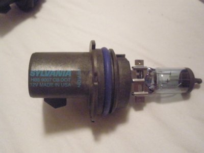

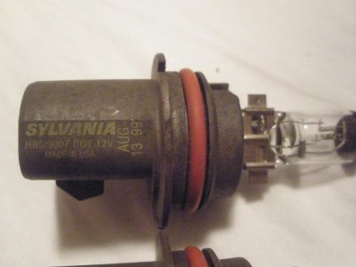

have some HIDs here i think..not sure IF YOU KNOW WHAT I SHOULD OR CAN DO WITH THESE it would be great thnx
The red one says SYLVANIA HB5/9007 DOT 12v
Blue one says SYLVANIA HB5 9007 CB DOT 12V

you have two standard hallogen 9007 bulbs. They are not HID, just standard capsule replacement bulb. If your fogs run 9007 then you can plug them right in.

Blue or red it doesn't matter those are just o-ring colors. Blue is what Sylvania had available in November of 08, Red in August of 99.
Use the blue, its about a decade newer lol.

The one with the red ring is just a regular Sylvania 9007 bulb. The one with the Blue ring has a CB in the part number which stands for Cool Blue. Its will be whiter than the regular one, but not as good as a Silverstar. Regardless, you can't use either on your truck because none of your lights use a 9007 bulb.
