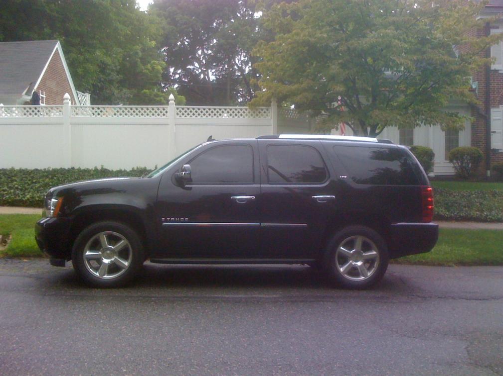

Ok, looks like my shop got and installed:
Belltech 5321 rear coils
and
Energy 26103G coil spacers.
These spacers were used to 1) keep the rear from dropping the full spring amount, and 2) because the shape off them would retain the springs like the stock isolators. I'll have to double-check with my installer as to exactly what he did, but seems to me that he had them bored out and trimmed so that they would sit (around the bumpstop, maybe?) and keep the springs centered as they should be.
I'll get more info on the install, but these are the parts.
Hope this helps!!!

Spoke to my installer, and whereas I know I was bothering him in the middle of another project, and over the phone, I think I got what he was saying. Seems to me that the spacer he used along with the springs were 5/8" spacers. That makes sense, since the springs are marketed as a 2" drop kit, and he said that the truck dropped @ 1-3/8" in the rear (2" - 5/8" = 1-3/8"). He bored out the center of these spacers so that they would fit the same way that the stock rubber "isolators" fit (which must have a hollowed out center that must allow the bump stop or something to pass through the center). He put these atop the stock isolators (if I have this all correct).
Yes, the ride has improved in aspects. At worst, it is the same as stock, I'd say.
Let me know if there's anything else I can help with.
Assuming I did this correctly, I've attached another pic from today (raining, and the truck's dirty, but it shows levelness).

Yes. The autoride sensors are either "bent" or relocated (don't recall which it is) so that the sensors think that the new, lower height is the optimal ride height. Otherwise, the compressor will be trying to raise the rear constantly.

cant really tell the difference. but the truck still looks good!!
Haha Well, trust me, it's different. Whereas it may not look "lowered," it definitely no longer has that high-in-the-air stock look anymore. That was my goal. Thanks!
