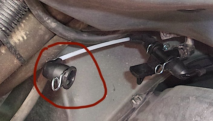

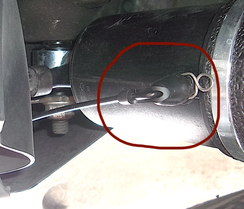

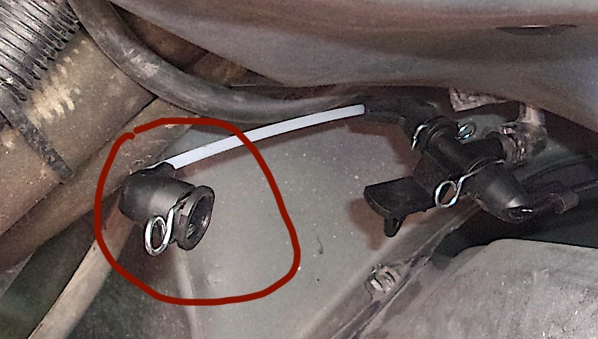

Joseph, they are not inflating. I can hear the compressor run for about 7 seconds, but the bladder is still soft. I have put a few pics on here for you. One shows the white-line connector, which is not connected to anything. The other shows the black-line connector, which is connnected to the air shock. The original shocks I removed also had only one connector fitting on each shock. The compressor is the one specified by Dorman for the 2007-14 Yukon Denali 6.2L. The compressor that was removed (made by Delphi) had only one air fitting,\ with a black air line connected, which is why I chose to connect the black line, not the white. I am attaching two pics for you. One shows the not-connected white line, and the other shows the connected black line. thank you for any input you can give.

neither one of those photos are of the pump, all you had to do was remove the old shocks, install the new ones, reconnect the air line, same with the pump remove the old one, install the new one re connect the existing air lines, the new air line can be thrown out or kept as a spare should you ever need it for some reason
26,678
52,941

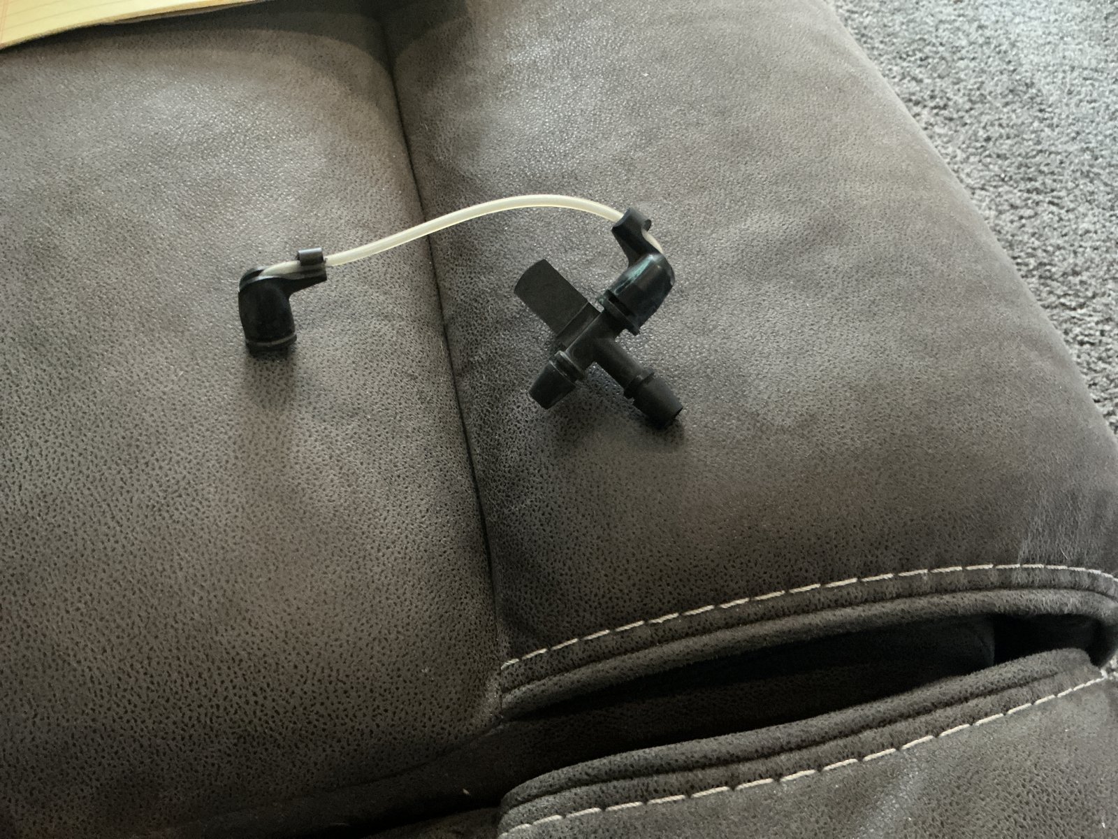

The compressor comes with a T fitting, and your truck also has the same T. The white line goes to the compressor and the 2 other ends of the T go to the 2 lines that attach to the shocks. Sounds like you now have 2 T’s if you didn’t replace your stock one and instead hooked up the new T to the old T. In which case you now have an open end of the new T which just releases all the air so your shocks wont inflate. Either locate and replace the old T with the new one or (easier) remove the new T and connect the white line from the old T directly to the compressor., Here’s the original T off my truck. I replaced it with the Dorman one but in all reality I should have just left the original one on as the Dorman one was a PIA to get on. make sure you are only using one T, either the new one or the old one. Definitely not both at the same time. White line= compressor to T. Black lines= T to lines that go to the shocks.

Just to finish off the post, I did get everything hooked up correctly. The old compressor was being used as a guider hooking up the new fittings, but there was fitting and hose missing (broken off) the old one, so I screwed up the hose routing on the new compressor.
In the end, it got completed, the compressor ran for a few seconds, and the bags are firm. Noticeably better ride now.
