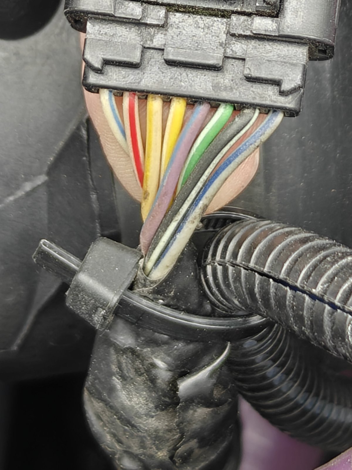

I posted in my own thread but my google search came back with this one. Hoping I can wake up the troubleshooters that were in this thread or others that really know. @Big Mama @Fless @Doubeleive @Joseph Garcia
From left to right we got
4.7, 4.7, ground, a flakey ground, 12v, 4.7, ground, 4.7
The flakey ground was showing .02~.04 and it wasn't clean\steady, like the other 2 grounds or any other ground we touched on the truck. Not sure if I can just tie in a new ground wire to that line or if it talks back to the computer but this is a mess. I just replaced the MAF sensor and purchased a MAP sensor as well which I am going to try to install today. The MAP sensor is relocated to the rear of the intake manifold on Whipple supercharger installs so its a far reach for me and I may need a mechanics assistance
There is a whipple adapder that goes between the GM harness and the MAF but the readings were the same on the adapter and GM harness.
Please help! I am supposed to be leaving for Lime Rock Thursday night and I am scared sh1tless that I am going to have a break down in the middle of the track over a stupid sensor.
Almost 9 years and 118k and this truck has never let me down. This is the first time I am scared to drive it.

funny thing my map sensor took a hard crap saturday evening, replaced it and everything seems to be ok now but I was poking around as it was a couple weird codes
this video may or may not be helpful, has some detailed information on the maf harness. this is for a sierra but it is a identical system, doesn't matter if suv/pickup they run the same and have the same enignes.

Just watched the video - I am getting the same readings. Gonna try and replace the MAP tonight if I can reach it. Funny thing - that guy is located in Jersey so I just reached out to him to see if he is available and his rate. Hopefully he responds.
