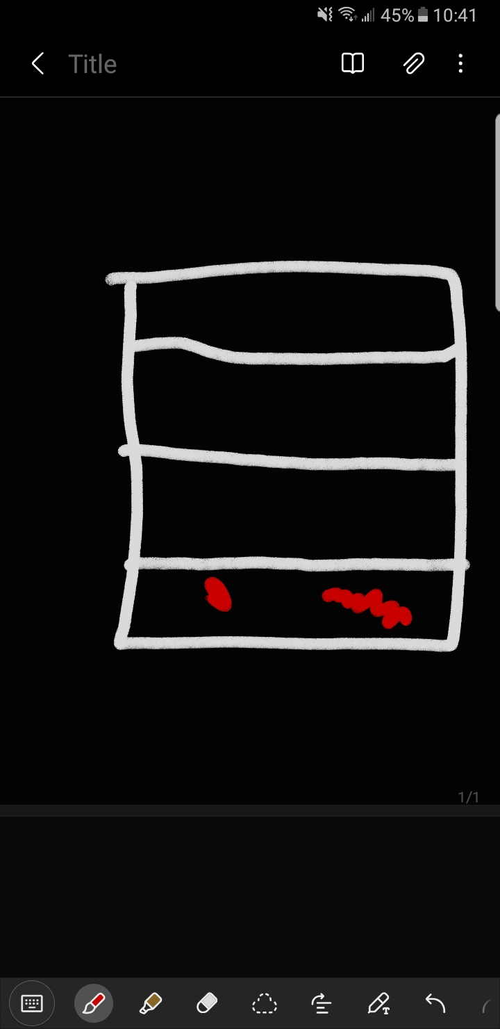

I'll take some pictures when it's light tomorrow. The front of the radiator isn't so bad, but the back of the radiator, if you divide the radiator into quarters horizontally (lengthwise left to right), most of the bottom quarter is essentially bent. There's a lot of large patches of bent fins in other parts of the radiator as well. Not sure how well it will show up on my camera but I will try.
Here is a poorly drawn example of what I'm talking about until I can take a picture tomorrow. The spots colored red are where a majority of the bending is on that bottom section.

I think it is a combination. The fin air flow is important and is way overlooked a lot because it is "out of sight and out of mind". While it may not be the cause, I think the thermostat is the biggest culprit, it is still something that needs addressed when found. I will take a 1-2 degree difference in temp reading any day for a little bit of work. It also helps the condenser to dissipate heat as well with a free flow of air in that area instead of air turbulence getting stopped up and finding a different path for air release thru the fins.
