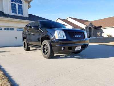

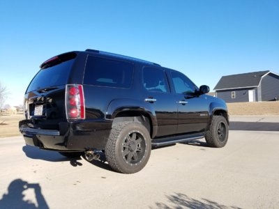

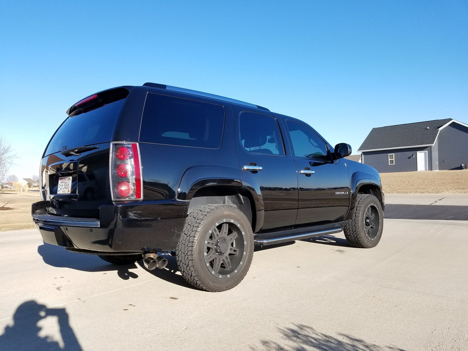

Put the new Arnotts in the front. Had one of the bolts bust on the sway bar end link, so I got some Moogs from the local O'Reilley's so I could finish. They ride smoother for sure, bumps don't feel like I'm plowing over mini curbs anymore. Took it up 10 minutes on the interstate and it is smoother for sure. Wish it was a hair smoother, but have to be realistic about how smooth an A/T tire will ride at 80. The other vibrations I was feeling are gone for sure.
Not sure how good new stock shocks would ride vs these but I'm happy for sure with these Arnotts. I had about 117k on the clock when this was done.
