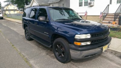

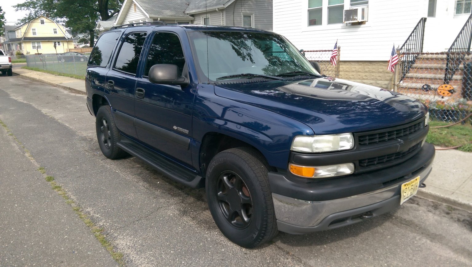

They fit. I have an 03 Tahoe and I replaced the front bumper with one from a Sierra pickup. Bolted right up with no issues. IMAG0023.jpg

Np. I had to change the lower plastic valance tho, which is very easy. The Sierra's didn't have the cutouts for the fog lights. $42 for a bumper is awesome!!
