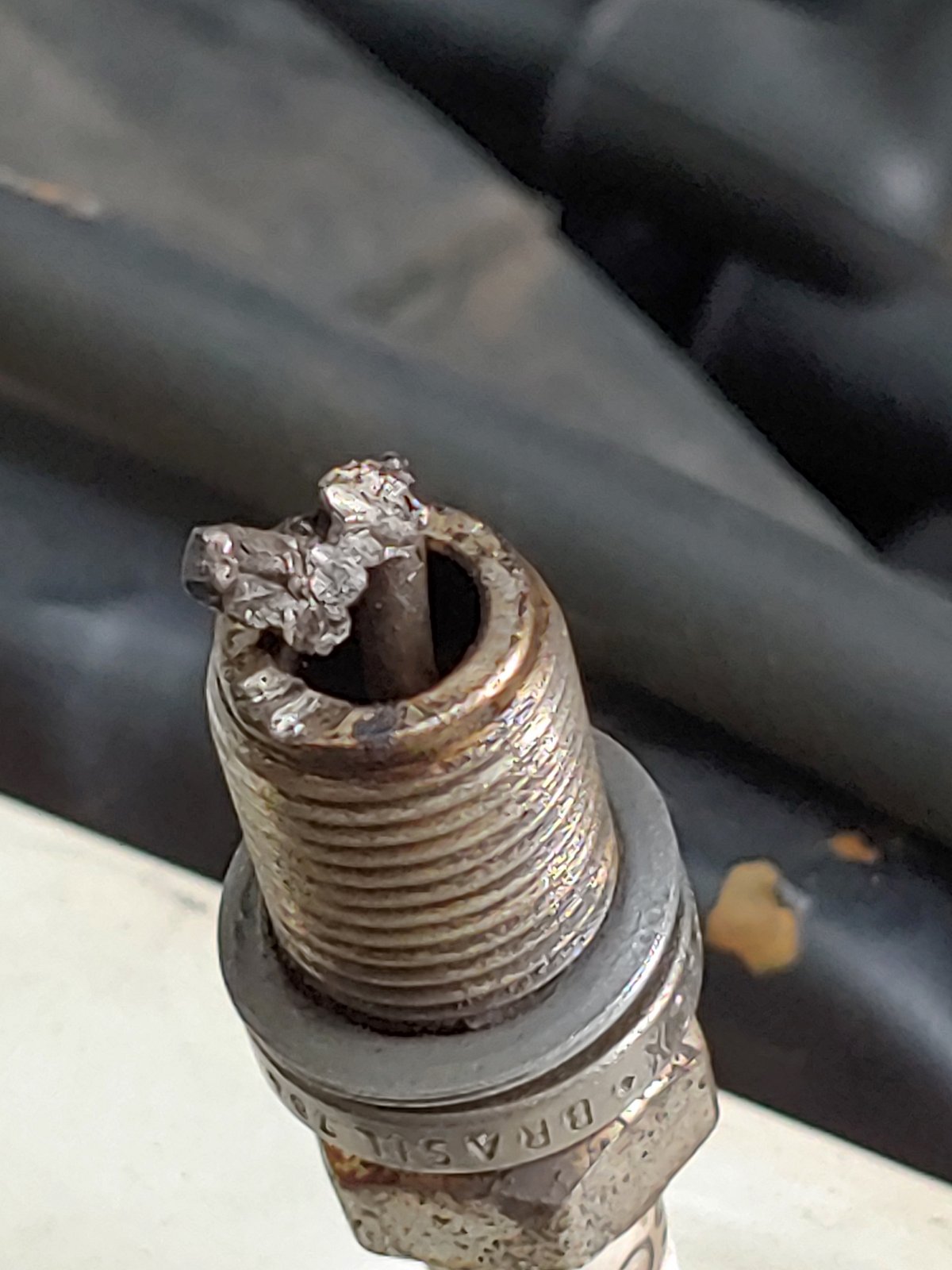

SO this is not on one of my Chevys, but I know you guys have all the answers so Ill throw this out to yall

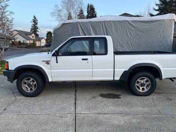

Got a project truck for my son... super clean 91 Mazda B2600 4x4... bought it not running, PO doesnt know why never had it looked at.
Pulling the plugs out today, I found one cross threaded ... really who the Fu@& rams home a spark plug after getting resistance? Probably used an impact? ANYHOW... moving on, the 4th cylinder's plug was DESTROYED!
Never seen one like it.
I checked the model info against the others, its the same plug as the rest, so its not longer, etc.
Also checked the # and it appears these are correct for this engine. (Bosch FR8LCX)
What can cause this to happen?
What can be done about it?
Is there something I can do to test anything or just try to get any debris out of the chamber and stick another plug in there?
Does it appear mechanical or could this have been a failure of the plug?
PO stated that the truck died while on the highway and he just had it towed home and posted it for sale.
Not entirely sure about that... oil looks like its been changed and not driven since... its clean, looks like canola oil on the dipstick.
Engine turns over okay without any odd sounds, etc. even tries to chug a bit but obviously wont start with a dead cylinder.
Thoughts?

I’d pull the heads and see what’s going on.

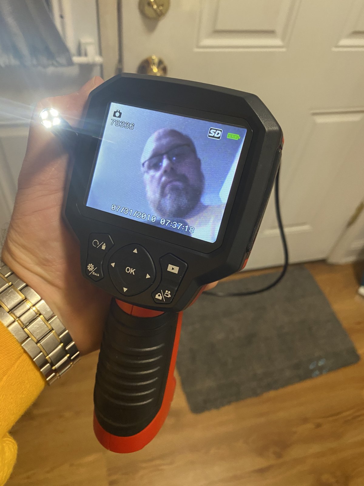

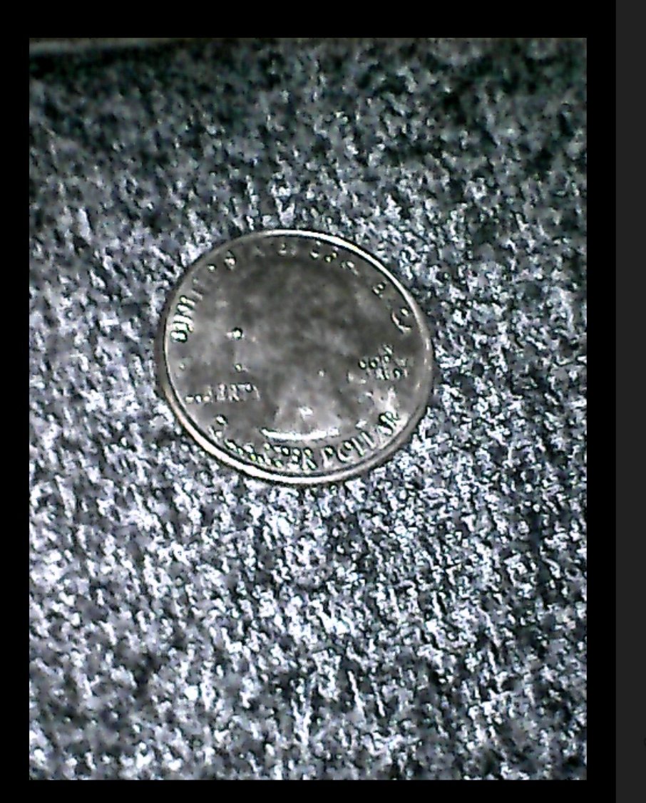

Would those be good enough to examine the cylinder wall?
I wonder how good the resolution really os
I picked one up on eBay. It’s fair, I wouldn’t call it HD. But it would work fine for looking at a piston. eBay has a long shipping time as it came from China. About 3 weeks.

Best you can hope for is the ceramic on plug cracked because the idiot dropped it and didn't throw it away. When piston came up it pounded that loose piece into electrode smashing plug and likely marking piston top. Worst is cracked or holed piston or Bent valve. Make sure to look at valves when open also. Compression test necessary too. Let us know what you find.

No compression on that cylinder.
Cylinder #1 was about 150... Didn't check 2 or 3

No compression most likely a holed piston. If cylinder looks good AND its a low mile motor you might get 50k more miles out of it changing piston. May be better to look for a totalled truck as a donor motor. Or add that LS motor on the stand in the garage!
