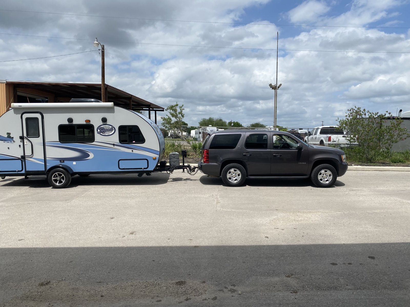

I did not know it was an XFE model! During the trip we got about 11.6mpg. This will pretty much be the tow setup for the next couple of years. We are looking at the Grand Design 22RBE models the GWVR on those is 6995 which I think is gonna be beyond what I want to take this Tahoe up to so we'd be looking at a new tow vehicle for that. I would like to keep this running good for as long as possible because I really dig this truck.
Also here's a pic of it hooked up. That little bit of sag is there even when not towing hence the new shocks and maybe air bags to get it more level.

Love the color, looks to be in great condition too! To cut down on wind resistance, those were lowered in the rear like the cop cars and their spare is aluminum as are the lower control arms up front and of course the LC9 engine is all aluminum as well.
Does she deliver 21-23 mpg on the highway unladen?
While the drivetrain can handle a lot more weight the cooling system and gears limits the tow capacity to 5400 pounds. Adding 3.42 gears and putting in the transmission cooler, engine oil cooler and 700 watt cooling fans ups the towing capacity to 8,400 pounds.
Having said that, a lot of folks don't like towing with the short wheelbase at those weights or really it's the sail area of the larger trailers. Get a Suburban or a Crew Cab Silverado with the NHT package and it will pull the future trailer like it's not even back there.
