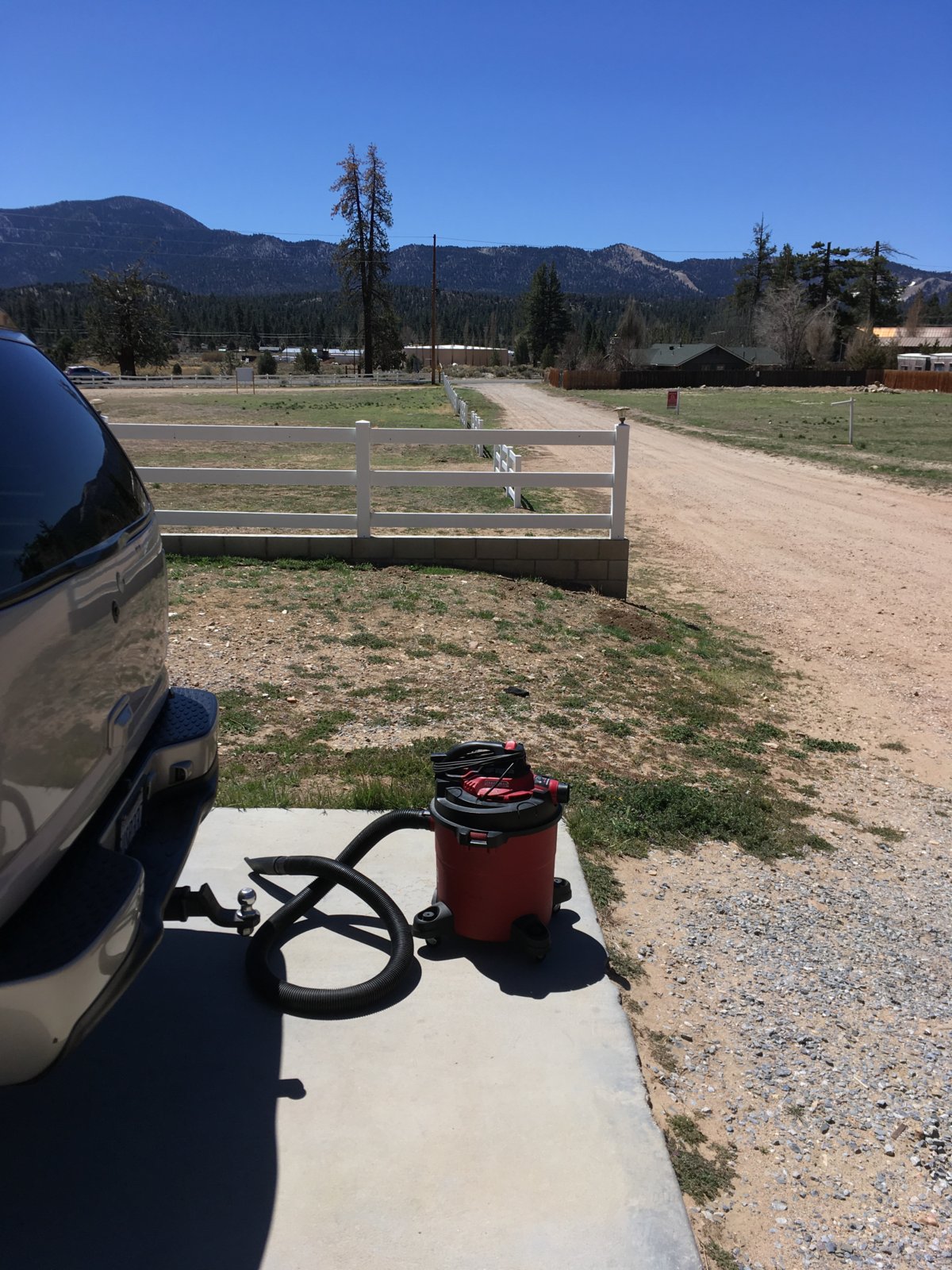

Well I live down a short half gravel half dirt road off the main north side highway. Lol. So yeah I drive slowly on dirt roads. Yeah I have wide angle tips for the pressure washer. There was some nasty crap coming out underneath.... I had no idea.
My short dirt road:
