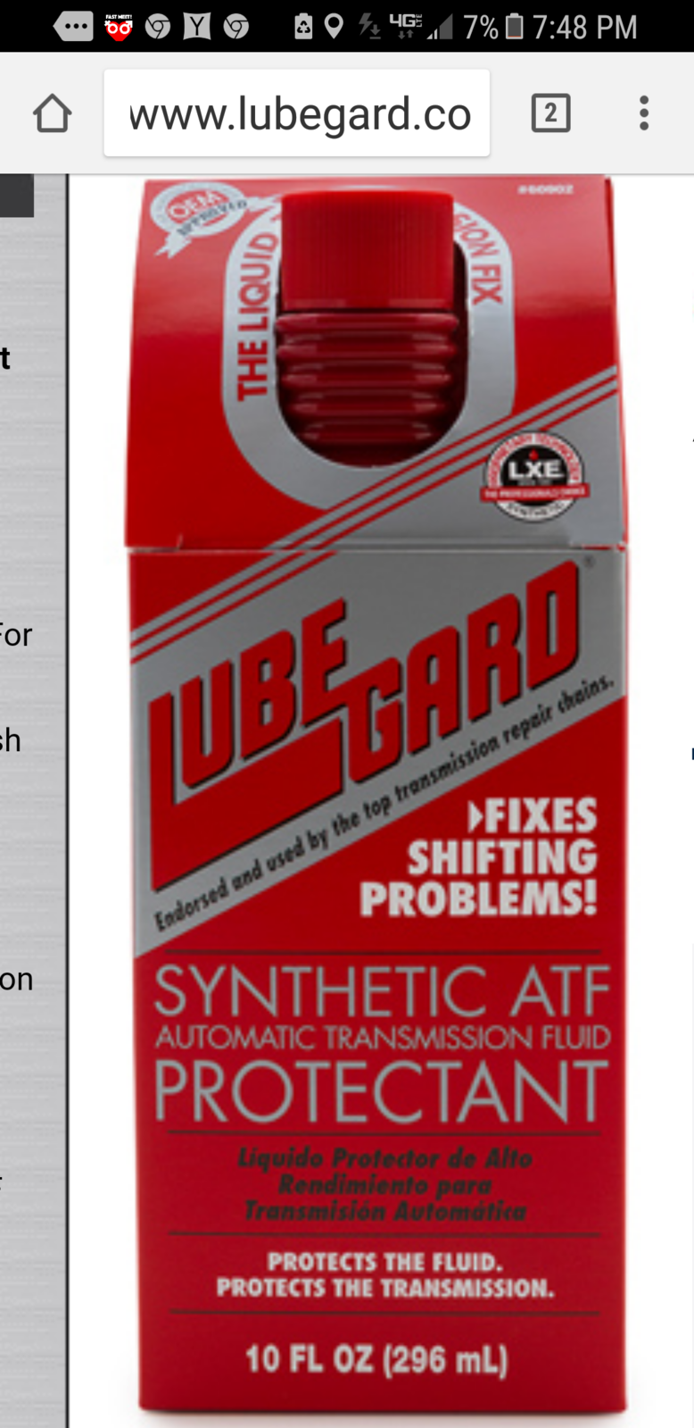

I don't know if I mentioned it before, but in between the first shudder dose and the second dose, I put Lubeguard synthetic transmission additive. http://www.lubegard.com/~/C-113/LUBEGARD+Platinum+High+Performance+ATF+Protectant this maybe worked along side the shudder fix to help me out with mine.

Just to confirm, you added the version below? How much did you add? This seems to be a protector, not just ATF fluid. A quart would definitely put me past the full mark so just wondering best way to add....
PLATINUM® High Performance Automatic Transmission Fluid (ATF) Protectant with LXE® & SYNERGOL® Technology

Its only 10ounces not a quart. Full synthetic, compatible with Dexon VI, which our suv takes. I used the whole bottle. My downshifting became smoother and quicker. When feathering accelerator, it used to shudder when bogging....now it downshifts and kicks up rpm to eliminate the bog/shudder danger zone.

Thanks, This will definitely be my next step.
I've read reviews where people use this on brand new cars as insurance for transmission longevity....in other words, it's good to add this weather or not to help a transmission fix or just to fortify the fluid....It helped in my case...good luck...

I just added last week and it helped. I still can feel some shudder but very rare. I recommend this over the shudder fixx
