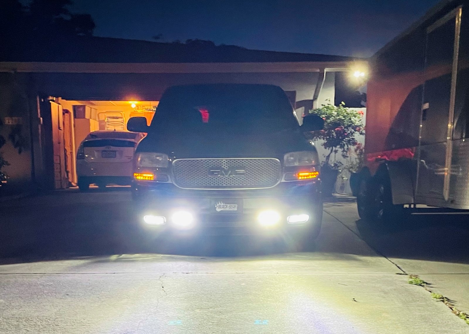

I ended up going with the Sealight Laxmas LED 880, 6000 Lumen, 6000K replacement lamps for my stock fog housings. I chose them because of the good reviews and I wanted a fanless plug-n-play lamp. I'm pretty happy with the brightness and color. As you can see in the photo, I also have a set of 7" light bars in the center slots of the valance. These are 240w, 24,000 Lumen, off-road logs and they are very bright. So the Sealights don't compare in lumens, but they are plenty bright for my needs. And if I need more, I can just flip on the off-road lights and have 30,000 lumens between the two sets. Clocking them to the reflectors was easy and installation only took 5-minutes. I had no flickering or issues caused by the lower wattage.

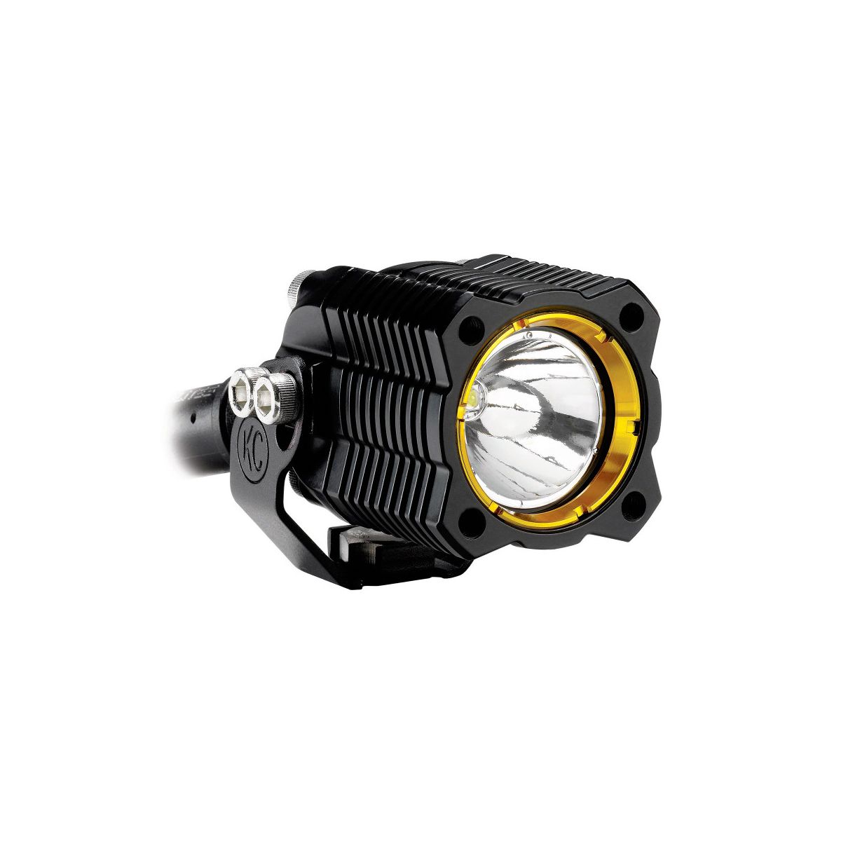

Hate to break your heart but I'm switching to the z71 valence like all the other cool kids. I've done a ton of measuring and actually have a few different size/style rectangular lights but I don't think anything will have the OEM+ look I'm going for. They just made the hole too weird of a size so everything has to be pointed sideways to look like it fits flush but then the beam pattern is way off. I was considering cutting the back off of the factory lights and putting a KC highlights flex, which is the smallest all in one sealed light I could find. But I think the pattern would look weird being shined through a chopped up reflector housing not to mention my reasoning for replacing the factory lights is that they constantly get full of water, which will only get worse if I cut the entire back off.

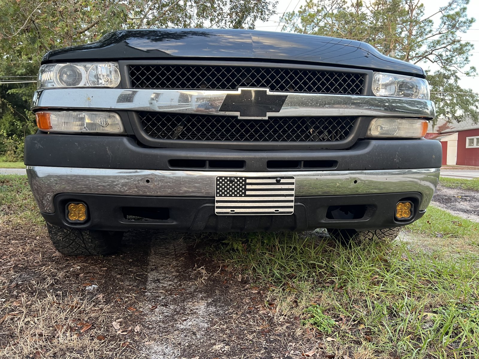

I did get the fogs mounted better and I think they came out really clean. They almost look OEM using the trim piece from the 07-14 Tahoe fog kit Diode Dynamics sells and the factory Z71 brackets I cut off a cheap set of replacement fogs.
I do have a 12" Driving pattern bar I'm test fitting in a few areas to see if I can come up with something that doesn't look "rice" but will provide extra light in Hibeam driving scenarios.
