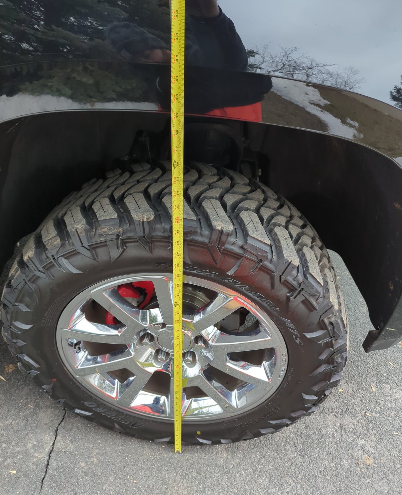

F 21 3/4”
R 23 1/8”
This is with border patrol rear suburban springs. Ads coilovers and 600# springs.
I May lift the front a bit. I need to see how much shock shaft is showing in the front .

These are not the actually measurements in the pic. I just couldn’t hold the camera and tape measure at the same time. But it shows what I’m talking about for measurements.

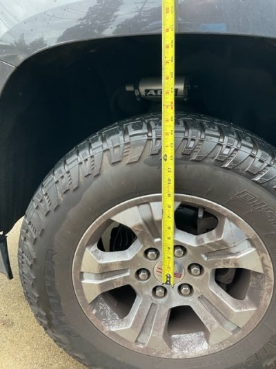

Arnott with a 1.5” level and stock rear Yukon Xl Denali springs.
Vs
Ads coilovers and border patrol suburban rear springs

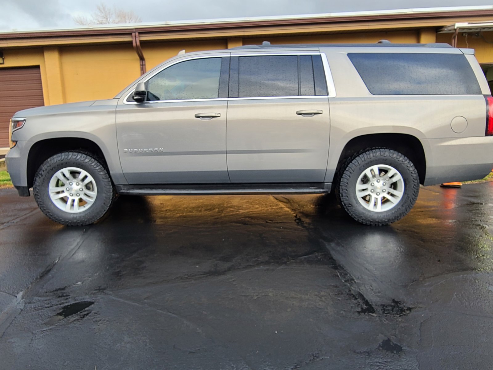

Bilstein 5100 front adjustable height shocks at highest setting (1.75-2" depending on different sources), no rear lift. 275/70R18, 33.2" nominal size Cooper Discoverer ATPII. No rubbing noticed so far. I have before measurements, need to officially record after, but quick comparison measurement had my front fender about 3/8-1/2" lower from ground than rear, and front fender about 1/4-3/8" less distance from tire than rear, ie. the slightest/perfect forward rake still.
The picture is a little deceiving on the front tire, looks closer to rubbing on rear of the front fender than it is because the (steering) wheel is angled slightly left.
