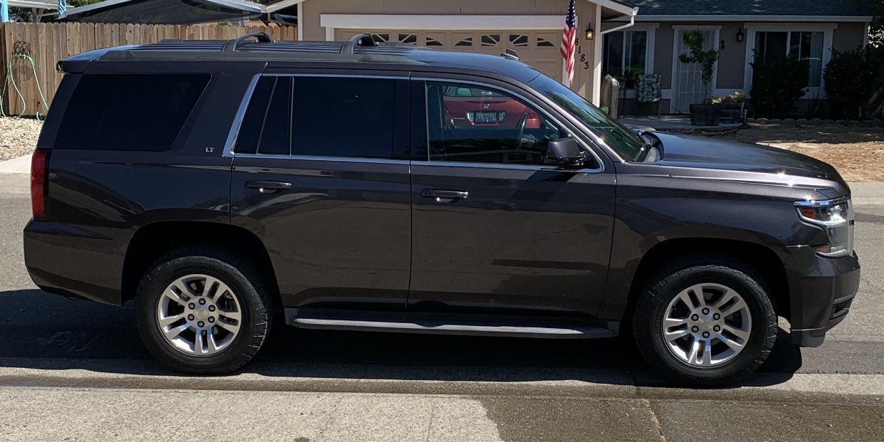

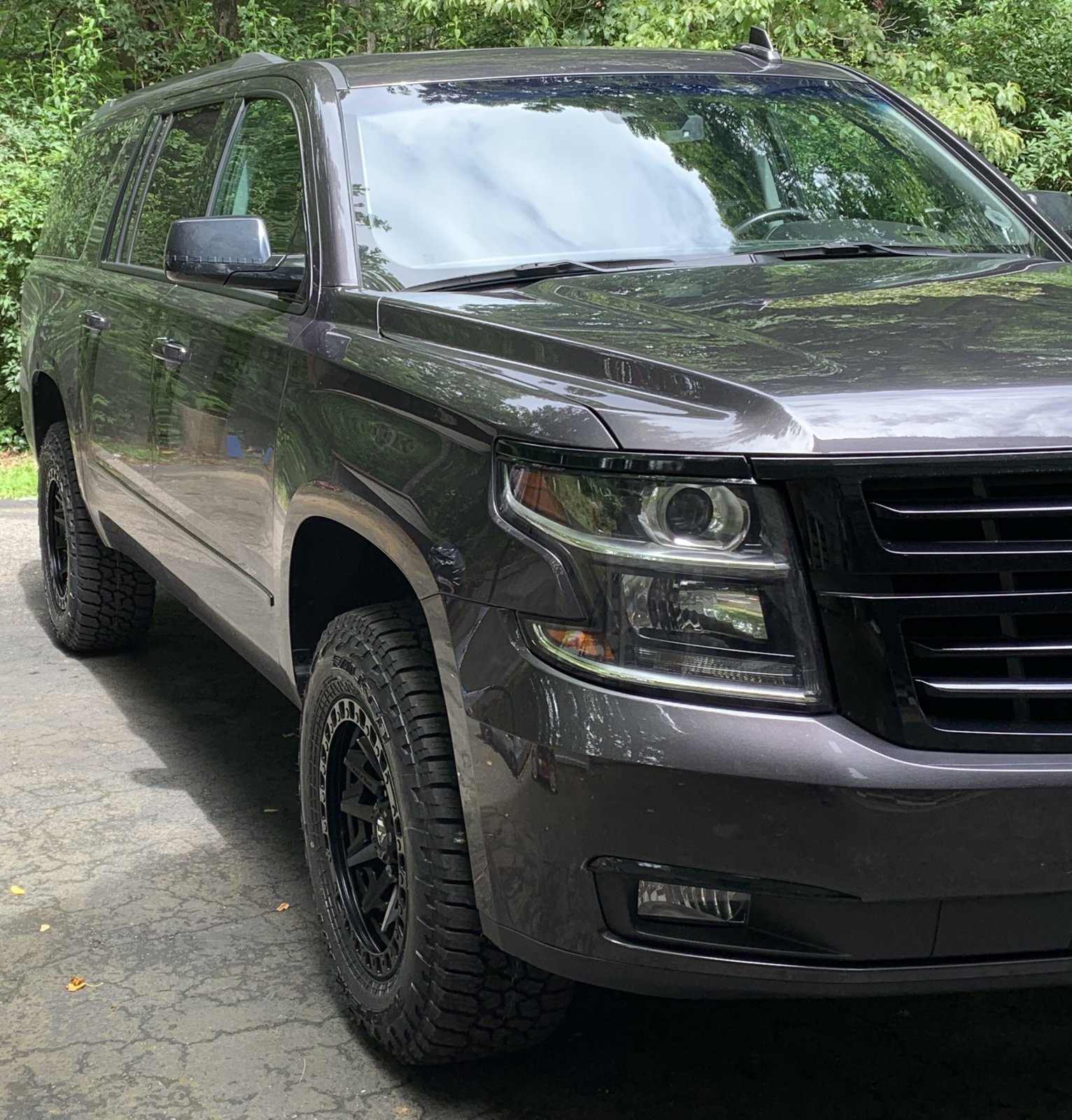

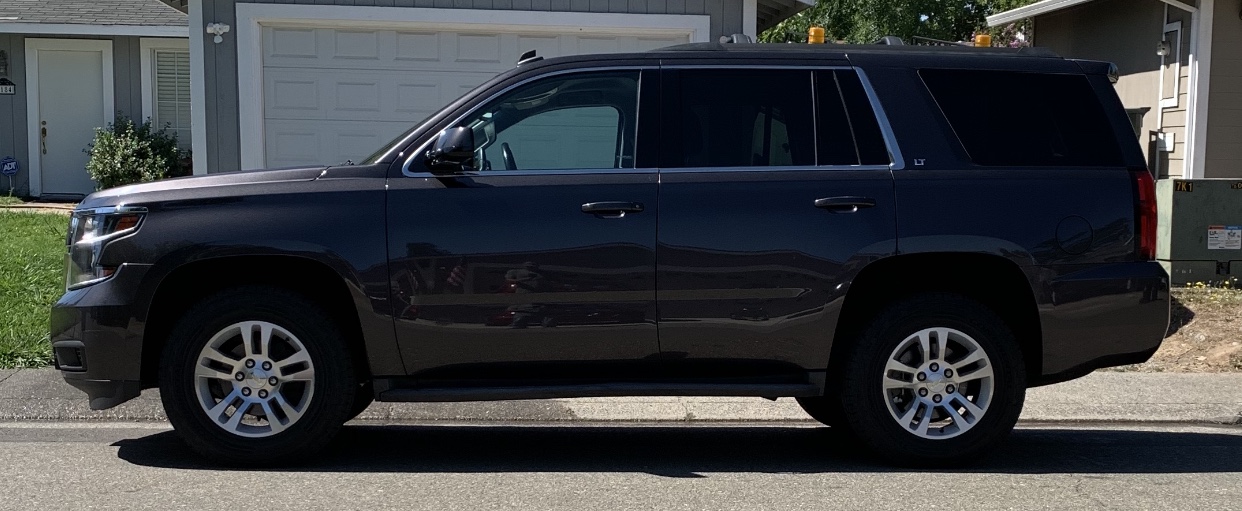

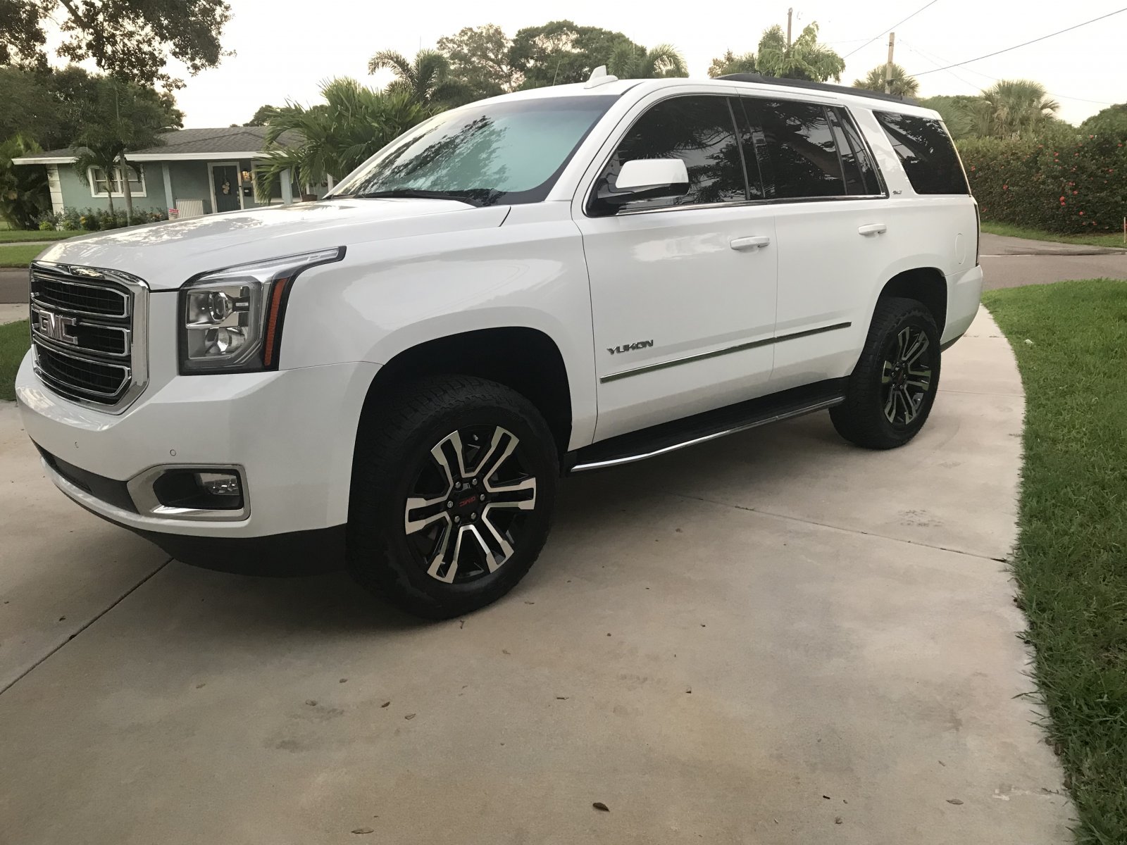

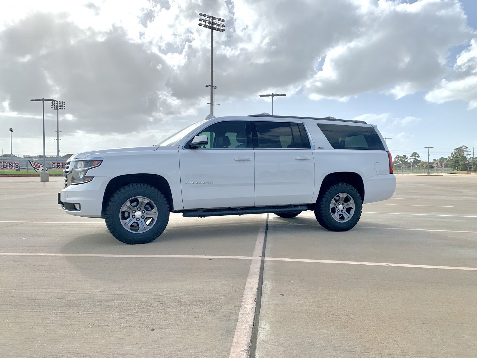

Pictures are a little deceiving as the concrete is sloped down. Covid and backorders made things fun for sure. Happy so far.
Bilstein 5100 (3rd ring 1.25”)
BFG KO2s 275/70R18
Fenders (before):
Driver Front 35.25, Driver Rear 38
Passenger Front 35.5, Driver Rear 38
Fenders (after):
Driver Front 37.5, Driver Rear 39
Passenger Front 37.75, Passenger Rear 39
So far no rub. OE wheels and even stock tires are super close to the UCA at full lock, if these rub it will be very minimal.

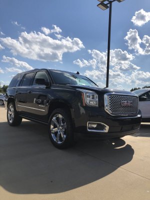

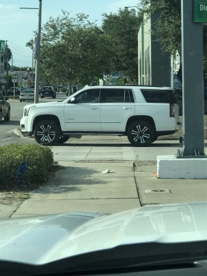

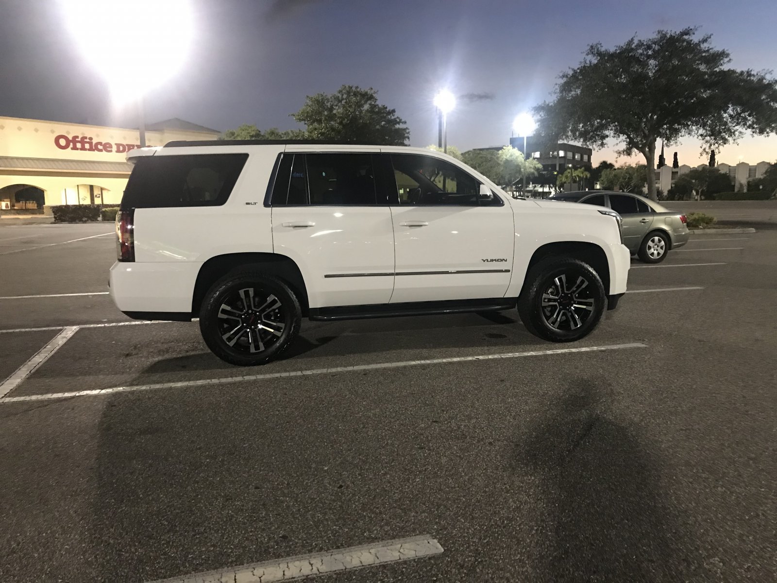

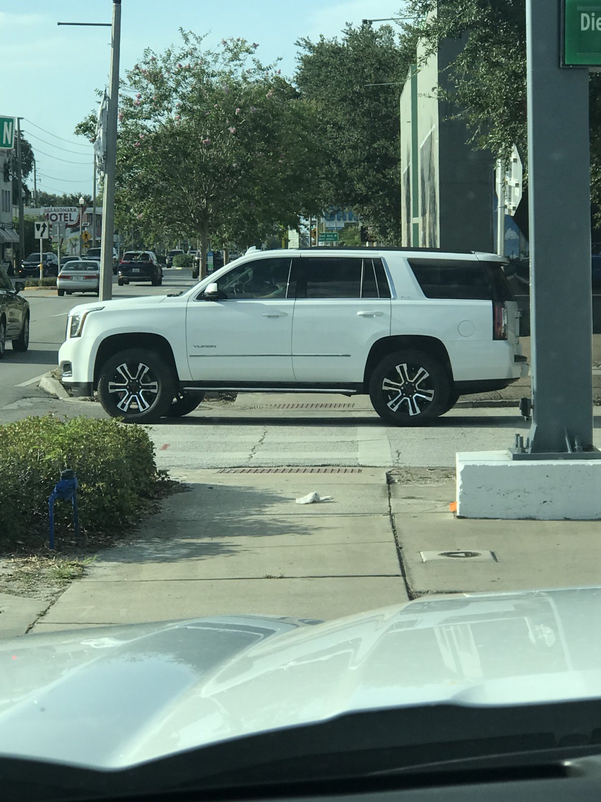

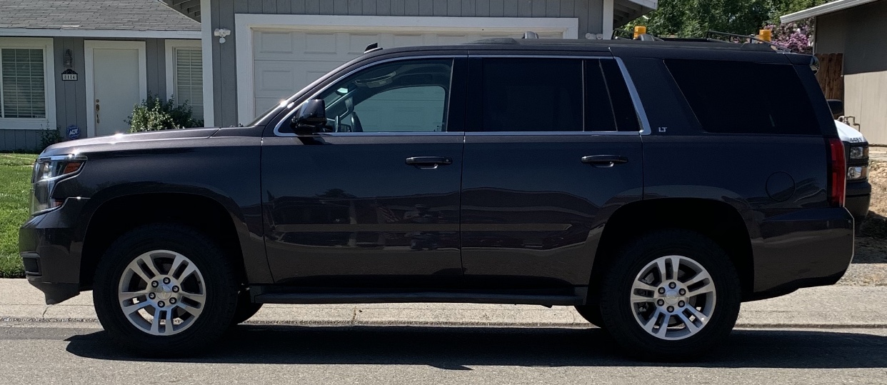

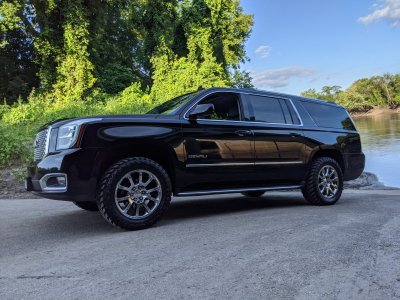

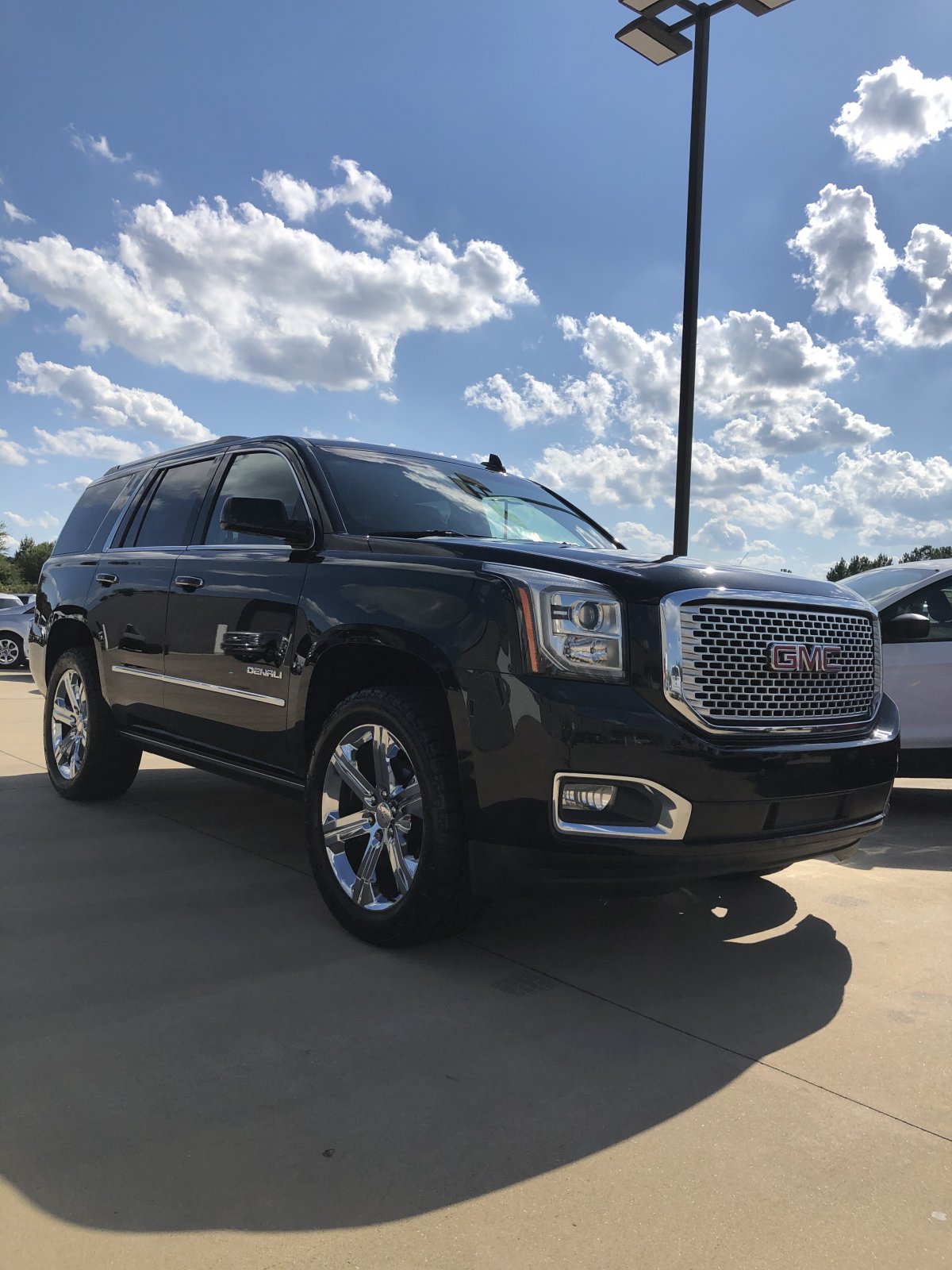

Sold the silver for the Denali. Leveled it out and Kept the wheels and tires. 285/50/22 Nitto G2’s.
Nice! I put 45 series g2’s on my wifes denali and they have been absolutely flawless. Shes got over 60k miles on them now and they are still in pretty good condition. I am thinking of going with the 50 series next go round. Did you use anything to mess with the tire size change, or did you just leave the computer alone? Also, did you notice any negatives moving to an e rated tire that is 12 pounds heavier that the xl stock size tire?

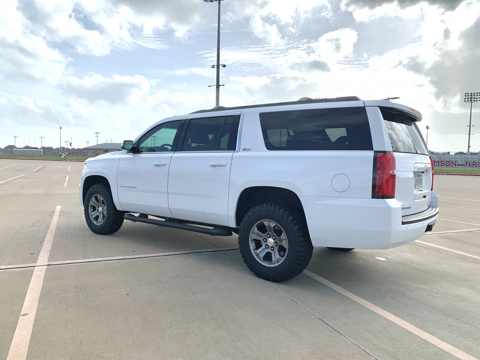

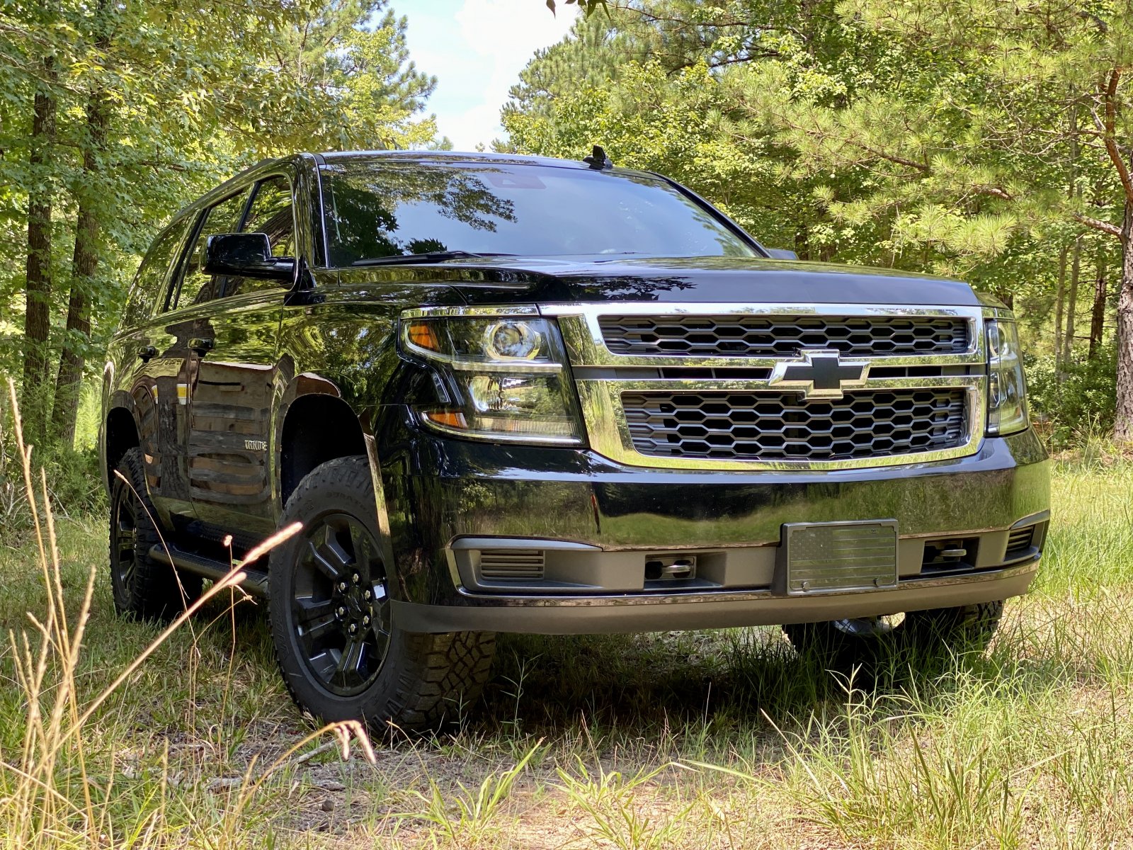

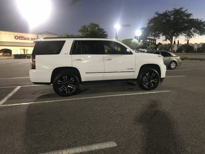

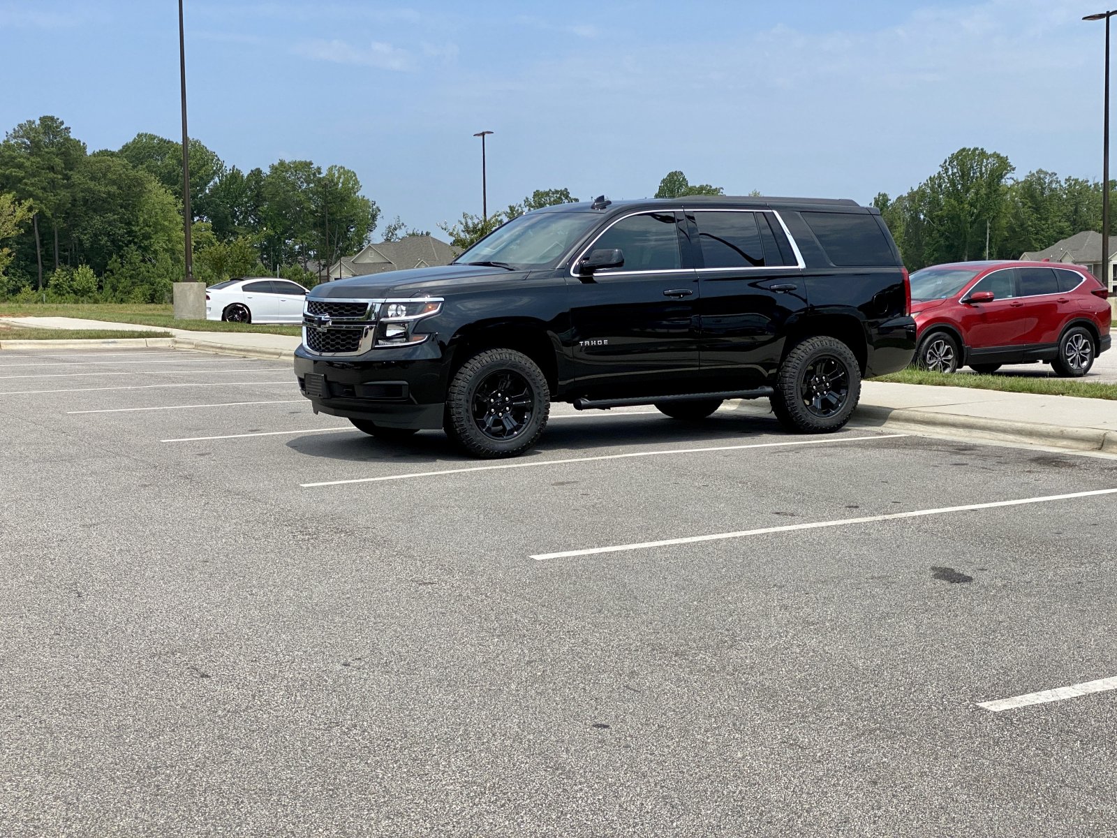

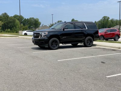

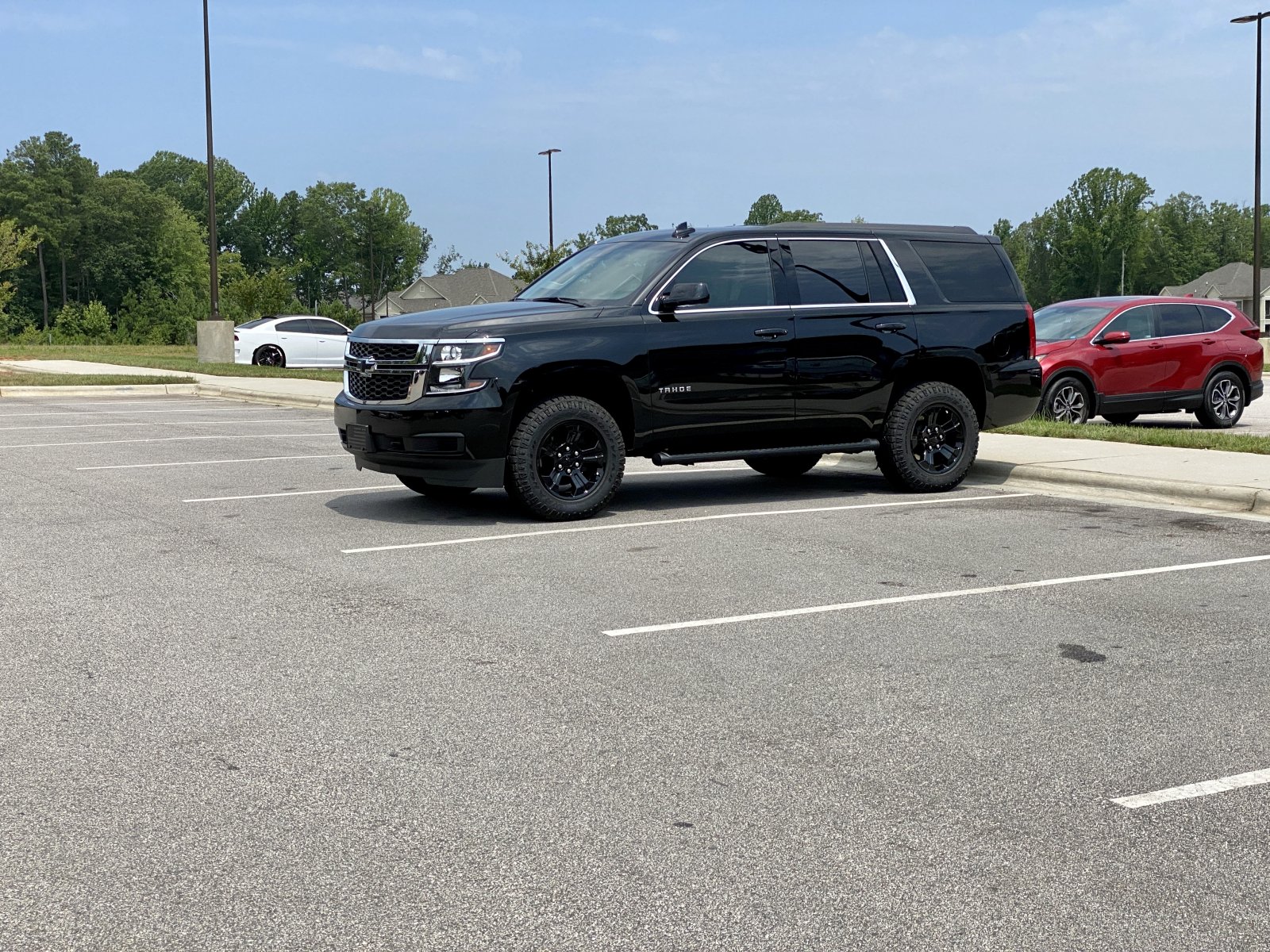

2019 LS 4x4 Custom Midnight, 1.5" front level. I cant stand a nose high truck so played it safe with the 1.5" looks perfect for me.
What brand leveling kit did you use? I want to level ours as well, plus trim down the front airdam. I'm probably due for shocks as well. Hoping to add skid plates asap as well.

I used the maxracing 1.5" kit off amazon. If you are planning on replacing the shocks, you're better off just getting the Bilstien 5100's as they are height adjustable. If my truck wasnt brand new thats what I would have done (its what I did on my Ram) Also trimmed the front air dam.

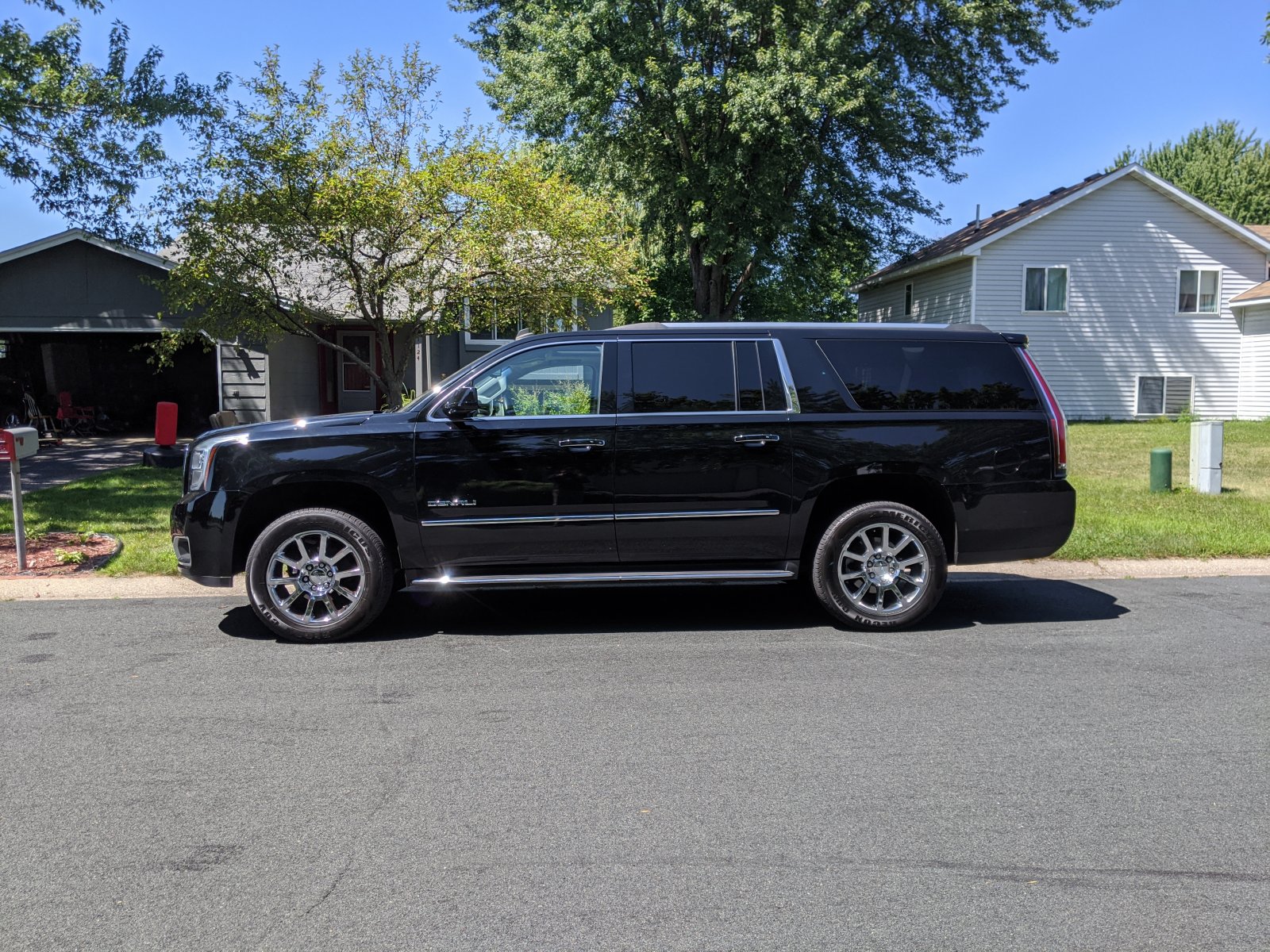

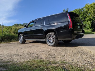

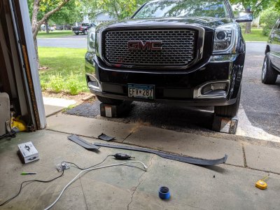

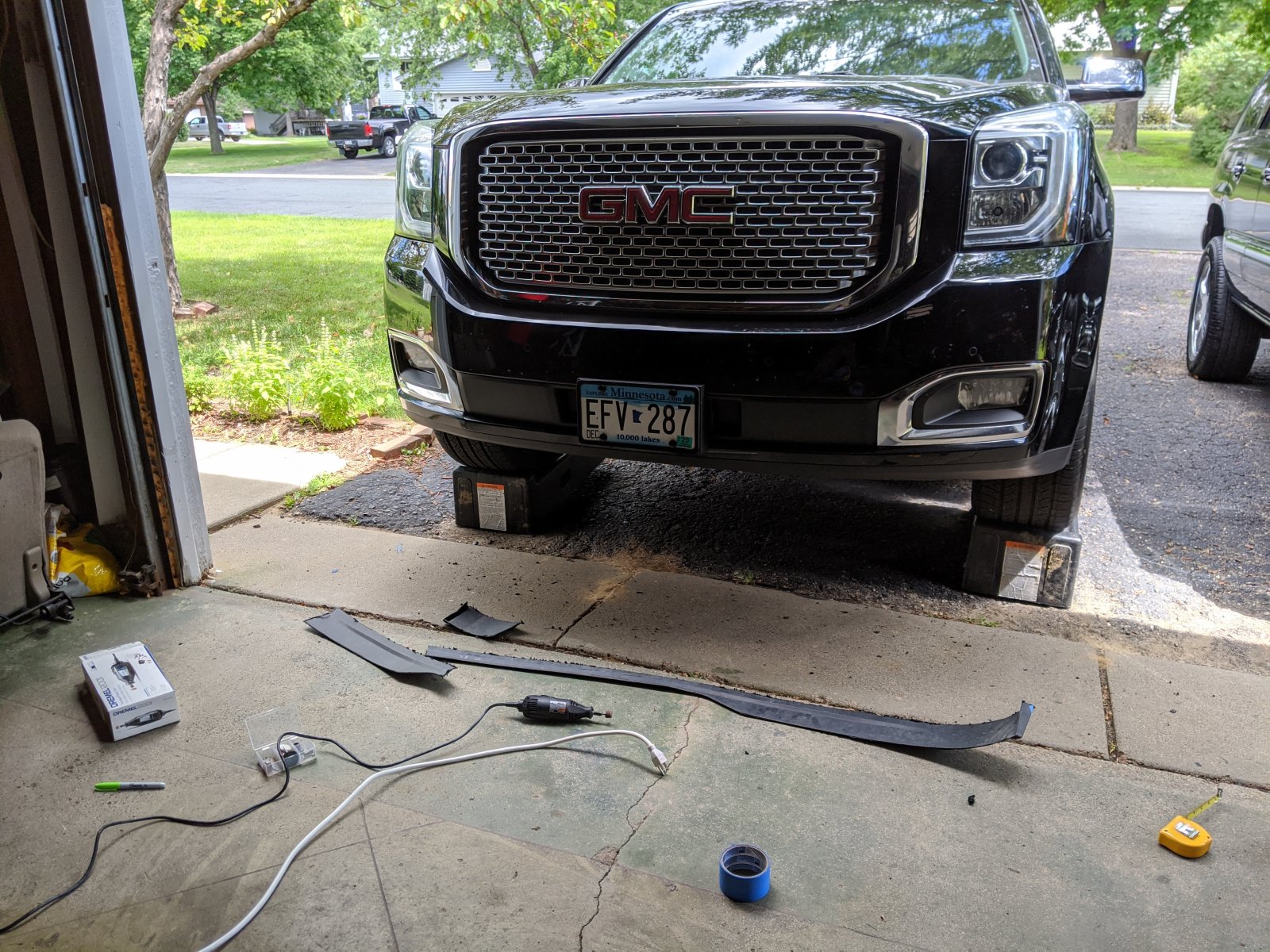

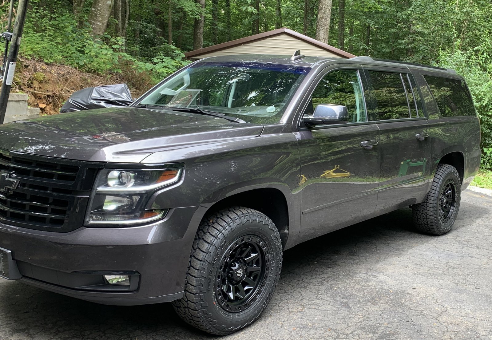

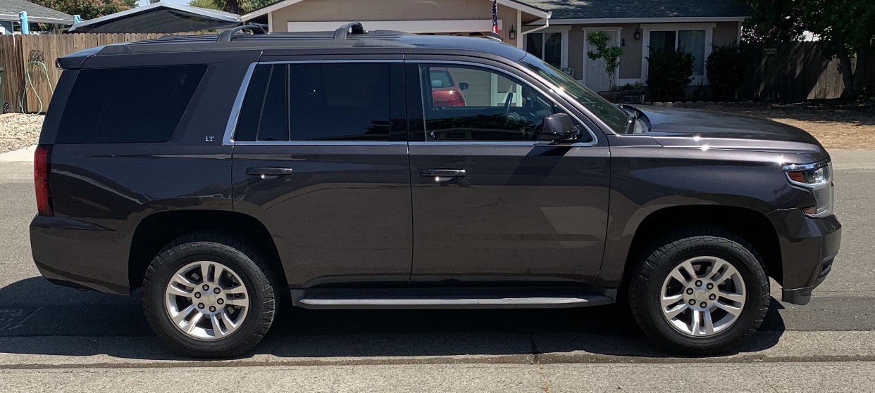

Thanks brother. Just popped the front wheels off. Went with the suspension max for the mag ride since they're still going strong.
Hoping to get 1.75" up front tonight if possible, then I can get the atturos on and aligned.
Running the 5100s in my Tahoe and they're firmer than I'd like. Haven't tried them on a coilover yet. You like em compared to mag-ride? I like the how mag ride handles on this XL
Trimmed the front air dam over lunch freehand. Liking the extra clearance a lot

Trimming the airdam makes such a huge difference. I'm going to cut mine down this weekend as well.

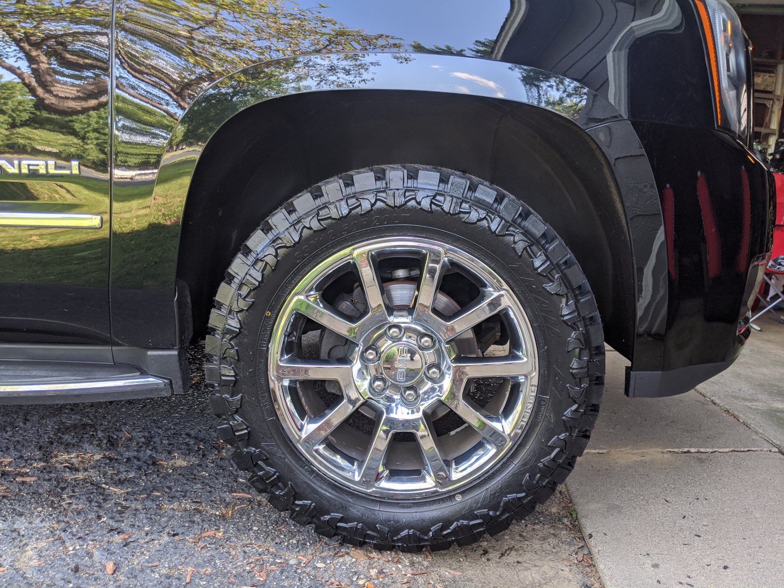

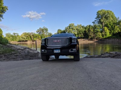

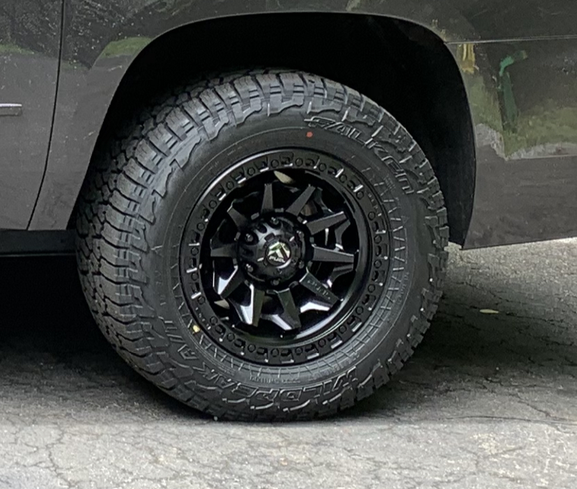

Most difficult part was the connectors for the magnetic ride control sensors. Had to use an angled pliers to try get them back together. Had my 6y/o hang on a short pry bar to slip in the lower strut spacers in. Decent stance on the 1.75". Next is alignment and tires mount/balance.
33x12.5 mounted and balanced. Haven't had a chance to put'er through the paces in reverse yet.
