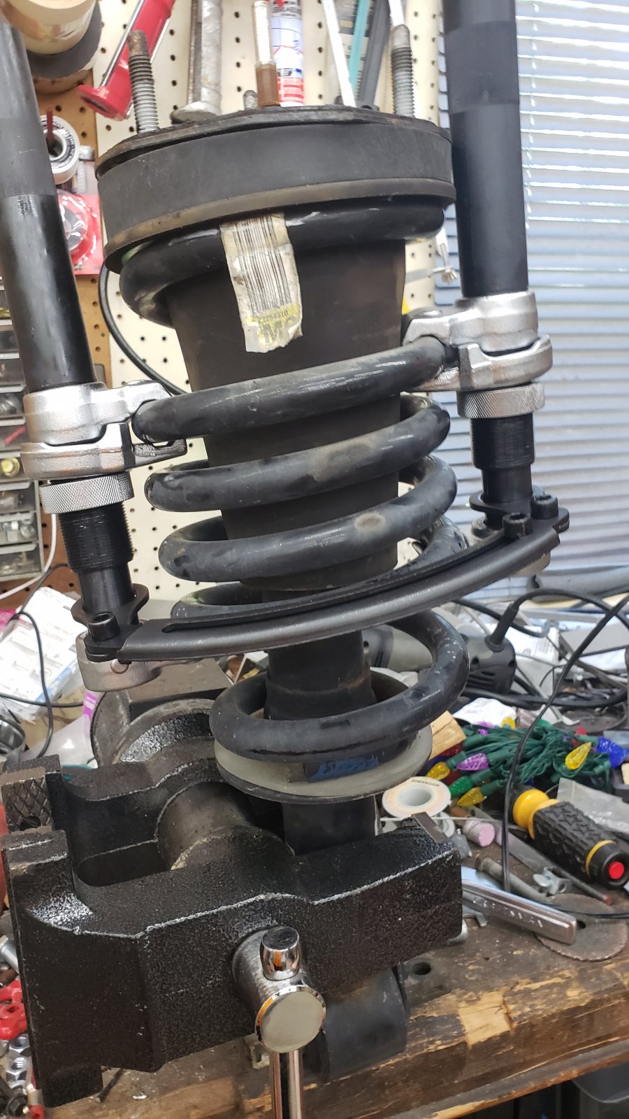

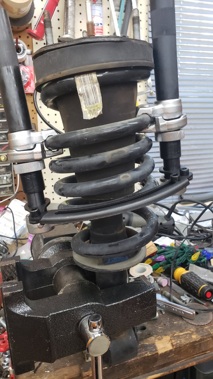

Definitely don't use those Harbor Freight ones linked above. They aren't heavy duty enough for truck springs.
When I did mine, I put the strut in my bench vise and used a spring compressor kit like this from Amazon
BILITOOLS 2-Piece Coil Spring Compressor Tool Heavy Duty Macpherson Strut Spring Compressor Set with Safety Jaws and Holder, Max Load.2645LB https://a.co/d/81a7xqC
My god, I got PTSD looking at that setup. And I even can vouch I used a similar setup in my days as a BMW tech, but that style is a literal YOLO.....gigantic shrapnel grenade.
Which setup is that?
Those thin Harbor Freight one's will bend and those little pins that are supposed to hold the spring in the hook only fit smaller diameter springs.
The one I used is much more beefier and has a safety ring that connects to both sides and keeps them from rotating on the spring and spreading apart. The hooks that go around the spring also clamp down onto it using a lock ring.
I took precaution when using it, but everything went fine and nothing appeared to bend, stretch, loosen, and all felt pretty solid.
For the occasional use (like once every 100k miles) I'm comfortable with, but if I needed it for shop use I'd want either a Wall mounted or floor mounted unit.

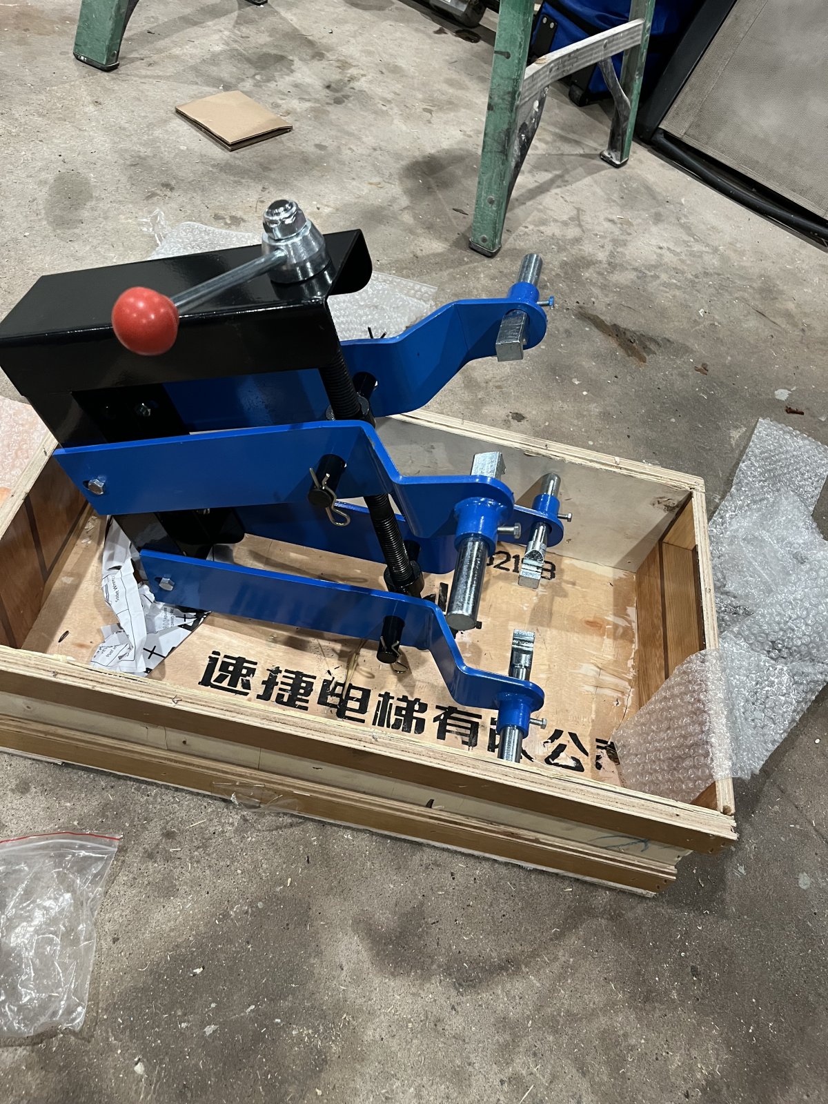

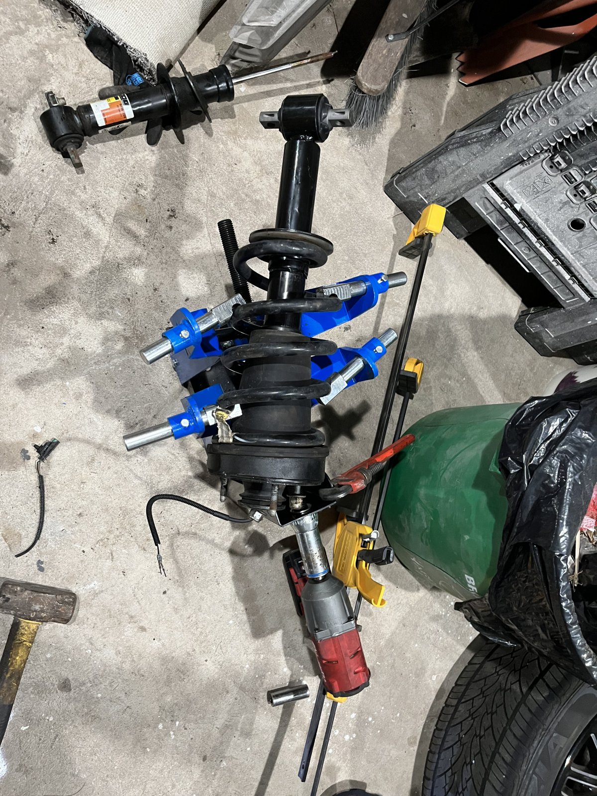

I found a venvor floor standing spring compressor on market place for 60$ but it’s got some really dicey reviews using it with trucks springs…
I have that compressor. Can confirm that it’s a total POS for truck springs.
Edit added picture. It looks heavy duty but The whole thing was twisting. The dewalt wood clamps did a better job…..
View attachment 415842View attachment 415843
lol wow. It’s kind of entertaining reading all the different spring compressor reviews on Amazon lol. I ended up finding a suspension shop that caters to big rig and larger commercial trucks to do it for 120$ but I also ordered the compressor goofyguy recommended just in case if they called back with bad news. Luckily I was able to cancel the order before they shipped it out. I’m glad that’s over with…
