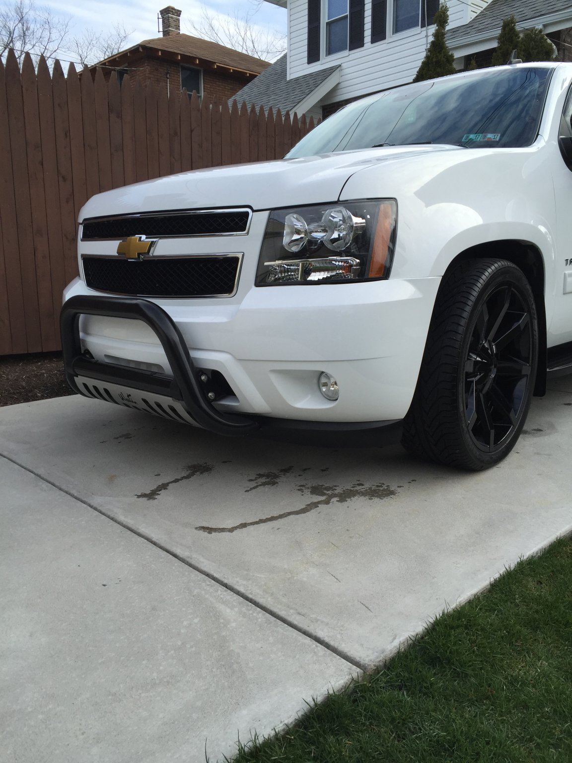

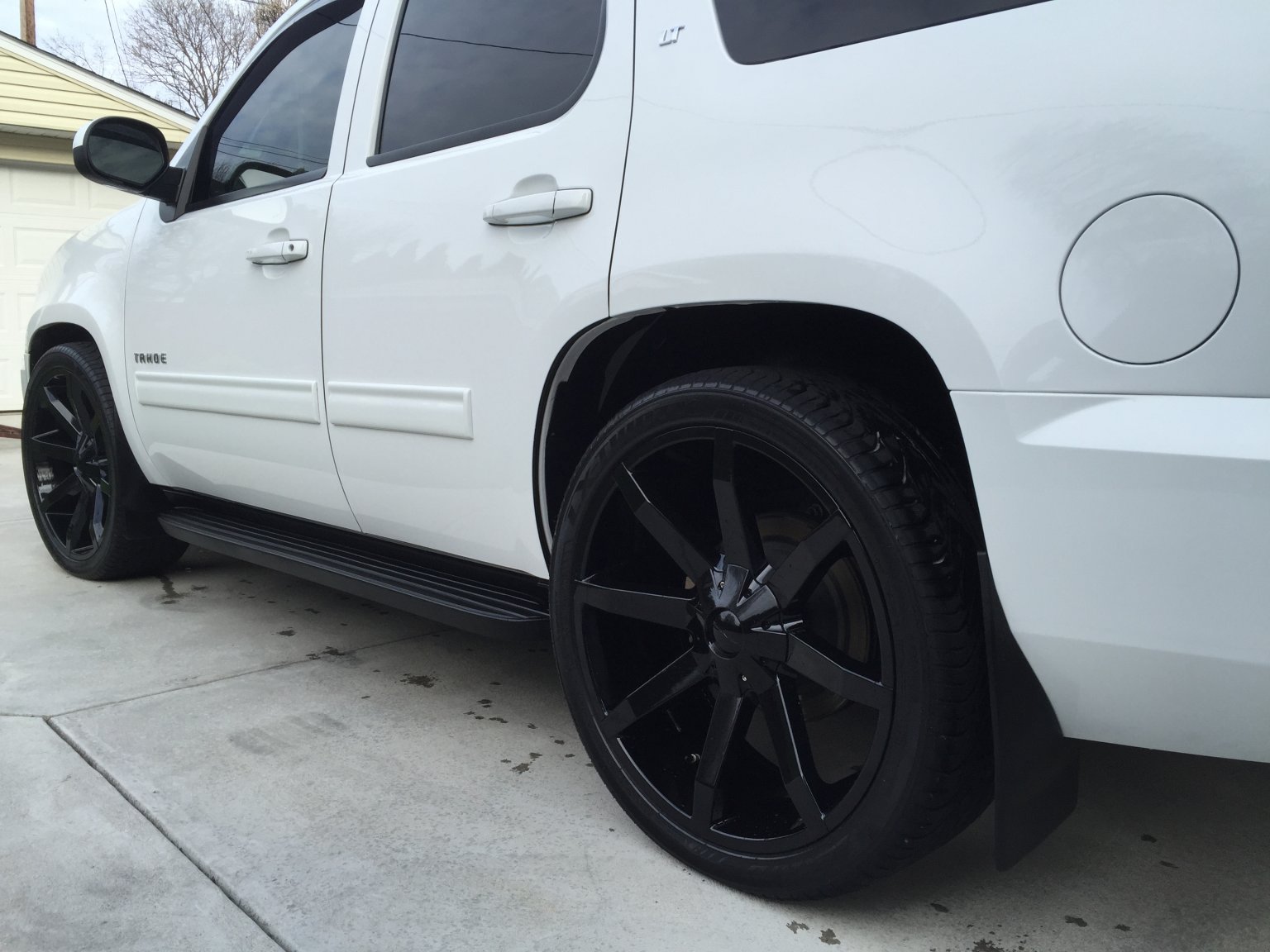

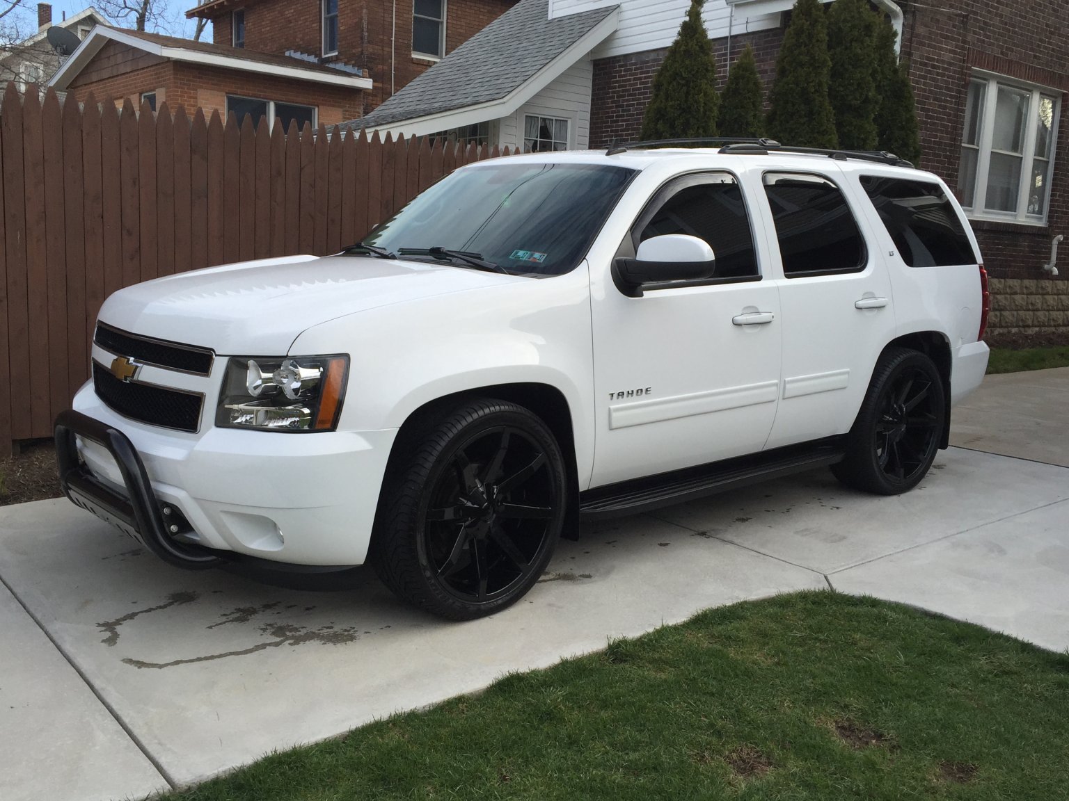

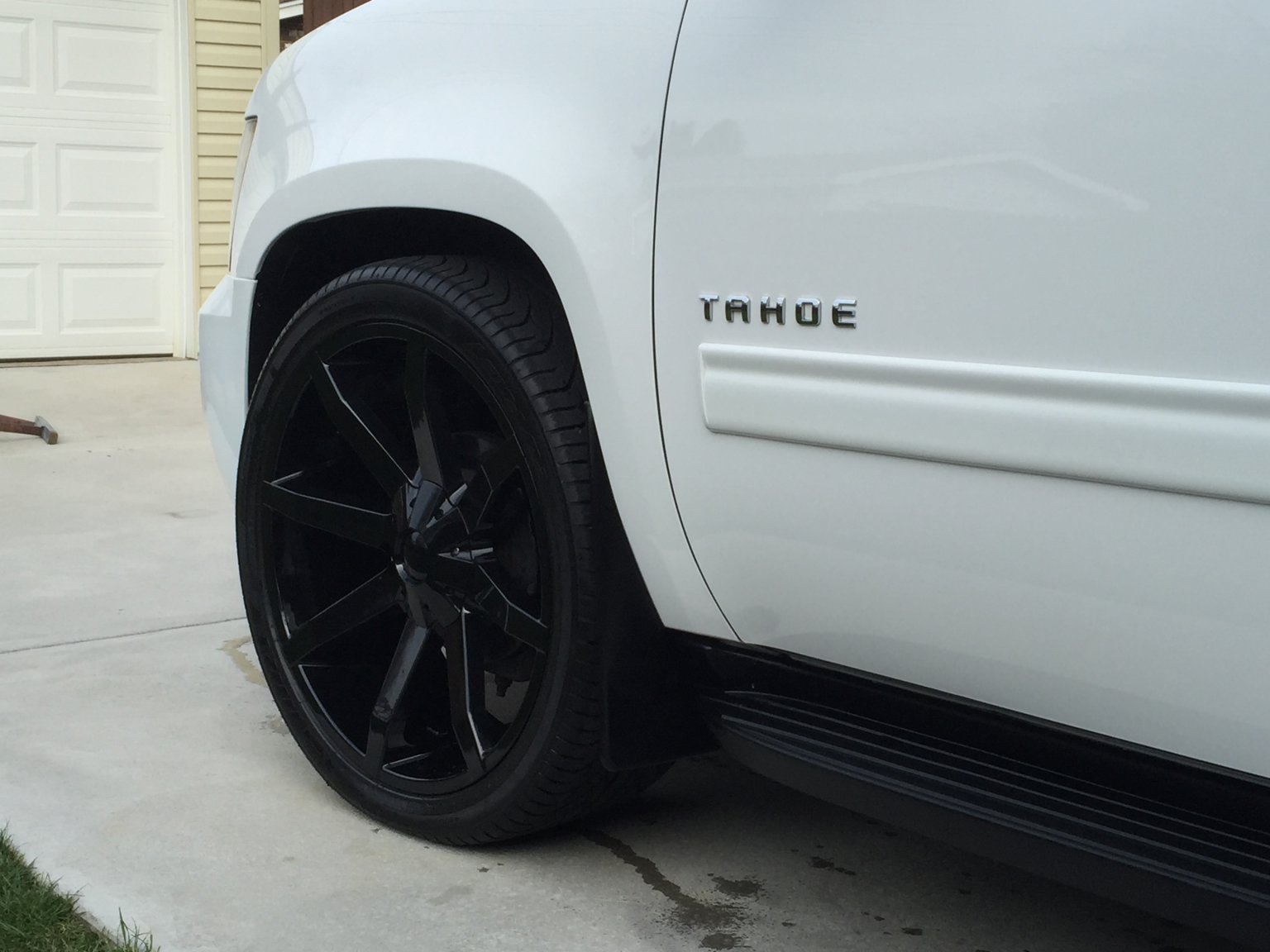

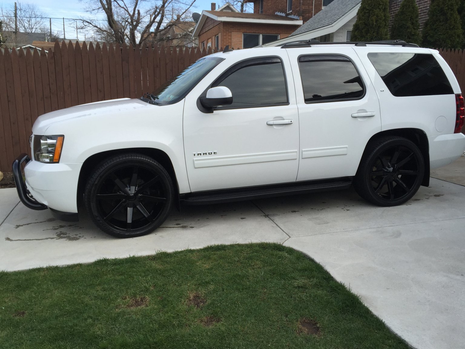

It's a 2/3 drop but I ended up lifting back up another inch with 2" spacer. The 2/3 kit from Tony comes with the 3 or 4" drop coil for the rear. Adding a 1" spacer gave it a 3" drop and it was level however I only had about 1/2" between the Belltech bumpstops (I didn't want to do the free travel mod) so I ended up taking out the 1" spacer and replacing it will a 2" which gave me much more travel in the rear and now the bumpstops have almost 2" of clearance.
With that said now it is a 2" drop both front and rear.
Running 305/35/24's and only rubbing I am getting is from the front Weathertech mudflaps but I ordered 295/35/24 tires and putting them on this week.
I am still up in the air about the bulbar myself. Gonna give it few more days before I make decision to keep or not.
