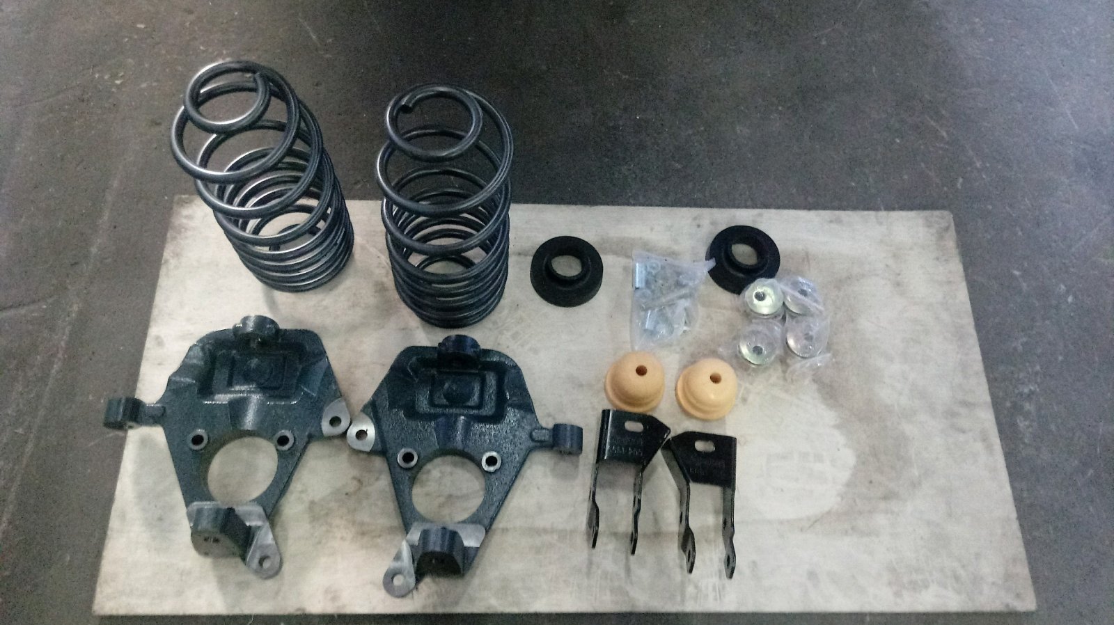

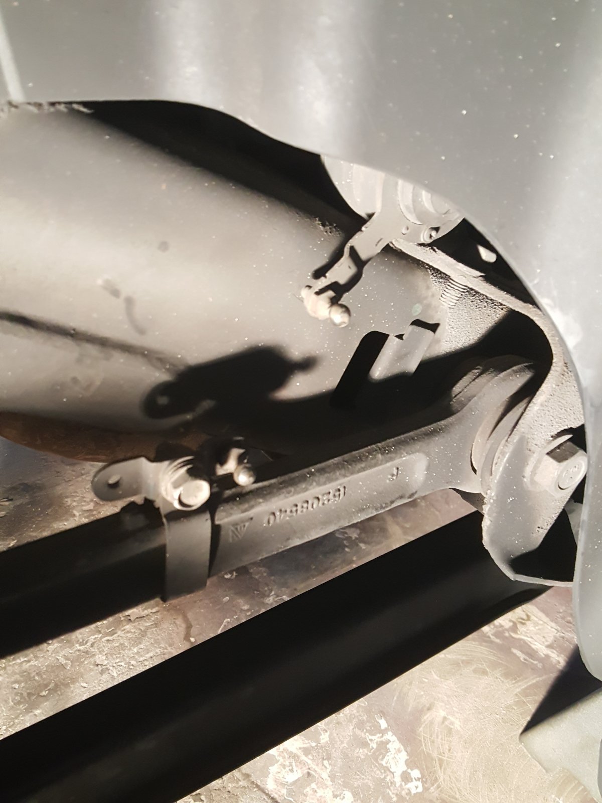

Belltech 753 2/4 drop. Put the shorter rods in. Worked for a week then pump stopped. I never went back into it.

Could be coincidence. How do the air bellows on the shocks look? You can disconnect the air line from them and shoot some air in with a blow gun if you have an air compressor.
Check all related fuses under the hood. There are two or three for the ALC. One is for the compressor, I think it's a 30A JCASE fuse (pink). The other is for the exhaust. Might say COMP EXH or something like that. If the fuse(s) is/are popped, the compressor either ran for too long (leak in the system) or locked up.
