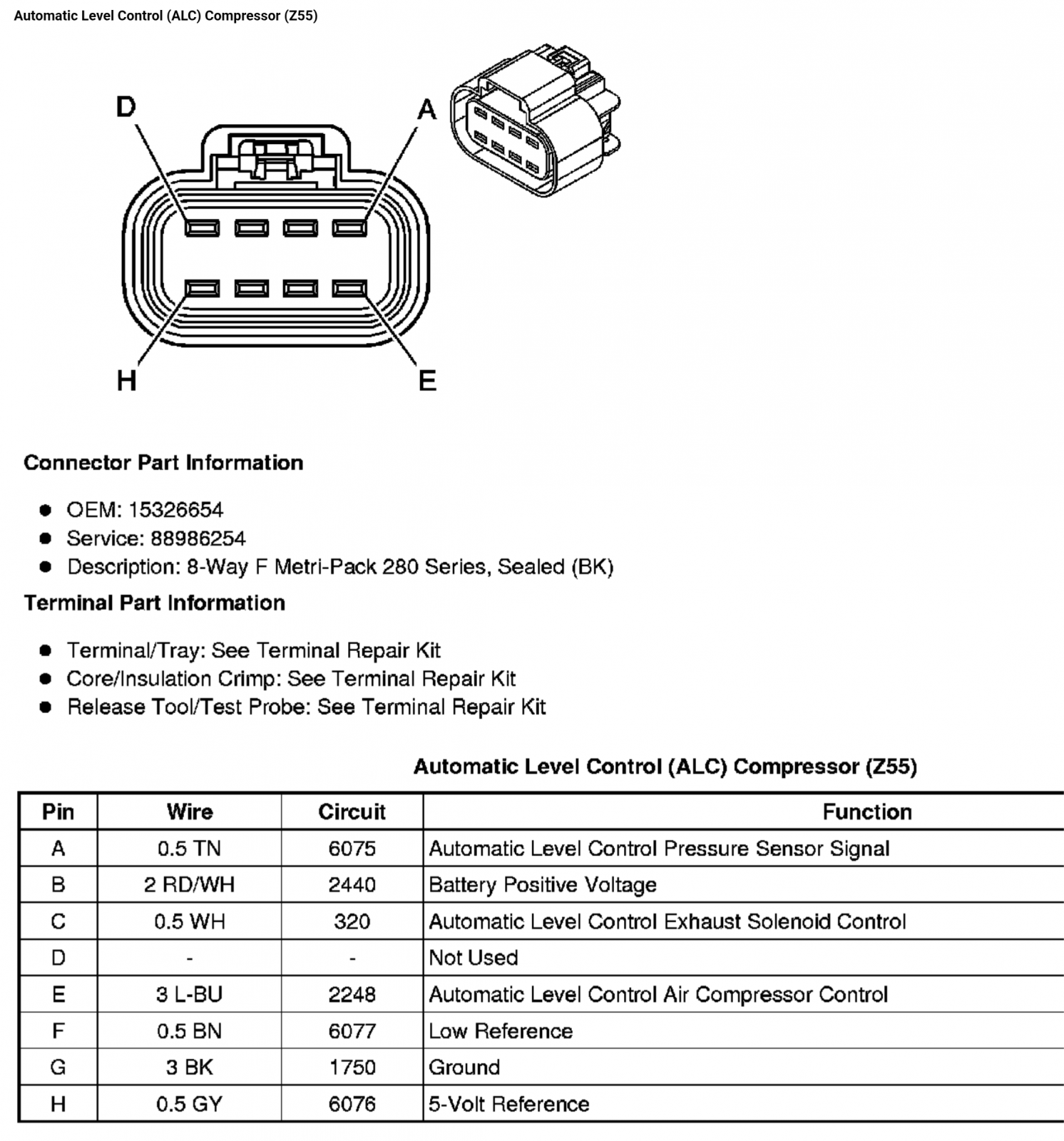

Hi, I am going thru the same process, but I am confused as to which 2 wires to put the resistor on. Can you please, say which wires?
TIA.
