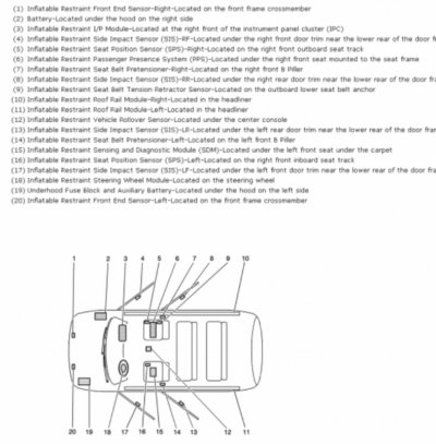

Where is the sensor located?
For the front sensors start on minute 2, there is two sensors.
The side door impact sensors are behind the door panels
