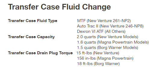

Jack it up, crawl under it, remove the fill plug and stick you finger in the hole. Fluid level should be just below the fill inlet. If it is not, put some fluid in.
I believe your transfer case takes DEXRON -VI ATF fluid, but double check your manual.
