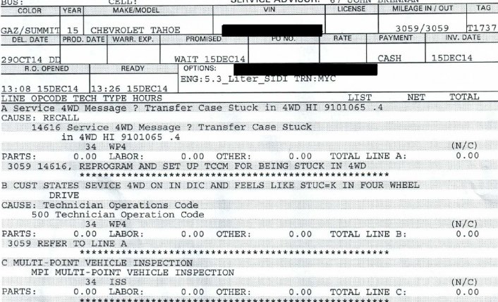

Quick in and out...Not sure how true it is but Service Advisor said that there are two different recalls in regards to the "Service 4WD" message...one where the person just gets the message and then another one where the vehicle actually gets stuck in 4WD Hi(mine). I have attached my service ticket for your reading pleasure...

Yep. Took mine today, was told of the recall. Hopefuly it gets fixed once and for all.

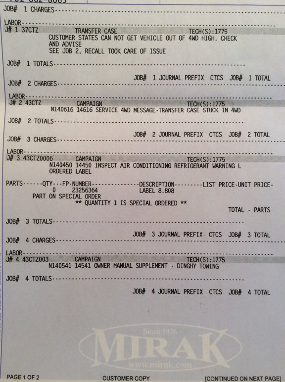

New to this thread but owe a lot of thanks to it. My car got stuck in 4wd with error indicator
coming on as well. Brought in this morning and they serviced it, as well as 2 other recalls under warranty. For everyone's benefit I can attach image of service order if someone can tell me how!
Sechal
Dec 20, 2014
Here's the service order
....and I should have mentioned that problem is resolved, at least for now
(2015 Chevy Tahoe LTZ)

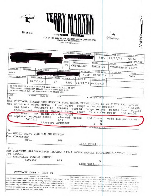

Well I finally think my Service 4WD is finally fixed. I took my 2015 Tahoe back in November for the 3rd time for the "Service 4WD" . I let them know I know of Arizona's Lemon Laws very well and this if they didn't get it right this time I would have them buy it back. They took 2 1/2 days before they called to say they finally fixed it. I had to wait for our next snow storm here in Flagstaff AZ which was New Years Eve to put it in Auto. Drove three days in a row leaving it in Auto the whole time. As as of today still no issues. I have attached the receipt of exactly what they did for a repair. Hope this will help anyone out there that still has the problem.:party36:
