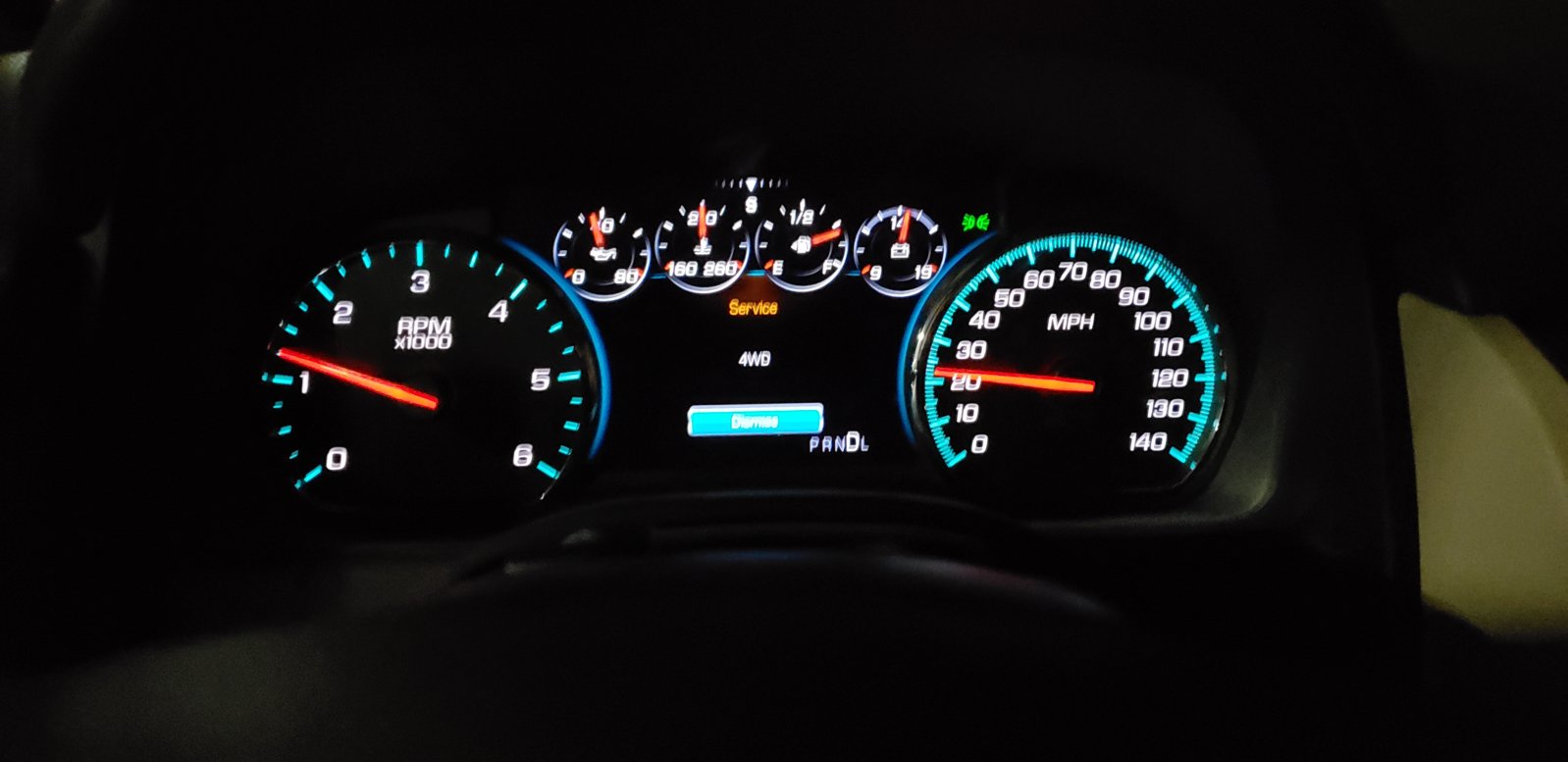

recently during afternoon down pours I stopped, selected park, changed to auto from 2H and expected the 4x4 light to come one. it did not, so selected 4H
still no 4x4 light. turned back to 2H and continued on my way.
and now the "service 4wd" notification..oh joy..
2016 Tahoe LTZ 5.3 / 6L80
where is this encoder motor?
