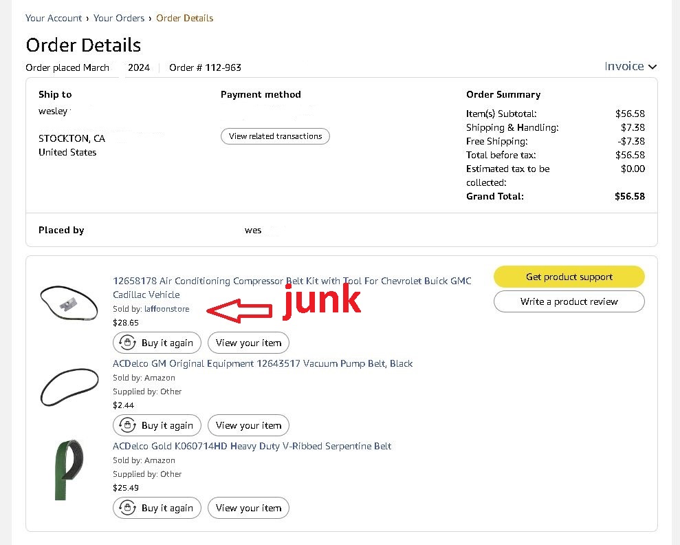

I bought these originally, the top one had a oem part number and a picture of a oem belt but was a bait & switch, crap belt that squeaked like hell
the Dayco I noted above is a quality alternative and can still be found for about $18-19.
I would have returned it but I bought these and then waited a couple months before installing so the return window was closed
