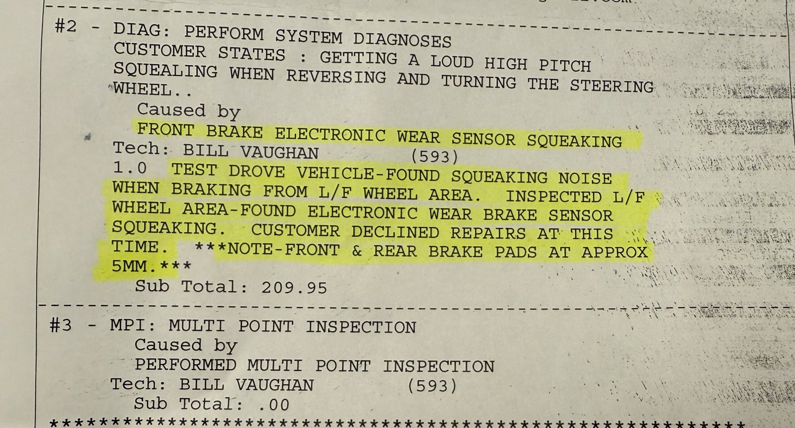

I just picked it up and this is what they gave me. I think they diagnosed the wrong thing. They drove it around and said the squeaking noise, when I told them to look for the chirping noise beneath the hood.

My vote is for a belt tensioner. But the brake booster sounds like something that needs to be checked as well.
