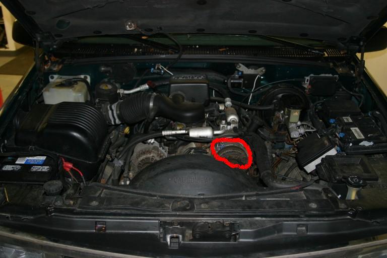

Anyway, This morning i started my truck after it had been sitting in the gym parking lot, And i heard a...not squeal, but almost like when you get rocks in a skatenoard bearing or something to that effect. So i popped open the hood and the sound is def coming from the belt or wheel(s). It seems to be coming mostly from the wheel thats closest to the hood and the computer. Any ideas? I sprayed it to see if it went away and it actually did. And still seems to be fine right now.

If it is just a squeal, then you are probably looking at a new belt. Belts dry out and will make noise on you. If it is driver side, top, that is the A/C compressor. Turn your A/C on and see if you hear the noise. Then turn it off and see if it goes away.
Merhaps if you took a picture and circled the pulley you feel the sound is coming from?

This one here

I believe that is the AC compressor. There should be a sticker or two in that tells you how to route the belt and what each component is.

Remove the belt and give everything a spin by hand. You should be able to tell what is not turning free. I have found, the rear bearing in the alternators to be the weakest link, on average. :)

Like others said. If it is definately coming from where you circled on your picture, then you are more than likely looking at A/C compressor bearings, maybe A/C clutch.
I would definately take TwinTT's advice and remove the belt, spin the pulleys by hand and see if you can pinpoint, may save yourself several hundred dollars if it isn't the A/C.

Thanks so much guys, I really appreciate it. Is this something i can drive around for a while without any serious damage? Because i really cant afford another couple hundred.

had the same problem .... a/c compressor .... cant rte a shorter belt cuz theres no pulley under it .... the have a a/c compressor by-pass bracket at auto zone for like $35.... just take the comptessor of and replace with bracket until u can afford a new compessor ....or hit da junk yard for a used one which would be around $35 -$40 dollars and if the used one is good thats a bonus , if it's not at least you won't have that annoying ass grinding sound

I'd just route a shorter belt around it, you'll be fine until you repair it. Just wont have A/C!!

wheels? you mean idlers/tensioners. in your picture your looking at the ac compressor. when i had my OBS the compressor was shot to shit and it was making the ugliest squeal in the world. before you condemn the compressor change the belt and while the belt is off as said above spin the tensioners and look for a bad one also check out the alternator they can be noisy when there on there way out

Yes that's the A/c compressor. I would install the A/c bypass kit till you save enough to get a new compressor and dryer.
