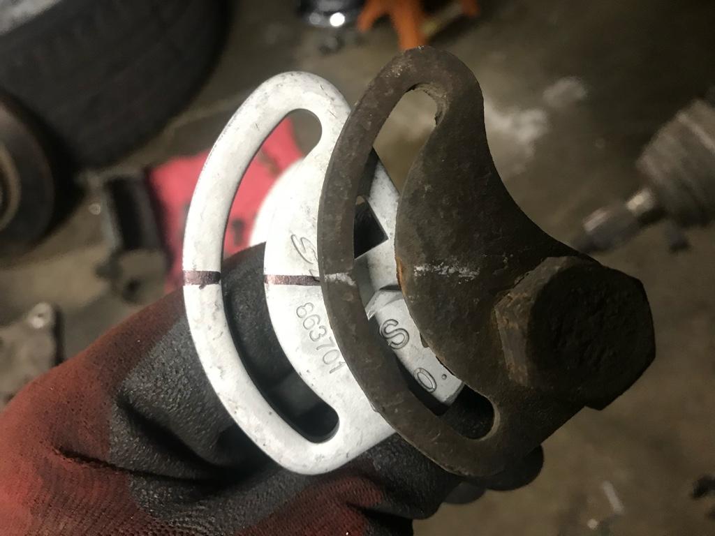

I agree with doing the complete arm. So much easier to R&R than to replace bushing and ball joint on OE arm. I replace them on my wife’s Esky with some from Rockauto. If they have these for your vehicle, I highly recommend. Good quality and perfect fit. I would also recommend new hardware and alignment cams as well as sway bar end links while your there. Mark where your cams are so you can transfer it to new cams and take your inner and outer tie rods off as a unit so you can make the replacement match the length so your alignment is really far off so you can drive it in without scuffing your tires.
