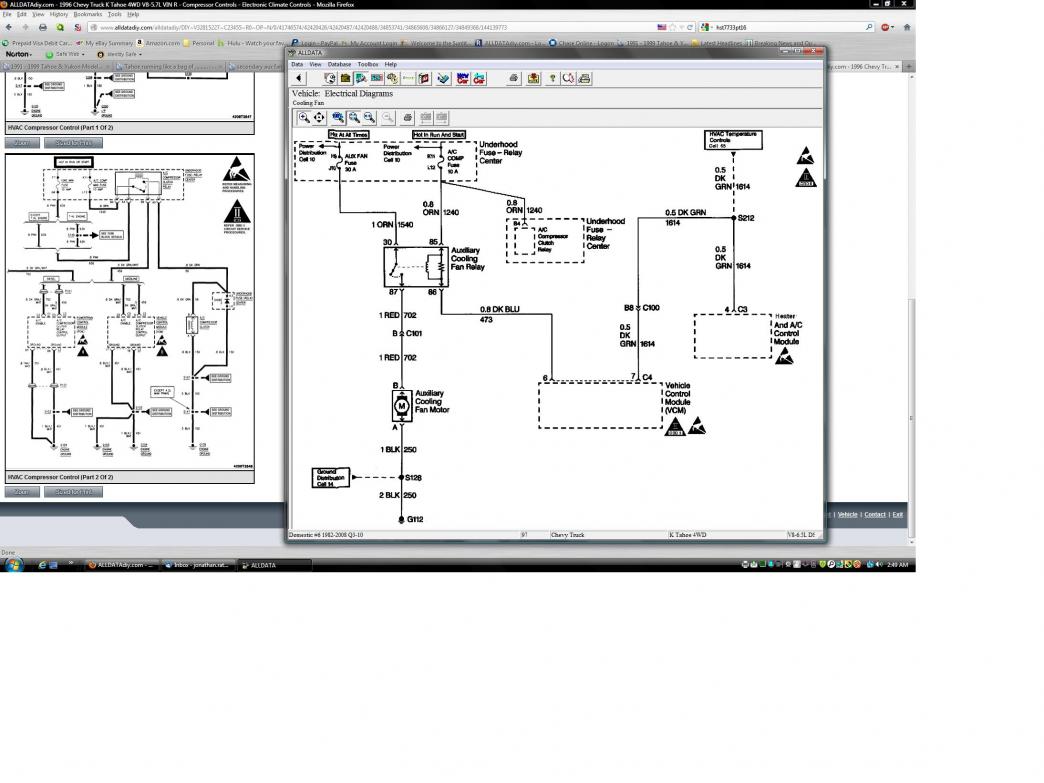

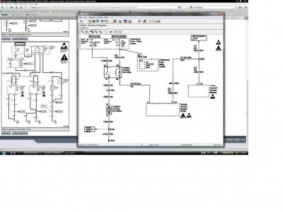

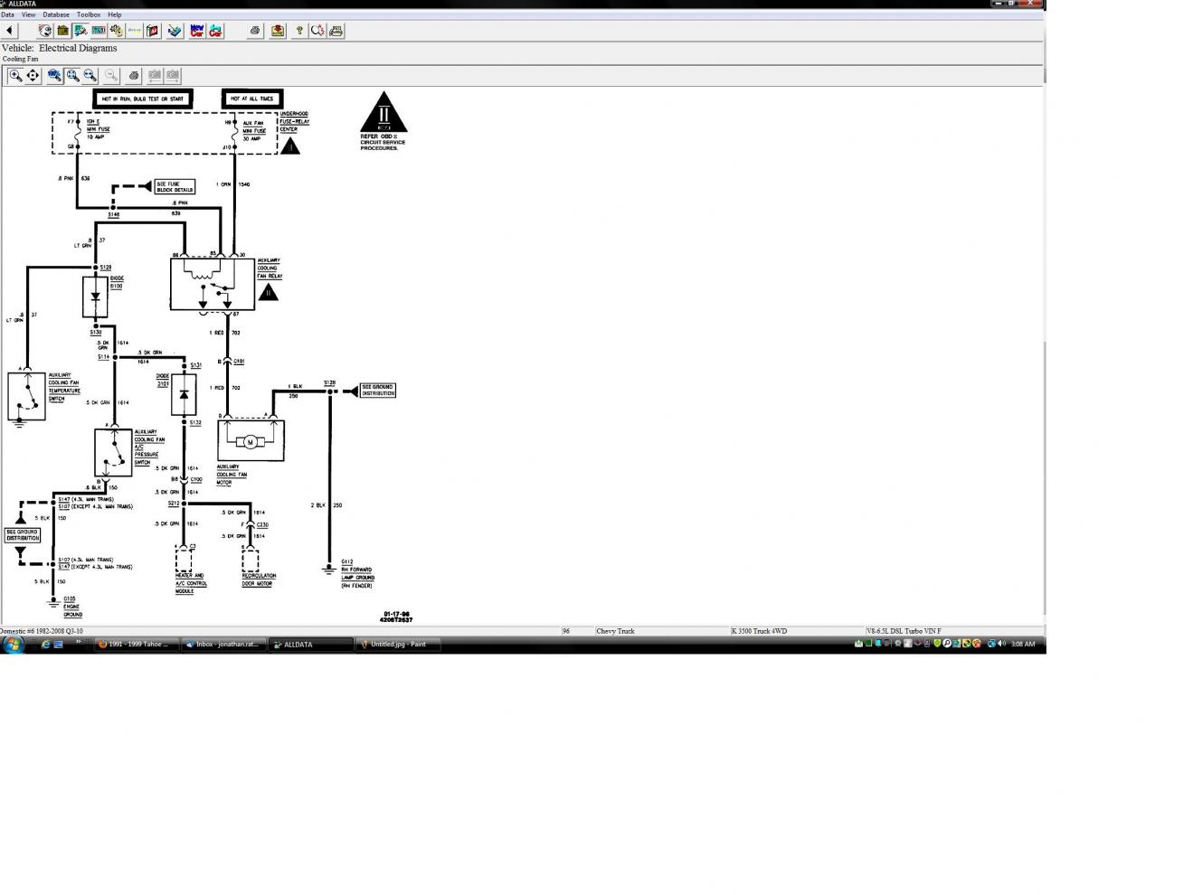

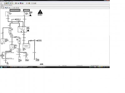

no problem wat parts do u need..? o yea i lost the low speed in the rear as well as the 2 low speeds up front... U told me how 2 take care of the front but wat do u suggest for the rear..?look for volts on dar blue wire on back of rear fan switch when in low speed. for starters. wants pics of diagrams again? could you read last ones i posted?
