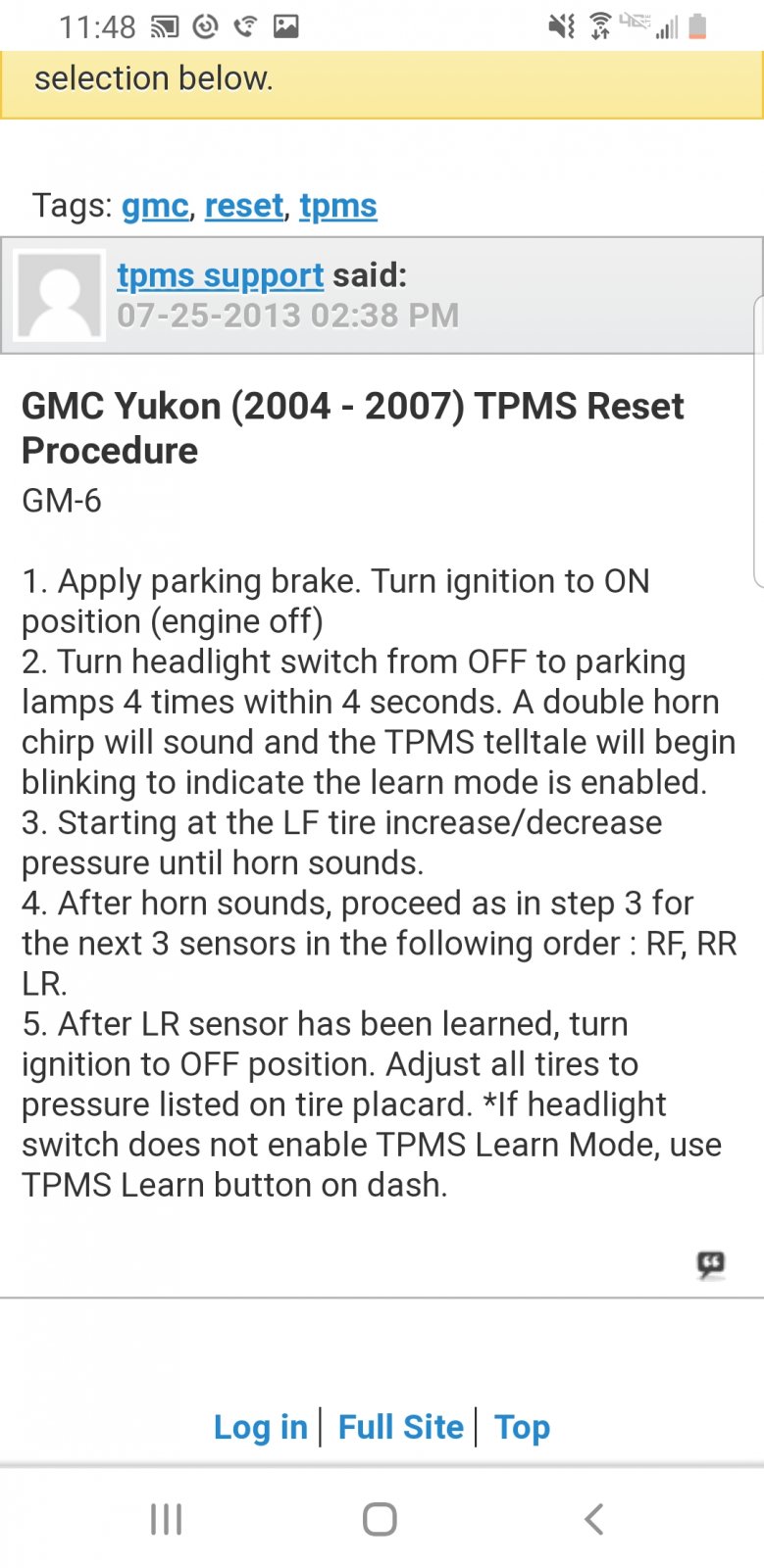

If the sensors are the proper sensors for your vehicle, I don’t see why you couldn’t swap them. You would just have to do the relearn procedure when you swap just like if you rotated tires.

I understand swapping the oem sensors into the second set of wheels will work no problem. But a second set of tpms into the new wheels along with the oem set. If I want to swap back and forth. I just don't want to have to program back and forth every time with a special tpms tool.

Ok interesting, so if this is what your talking about I guess it wouldn't be the end of the world do to this each time. Thanks man, that's cool you don't need a tool.
