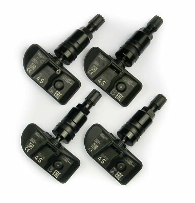

I managed to score the GM OEM TPMS from the dealer for around $40 each; used my GM Rewards points to pay. No issues on the learning by Discount Tire...or the dealer, I assume they used a learn tool, as mentioned above by @zbad55 in post #3.
Discount Tire said they had them too, but for $60 each.
GM P/N: 13542523 is the sensors.
Re-learn procedure listed in Owners Manual
The previous section on Tire Fill Alert looks interesting too..didn't know about that.

Of the vehicle or of the sensor?
Sensor should have it printed on it.
Vehicle by model year. GM used 315mhz up through mid 2019 then switched to 433mhz
Ok so both my 2021 Tahoe and 2022 Suburban use the 433 frequency?

I had a hell of a time with tpms. There is another post about this. From my understanding the 2022 yukon use a VIP tpms. I ordered mine from GM which are cheaper then after market sensors. Also bought the relearn tool on amazon for $15

I think they are trying to tell you that it is more than just Frequency for the new VIP architecture. Exactly what the "extra" is is unknonwn, but I do know that the Tahoes/Yukons/Suburbans/XL's and Escalades use a different P/N sensor than the trucks.
I bought the GM ones from dealer parts counter for $38 each, suggest you get yours from the dealer...no problems on my end...Discount Tire was easily able to install the OEM one's and learn them to my ride

433mhz is the frequency.
