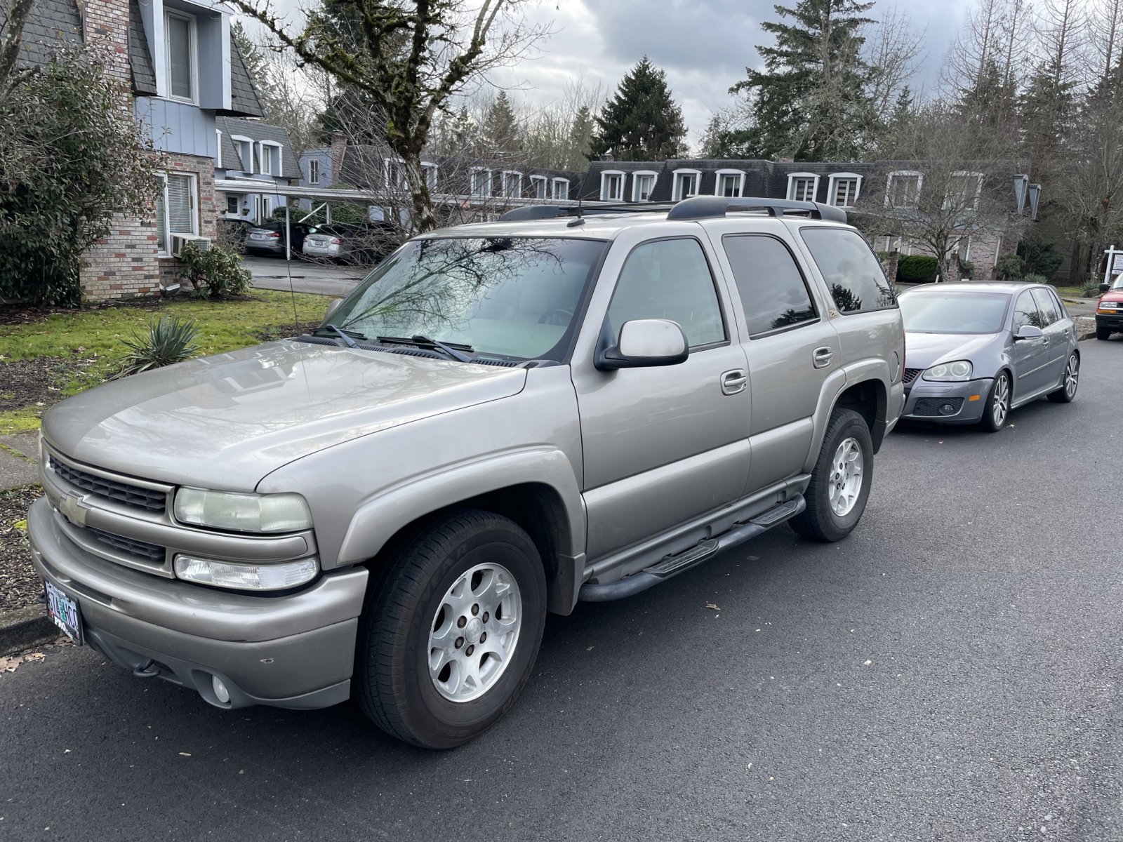

I’ve had the truck for a couple of weeks now and I guess it’s time to start doing stuff.
RyanPDX
RyanPDX
Feb 8, 2021
27
67
Truck as ~220k miles. Really great shape.

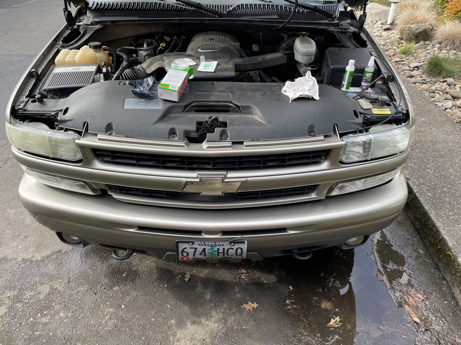

We took it a mechanic to get check s out and the only things he recommended was an oil change, coolant and PS fluid flush, serpentine belt change and ac mode door replacement, so we had him do it all just to have a good starting point.
I bought some led highs, lows, and interior lights, wiper blades, and a new drivers side mirror glass as mine is really yellow and hard to see out of which I will replace this weekend.

To get to a base: Change the brake fluid and both differentials and transfer case fluid. Do the trans filter and gasket and top off fluid. What does the original trans fluid look like?
The mirror glass can be tricky. There are some you tube videos to watch for the r&r steps. Apply tape to all the old and new glass surfaces.
When you do the belt(s), do the tensioners and the idler too and use AC Delco parts. You can use whatever quality belts you want.

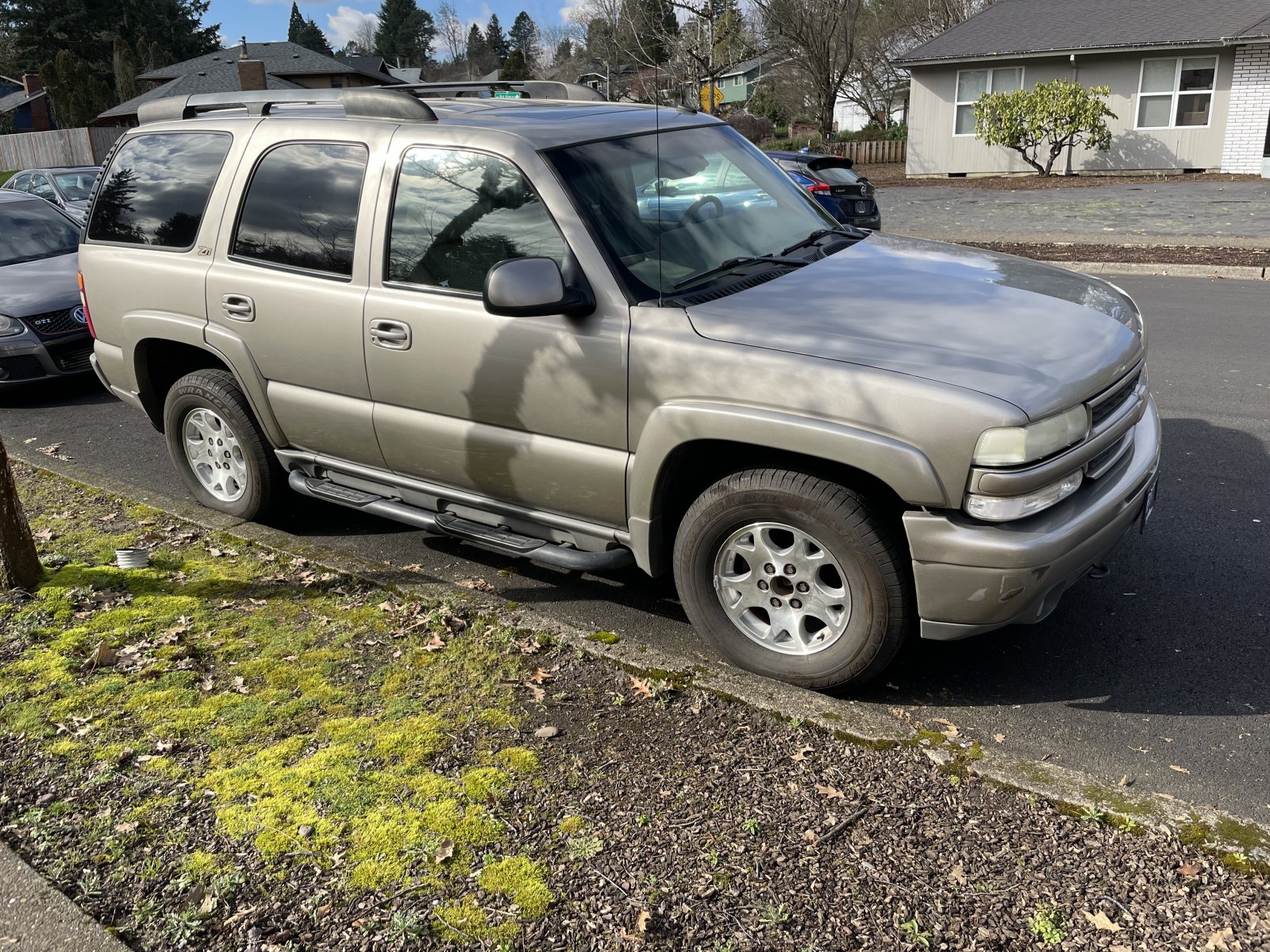

Looks like you are missing a center cap at the RF wheel. If you ever come to Eugene, let me know and I can give you one for free. I got all 4 new but have 3 good ones. PM me and I will give you contact info.
RyanPDX
RyanPDX
Feb 8, 2021
27
67
Thanks for the offer, that’s very kind of you. I appreciate it but I already bought some new ones.

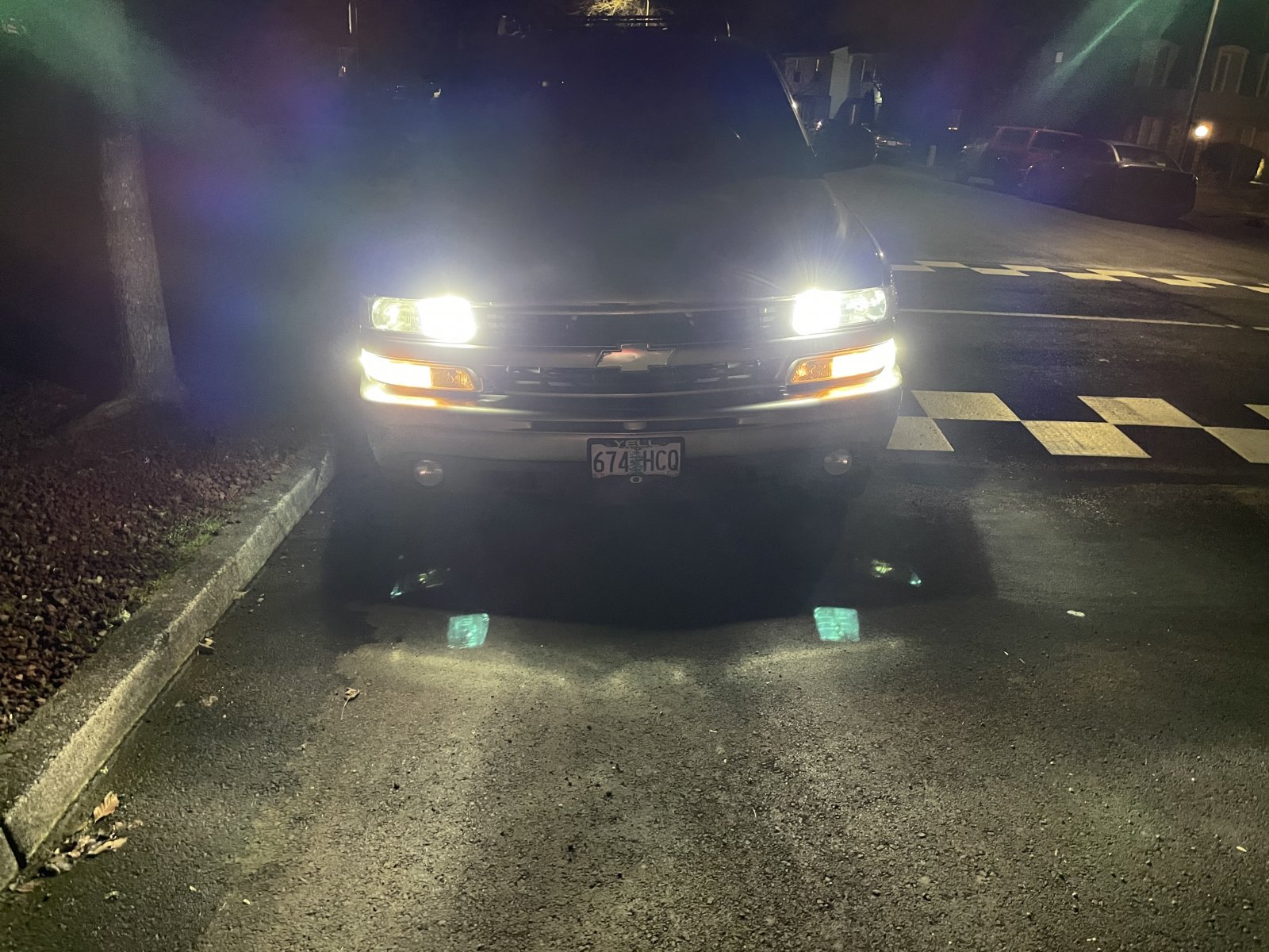

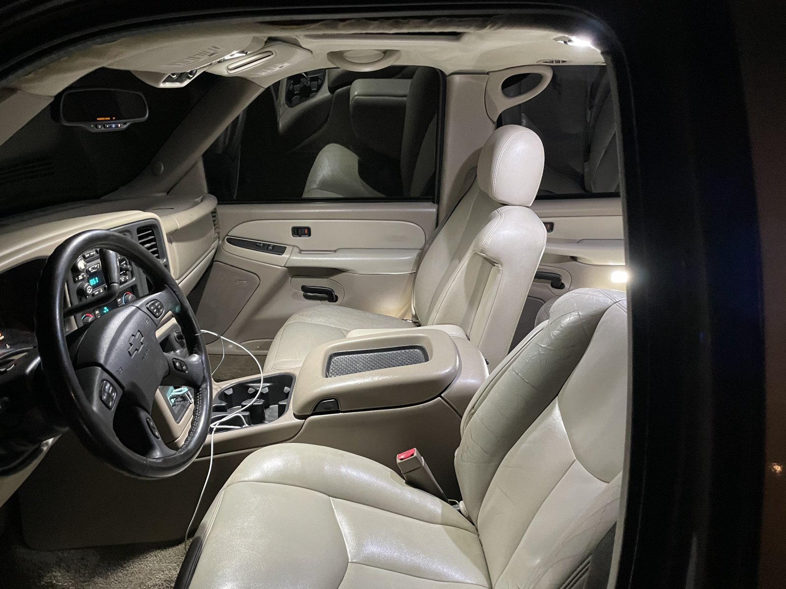

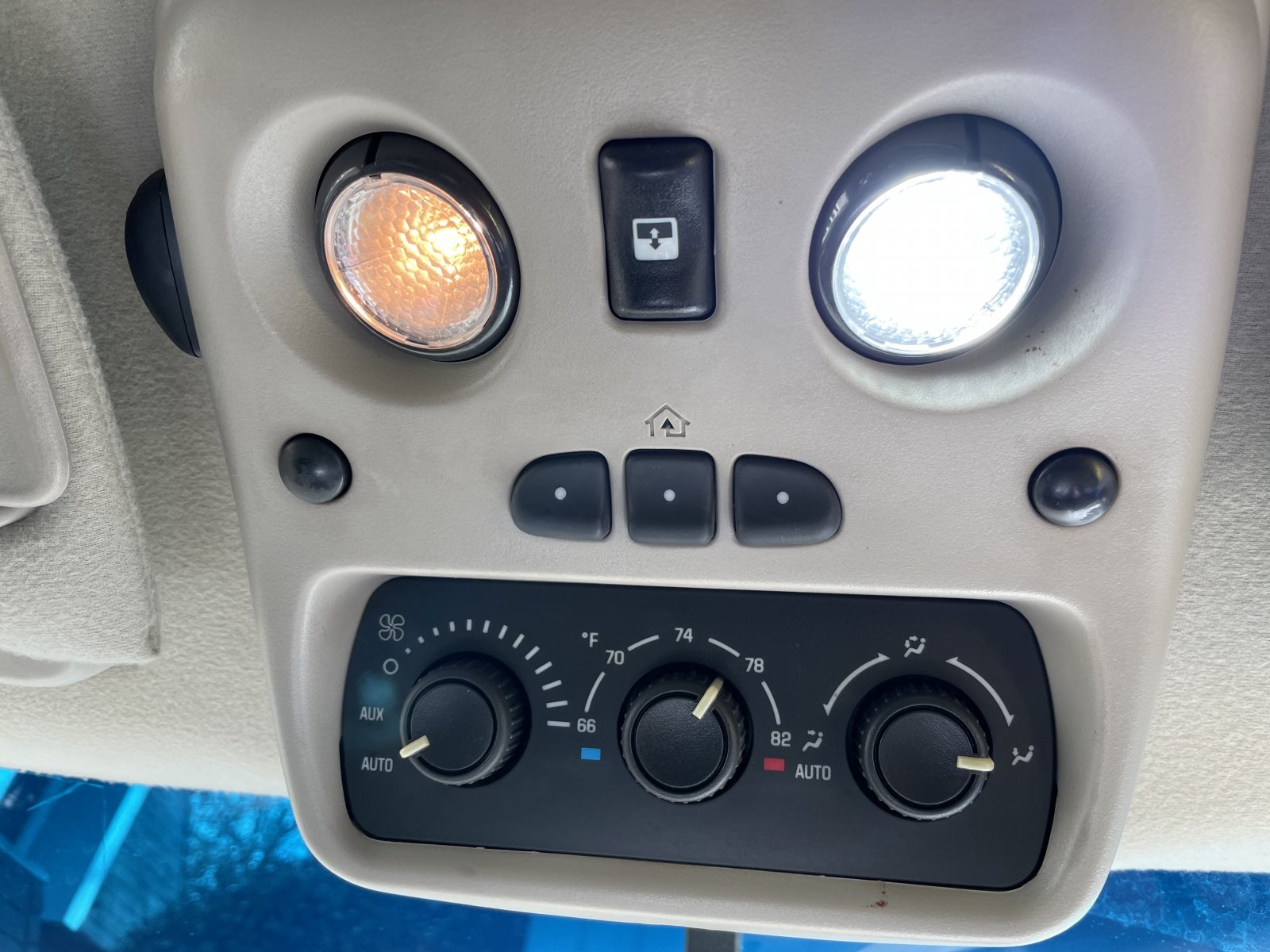

So over the weekend I got the headlights swapped for leds and did all the interior lighting as well.
also did a headlight restoration and I think it turned out pretty good. Here’s a comparison before and after.
Still plan on getting some different projectors in the future.
The LEDs make such a difference. Forgot to do a before and still need to do a complete alignment ( not blinding anyone but it needs a ring tune) but I’m super happy. Makes the whole car seem so much more modern.
I fought with the puddle lights the most. Messed with it for too long without getting anything to work including the old bulbs before giving up. Then I found out they only come on when it’s dark out. Live and learn!

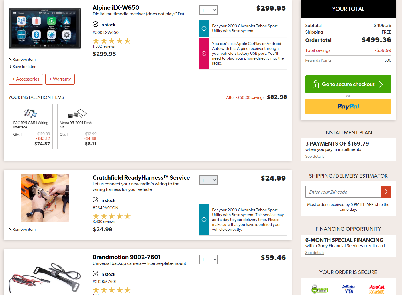

Stopped by 2 stereo shops today and they both want over $1k to put in a $300 carplay deck and a backup camera. I haven't installed a car stereo in over 20 years but for that price ima figure it out and get something from Crutchfield.
33,210
51,472
It's not hard at all. Just make sure you get the correct harnesses and chime box. Looks like you have Bose too. 1k to install a radio and backup cam is just being greedy imo.

This is what im looking at. I would prefer Pioneer but they don't seem to be instock. may skip the ready harnness thing but for $25 its seems worth it.
52,949
Yeah man I've definitely checked out your thread. You've done a lot of stuff I wanna do as well so its quite the inspiration. You will very likely be getting some DMs in the future lol.
Cam and Headers are for sure on the list but it will prolly be a little while till the budget clears up. I would love to do it myself but ive never really done engine work. My pops was an old school hot rodder but i was pretty young when he was into it and sadly he passed a couple years ago.
Also do you have any issues with Oregon DEQ with the mods you've done? do you have to flash the tune back to something stock before taking it in? Just curious because i may or may not have a catless VW GTI that i have to take to the shop and have them do some crap before taking it to DEQ.
I can walk you through the cam install when the time comes if you want. I hadn’t done any major engine work either since I was young (that’s a long time ago) before I did mine. It’s not bad at all, there’s a way to do a cam swap without pulling the heads. I’ve done it twice now. The hardest part was the dual valve springs, it’s kind of hard to line them up in the center as you compress them so the keepers can go on. It just takes patience.
I have zero problems with DEQ. I have small bullet cats but no post-cat O2 sensors, they’ve been tuned out. They don’t look underneath though so it wouldn’t matter if there were no cats. They just hook it up to the machine and there’s no codes so it passes. Here’s a link to the site I followed when I did my cams, check it out. It’s for an F-body but it doesn’t matter, it’s the same except for some of the accessories. https://www.ls1howto.com/index.php?article=23
52,949
If you haven’t done this in a long time it might be worth having them do the harness so you can just plug it in. I saw Crutchfield is out of every Pioneer. Weird, they’re available other places.
