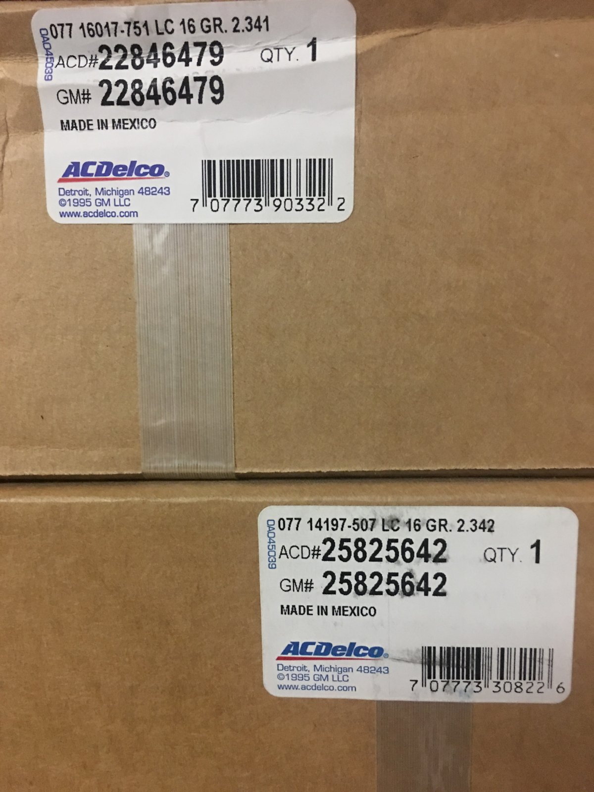

curious on how the rvc system is setup with the ppv's with dual battery's
does the ground from the 2nd battery run over to the passenger side and thru the sensor??
if so any pictures? or a ground wire part number?

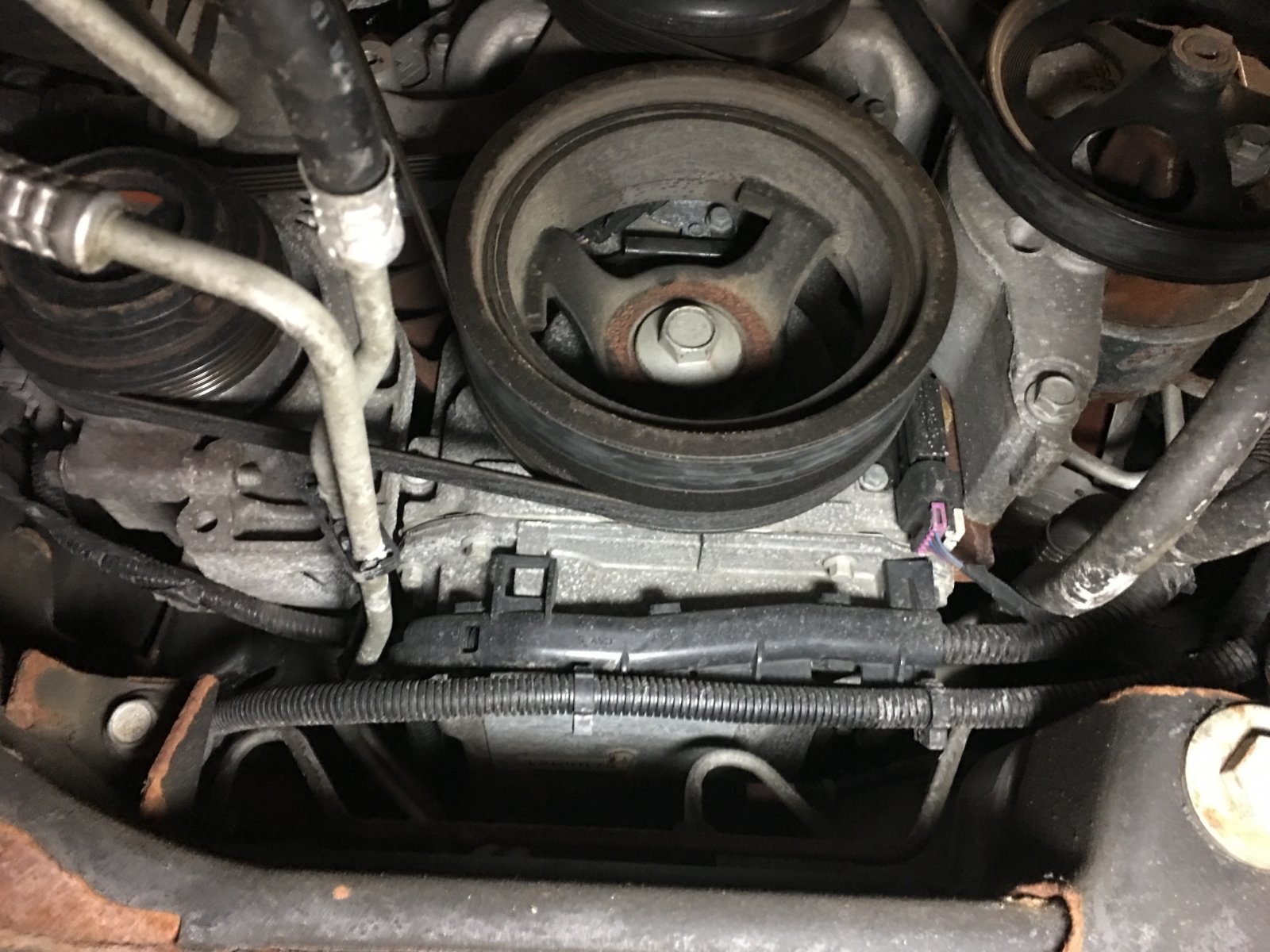

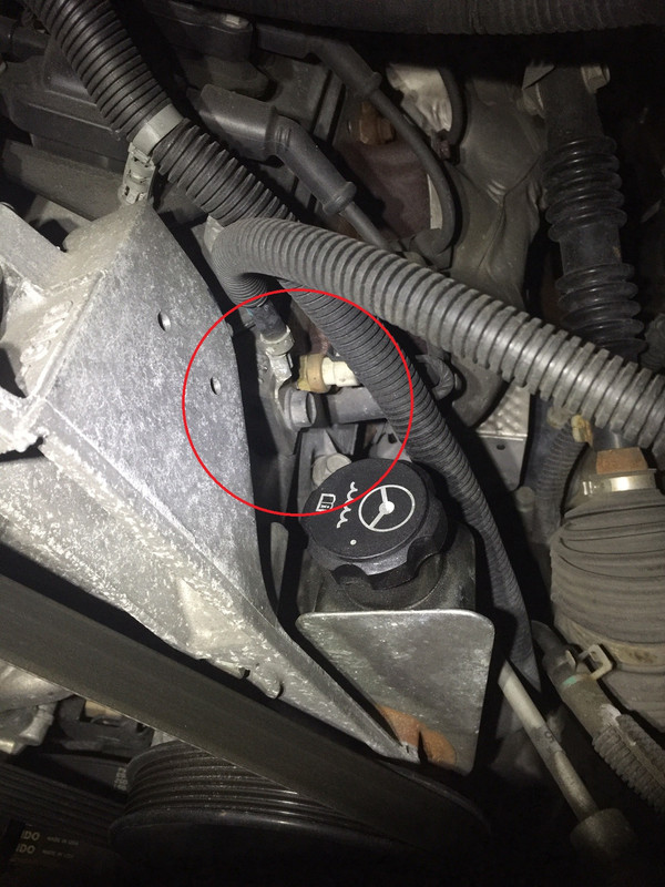

This is on a 2010 SSV. It goes straight from the negative terminal to the block.

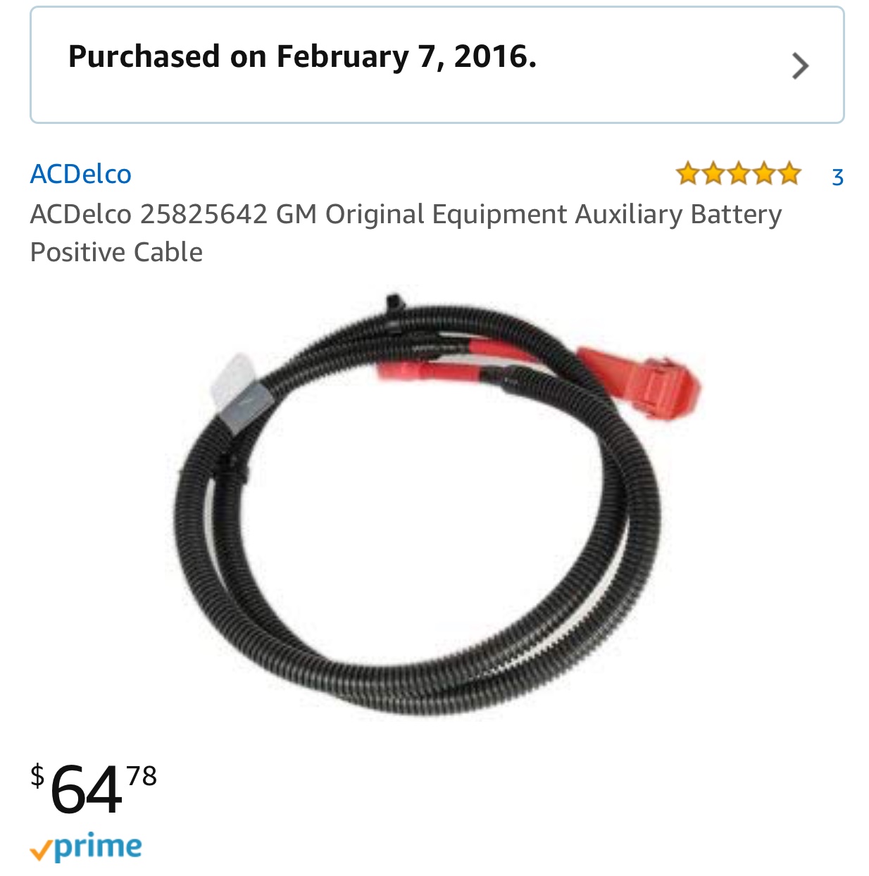

Just pulled the extra cables off of my 2013 PPV yesterday. Driver side battery negative cable direct to cylinder head, positive cable directly to starter terminal just as Galante has shown above.
