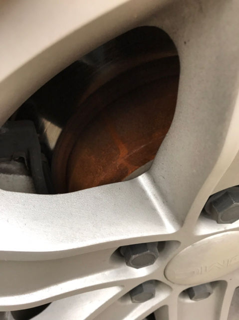

Will I damage the brakes if I take a wire brush and wd-40 to this?

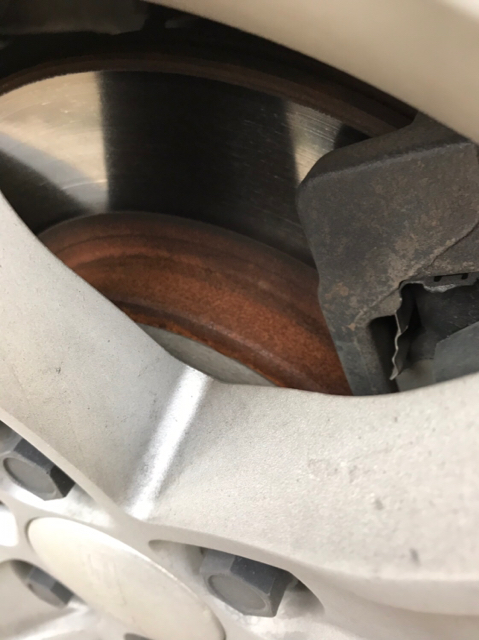

Nothing is making contact with it. Like Galante said, just make sure to watch where you spray (good advice for any facet of life). I do hate the way that looks on mine, too.

Id wire brush and follow up with some brake clean a few times then high heat black spray paint, even if you get some on the rotor surface a short trip will get rid of it pdq

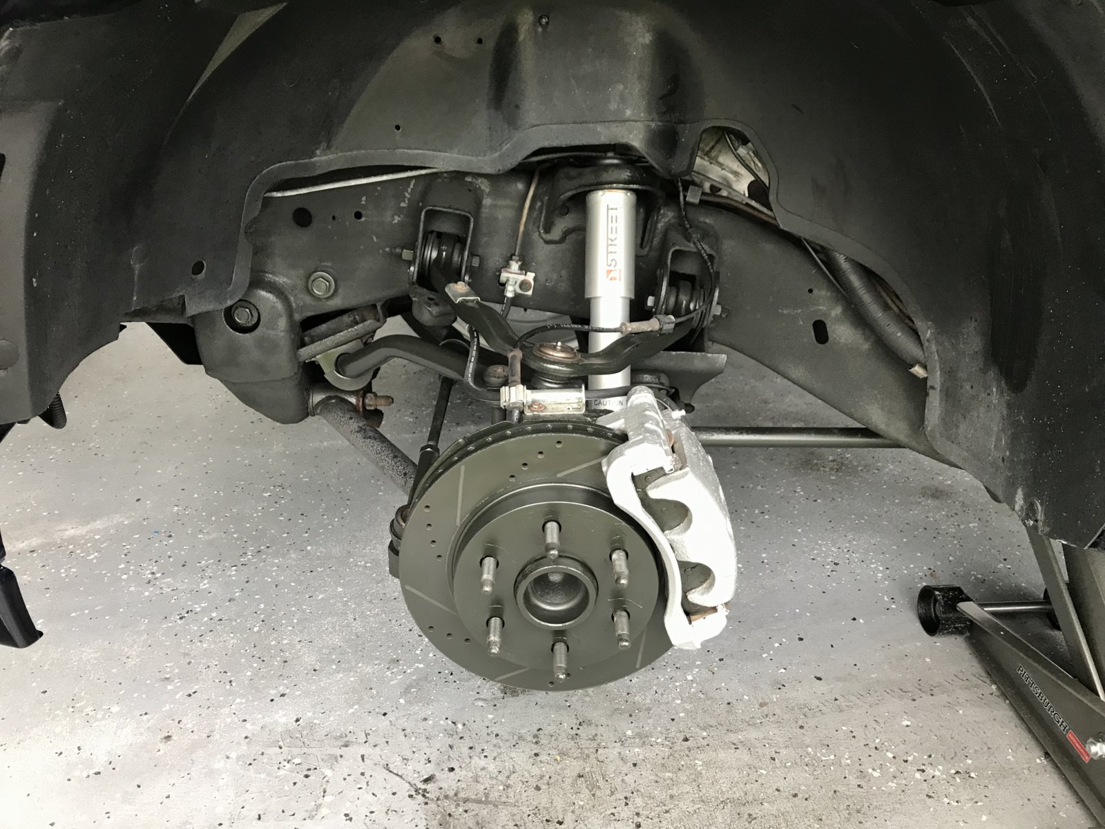

Cleans up so it looks like this. I used some Rust O Leum matte black this time around. I previously used some Rust O Leum high heat gloss black. Keeps it looking good behind the wheels.

Yes, you will damage it. Wd40 will mess up your pads. It's not a rust remover, it's a protectant (and a ****** one at that IMO). It'll wash/spin off in fast order anyway. If you're referencing that wikihow article that talked about doing this, I have a major beef with it. I'm of the opinion the writer should be charged with manslaughter.
Don't **** with it. That little bit of rust is normal and nothing to be concerned about. Only time it becomes a concern is if you have old brakes in a salted area and you see rust flakes coming off your rotors.
