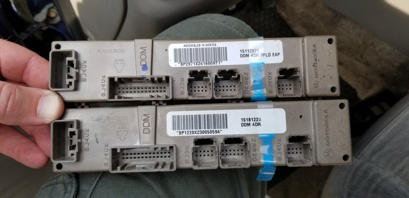

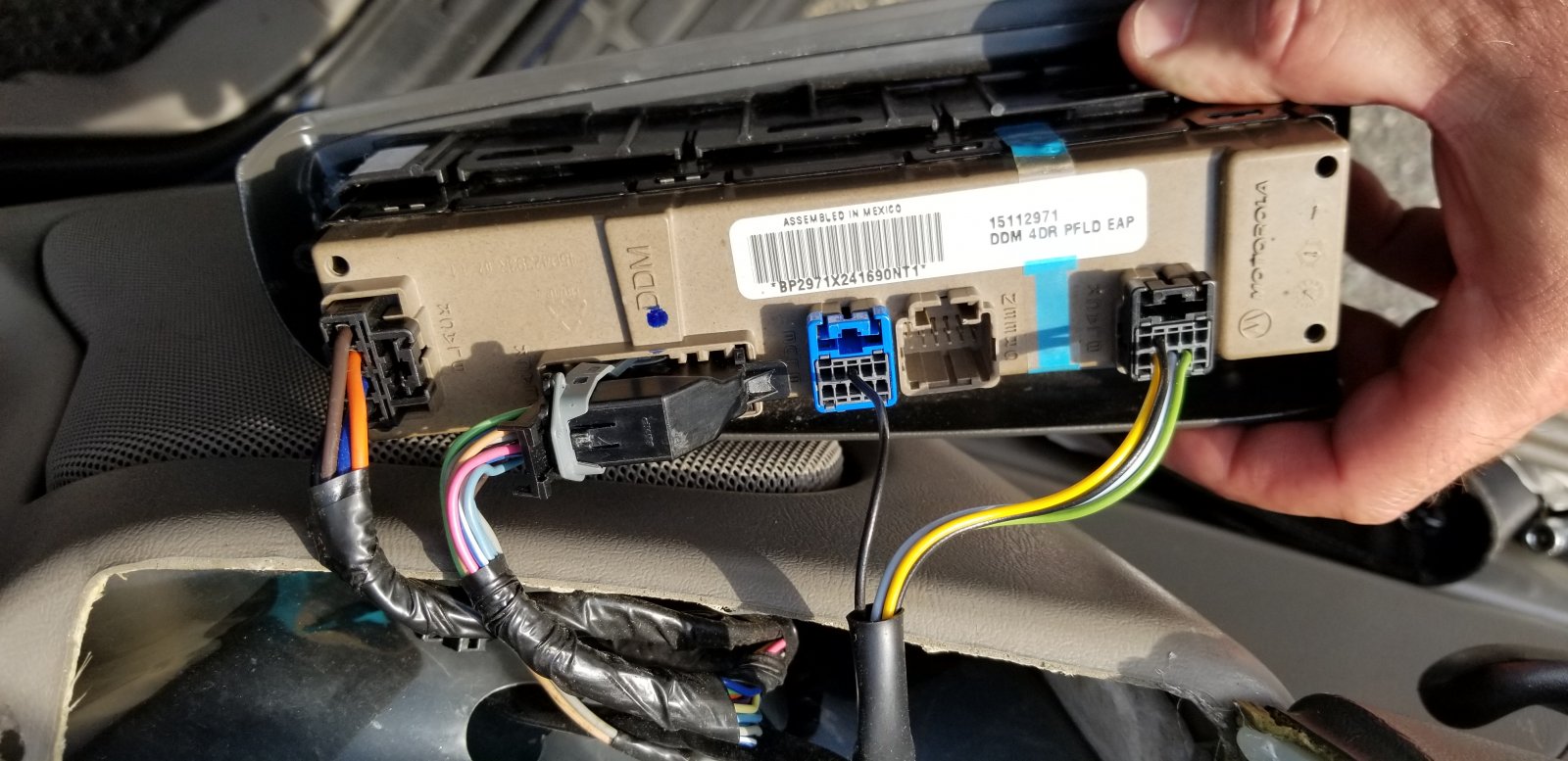

I just found this pic:
Def one of these plugs tho:
