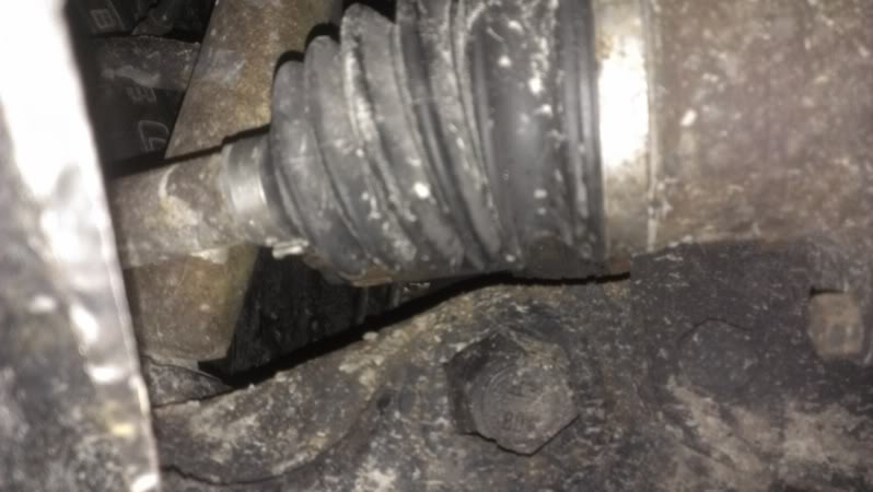

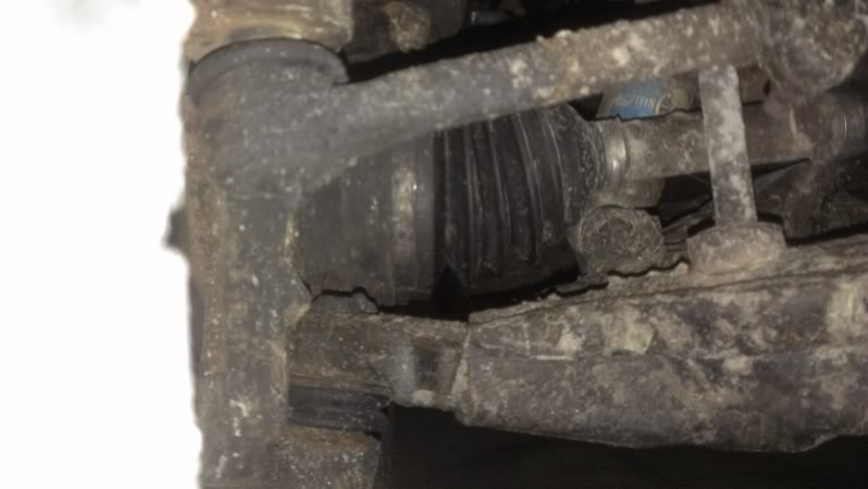

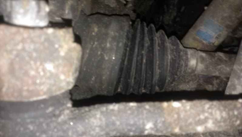

Your correct they do nothing. As long as you have less than 3 boot ripples touching your ok. can we get a picture of the angles you currently sit at

angles as requested. this is from the passenger side, driver side is identical. sorry its so dirty i was offroad yesterday and havent cleaned it yet
