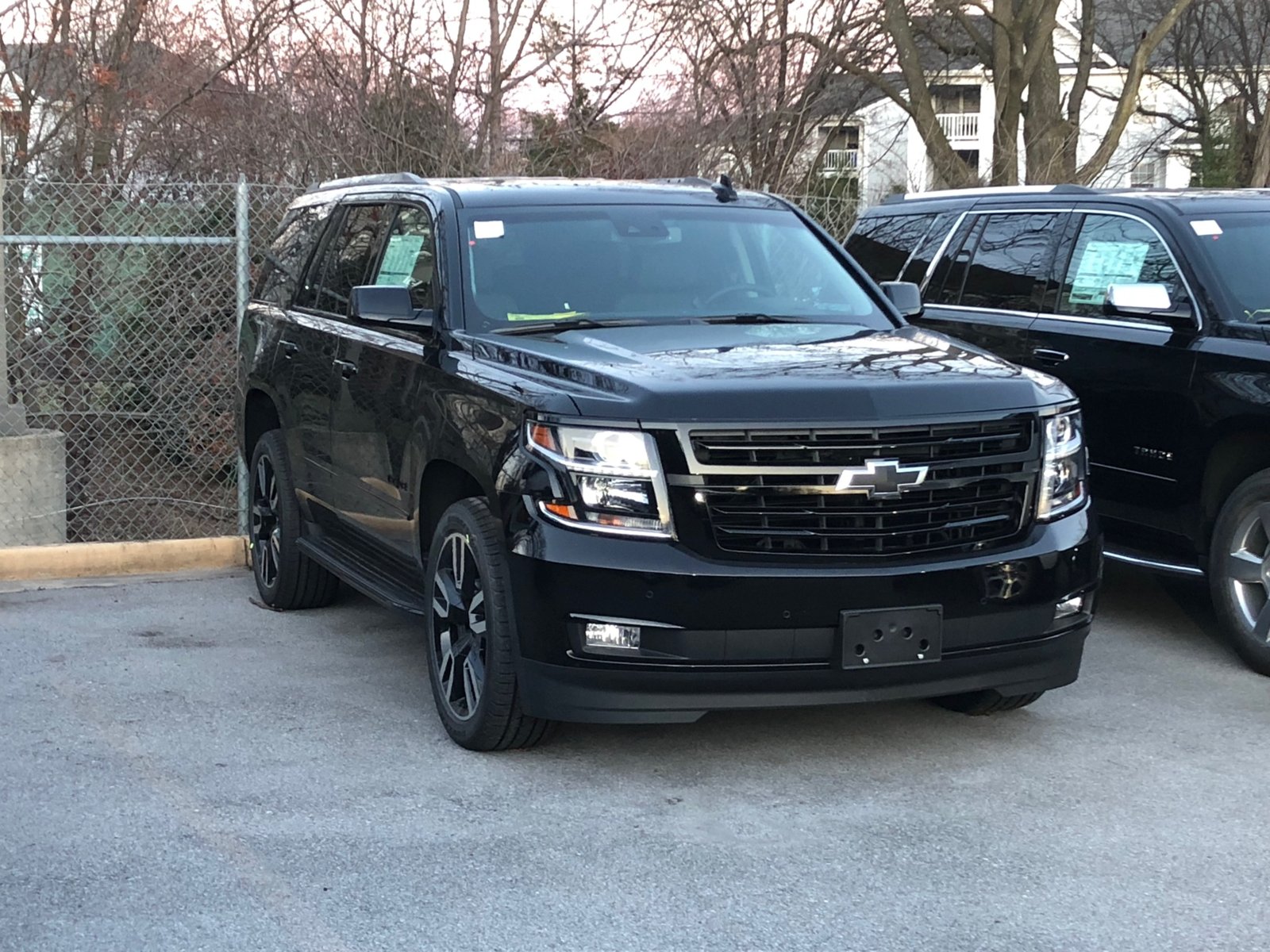

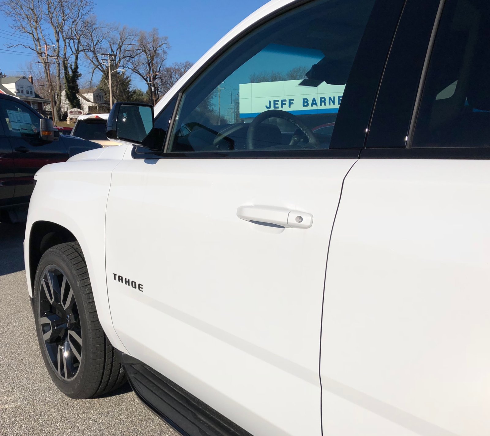

I have been thinking about going the vinyl wrap route a lot lately. Also want the cargo rails done.
Heres a couple shots I got from 2different dealers near me on recent visits.
56A820DE-801E-4281-934B-8A8953E04F1E.jpeg 68CDEA07-13A1-4778-905A-9FA4CE0984D4.jpeg 60C3EEC1-59C5-401E-B5CB-D5F8AB6DE9DA.jpeg
