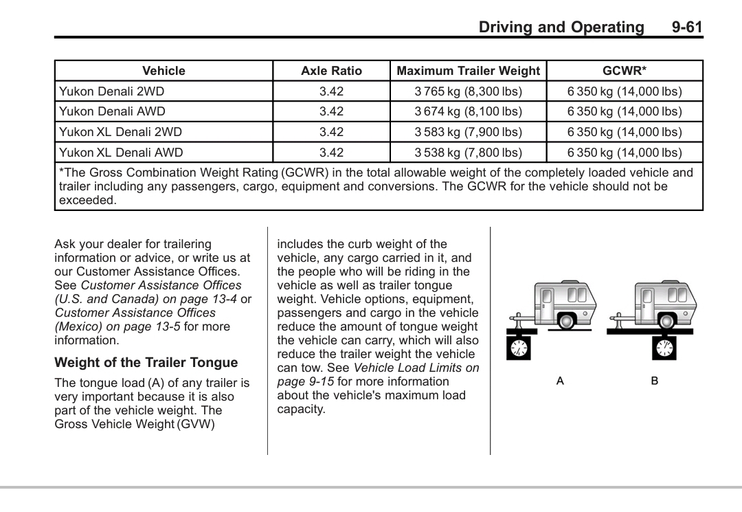

I don't think the GCWR matters what towing or cooling options it has. On my 2012 Denali, it only depends on if it's 2wd or AWD, because of the added weight of the front driveline. Some have the K5L RPO and some don't, mine doesn't.
