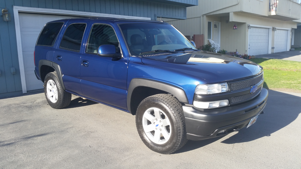

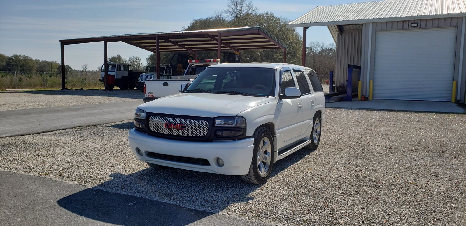

I took my rack off and just put the stock bolts back in the holes. I did that just to keep debris out of them. With the stock bolts, just the heads are visible--not a biggie imo. You could always get bolts with flat heads instead of the stock rounded heads.

Hell yeah that looks sweet, can’t even see the bolts. I can’t wait to do mine now, looks a lot cleaner

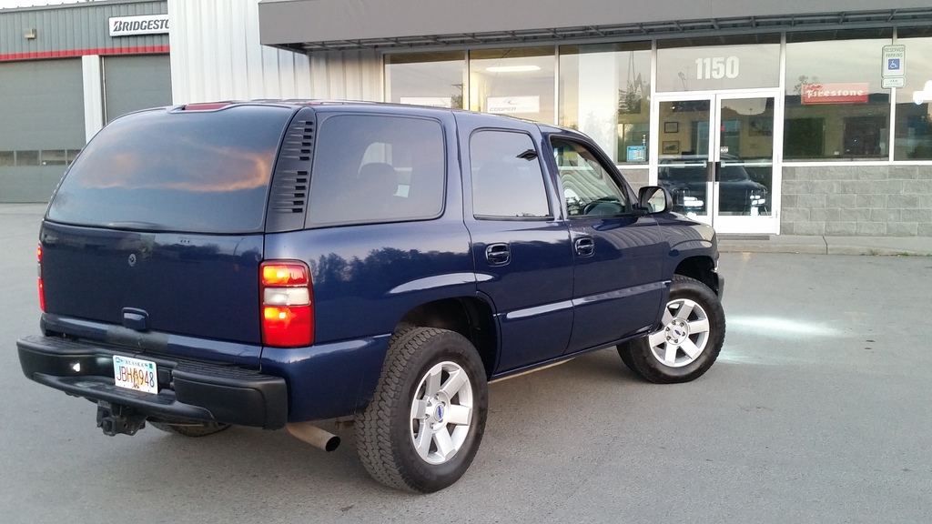

I removed mine screwed the screws back in an a body shop friend of mine sealed them with something like a seam dealer.not a great pic kinda far away but I love the look

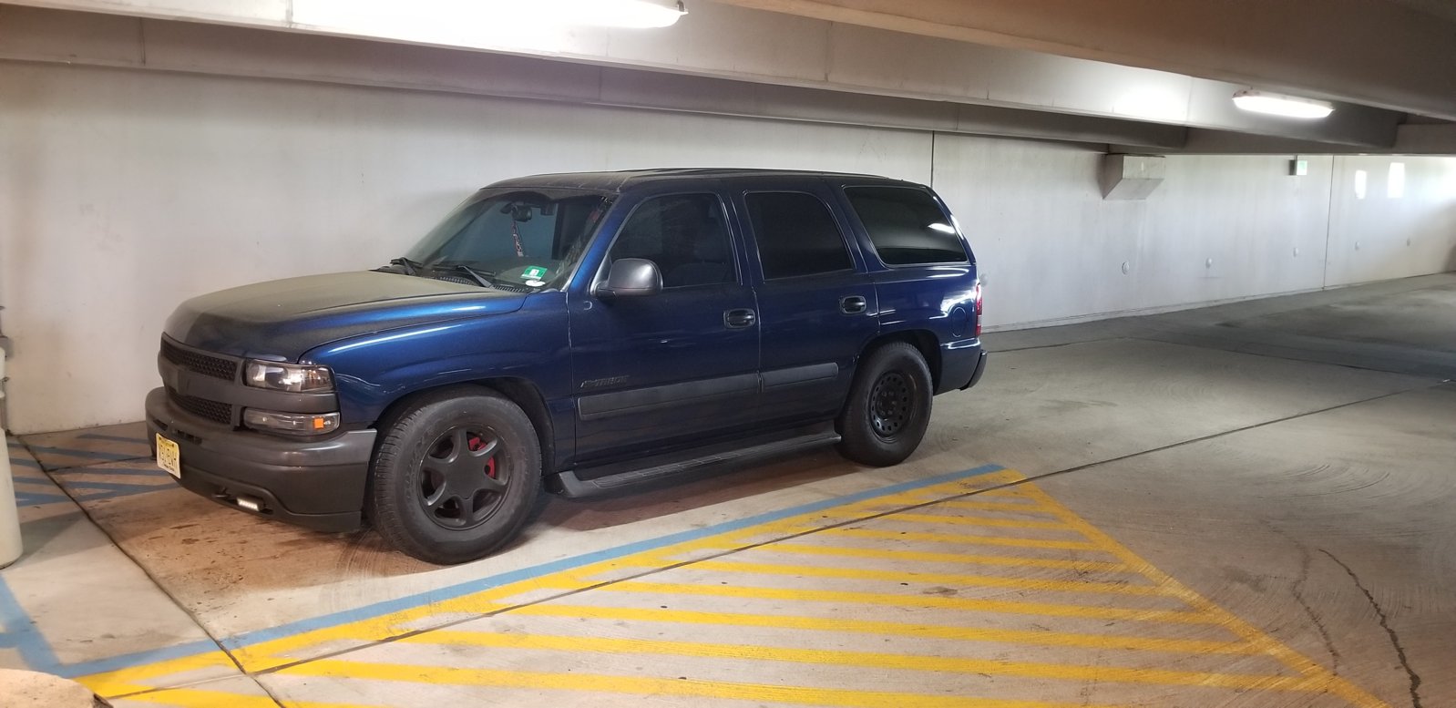

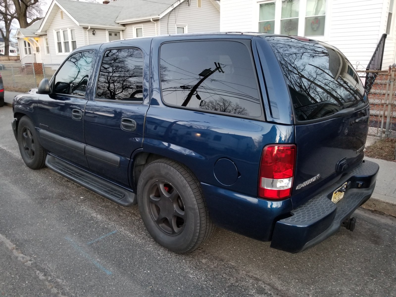

Took mine off . Just filled the holes with oem bolts and that was it. Much cleaner look View attachment 216132View attachment 216133
That thing looks amazing! Is there anyway to see what the bolts look like exposed? I wanna do this to my z71, Also deflared it looks so much cleaner, and they look even cleaner debadged. I might have to do those things, Love your truck though so clean.

Thanks , miss that look sometimes. Those are Nissan Titan stock 18” wheels. Bolt heads exposed just look like exposed bolt heads lol. I don’t have any pics up close I don’t think. I can try and look, but you can barely see the bolts in the pics I posted above

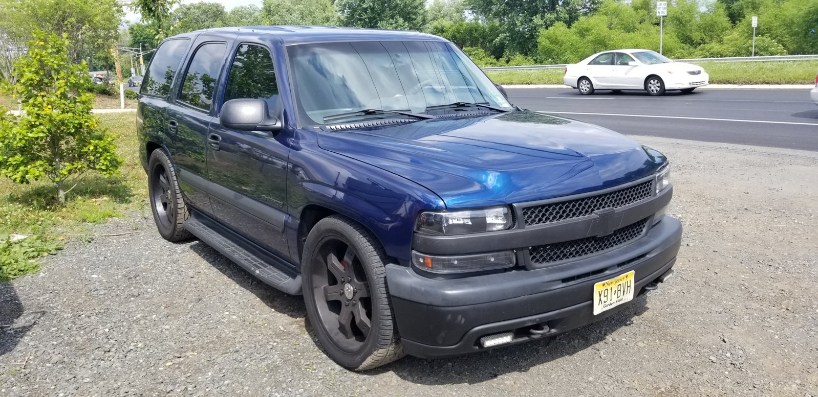

I just removed the roof rack on my 2000 Yukon and put the same bolts back in with a little sealer on them. I would like to replace them with shorter stainless ones, Anyone know the size threads?
