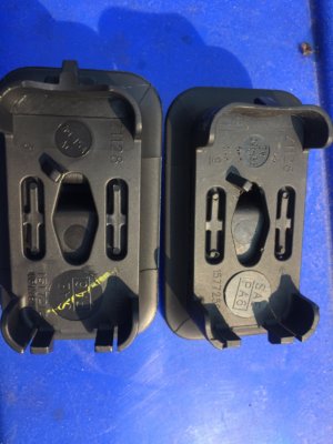

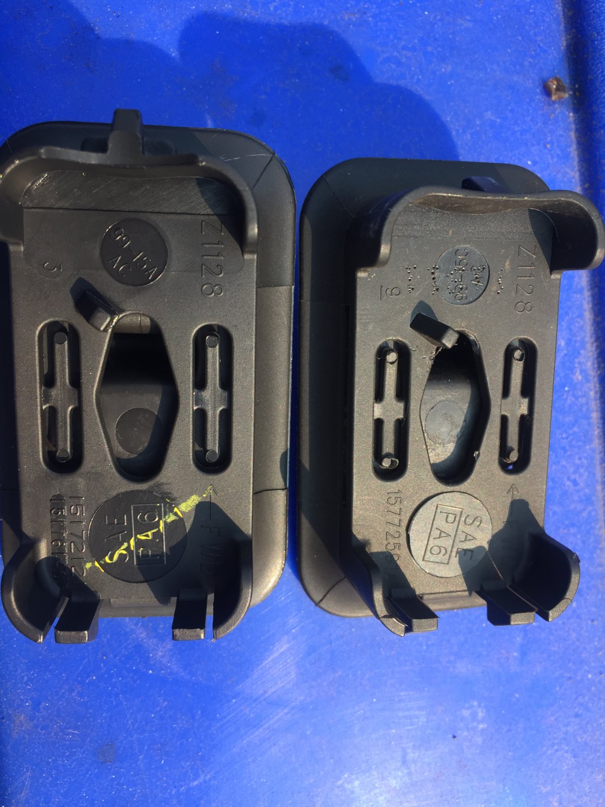

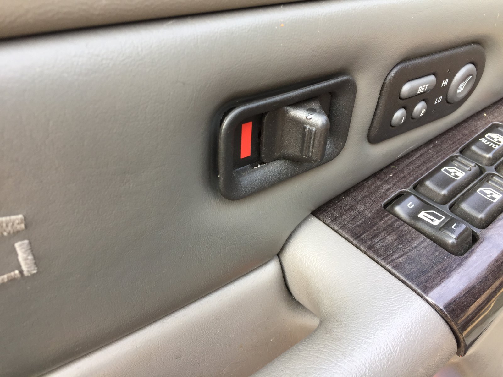

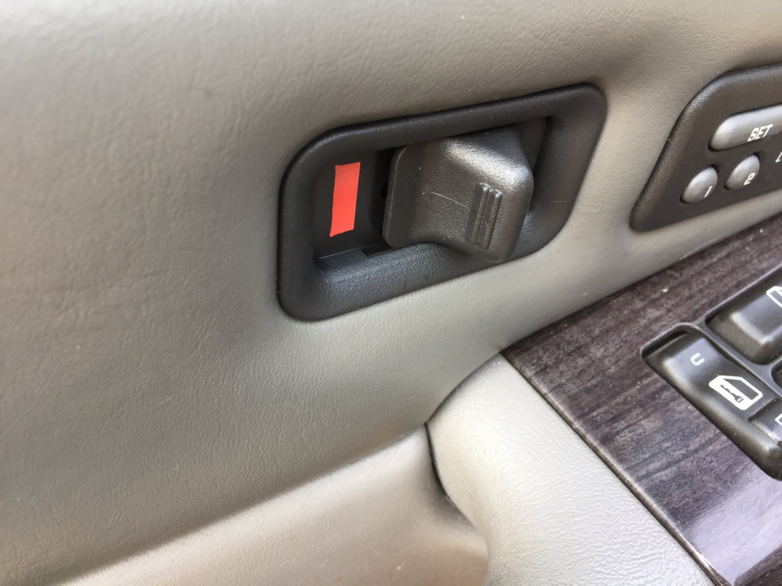

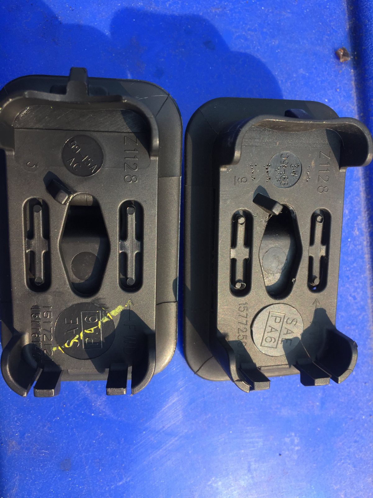

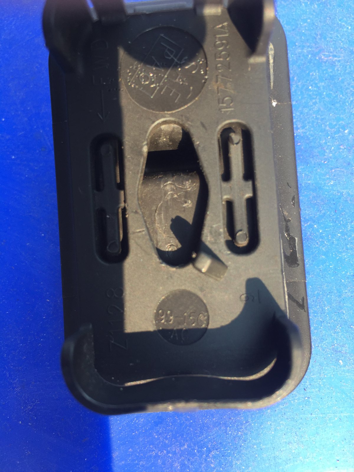

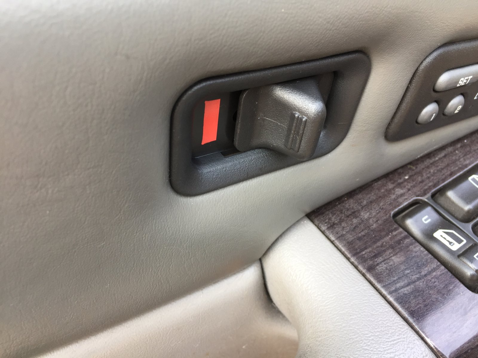

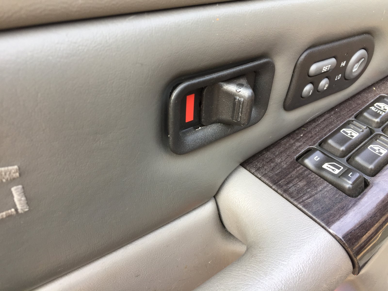

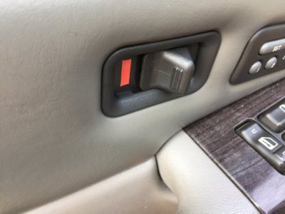

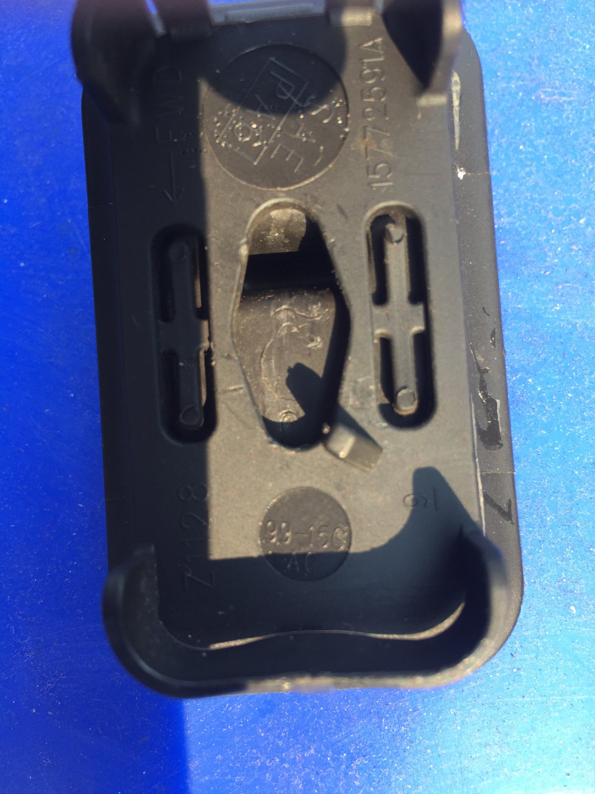

Today I got the new and improved front manual door lock bezels. It's the little things sometimes that make me happy. It always bugged me that they would constantly pop off and look like crap, it made it look like my door panels were falling apart. Not sure what year they incorporated these into the trucks but they sure work better. If you look at the 2 different parts next to each other you'll see they made one of the prongs longer so it would hook behind the panel and then the other ones snap in. It works way better. The old ones were even curved in where the clip was, making it worthless.
View attachment 180866 View attachment 180867 View attachment 180868 View attachment 180869
Any certain years that had these issues?
